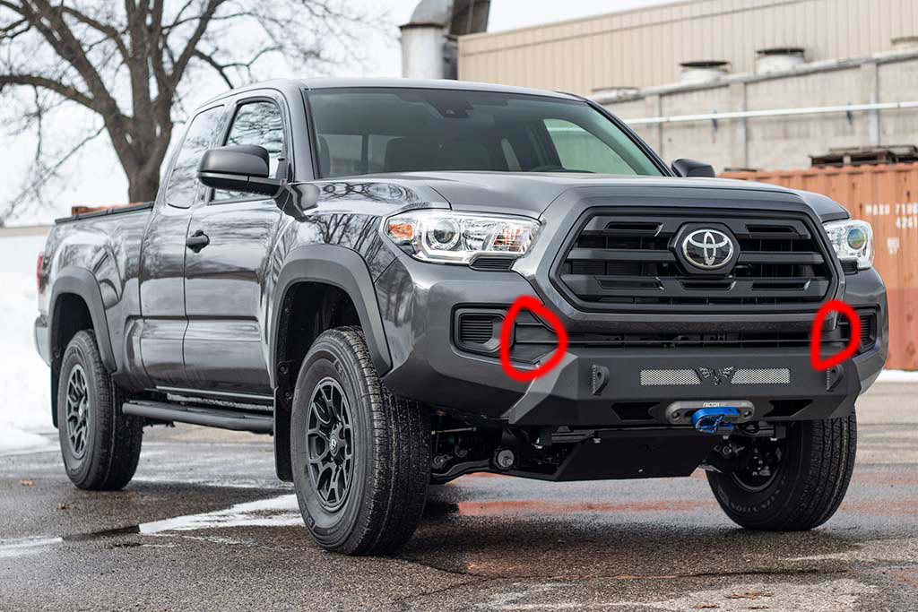

    Does anyone have any info/ideals on how or where to mount surface LEDs in the grill and or towards the rear

    You can mount Whelen lin3 lin4 and linz6 in the small area below the turn signals, for the back side you can do brackets off of the bed rails to light to the side and the rear. I have also used Dominator bars and Lin4 under the tailgate. They are hidden but are visible when illuminated. If you dont mind going in on the mirrors, you can add an intersection light below the mirror housings.

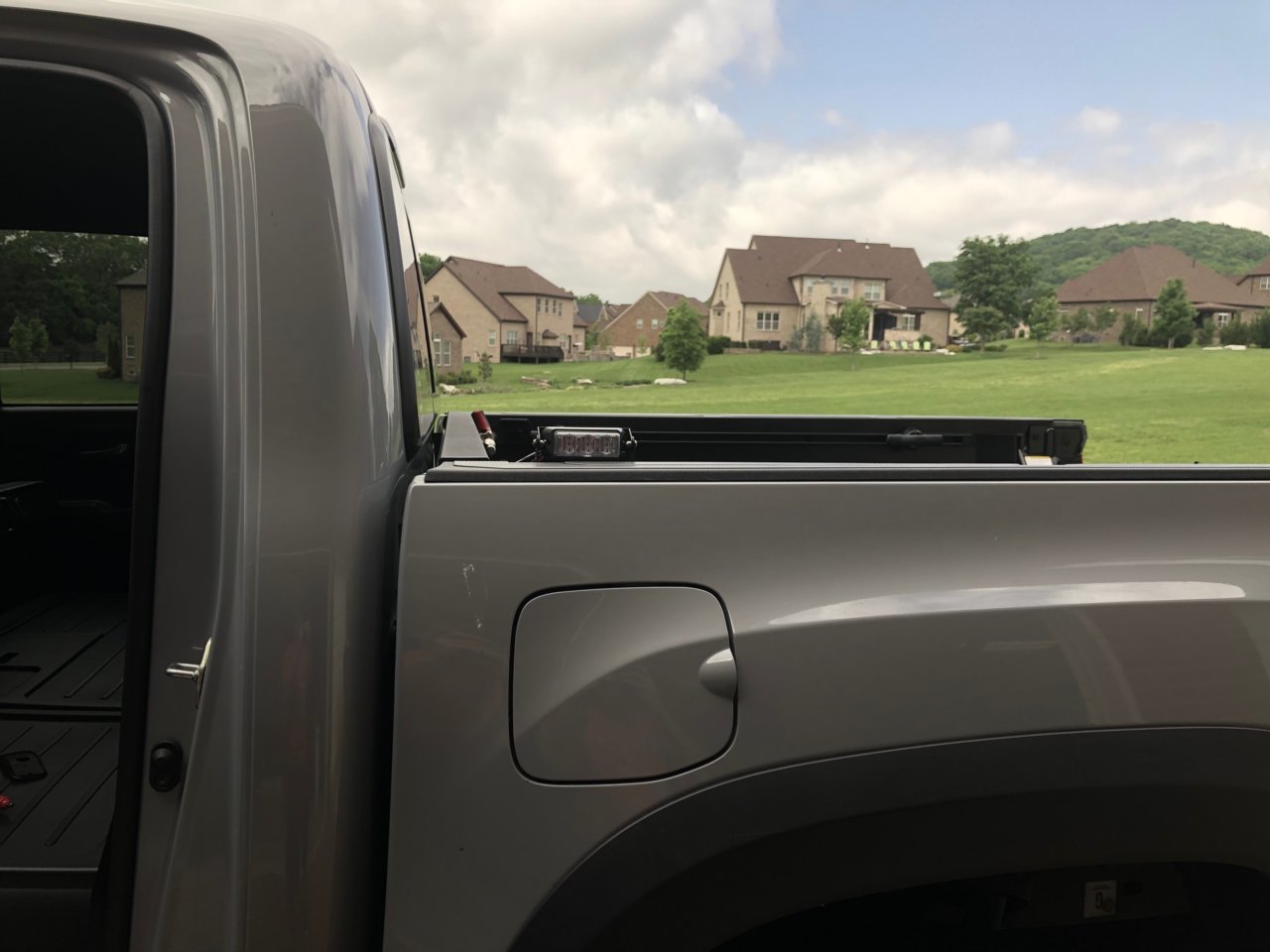

    A couple of the bed rail cb antenna mounts and some pivot brackets for the tir3 and you can do this

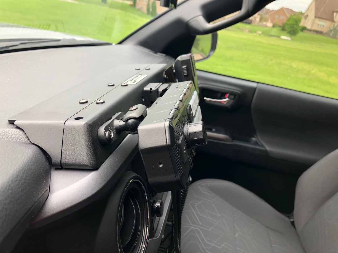

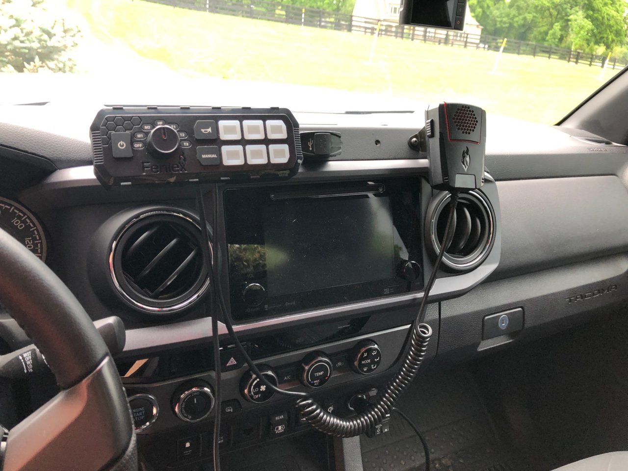

    Another good way to mount a controller without taking up console space is the Expedition Essentials accessory mount. It works pretty easily if your controller is small enough and accepts a ram mount, other methods may require modification to a mount to make it work like I had to. I had to widen the holes on the mount that attached to the accessory mount though and haven't repainted it yet.

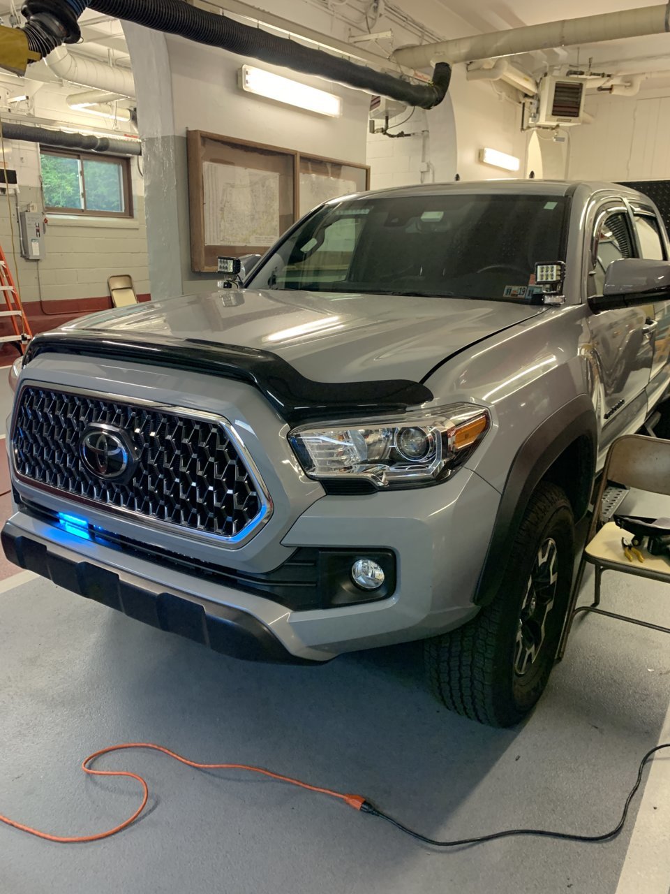

    Bottom bar is from strobes n more
    And so are the lights at the bottom of the a post and they are super bright

    I have the truduel 8500 it’s a little over 2 feet long and I put the optional side lights in the top corners of the grill

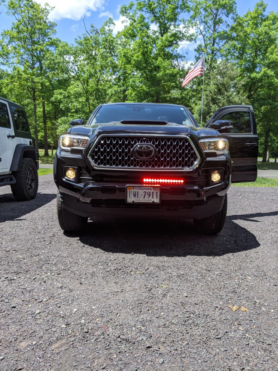

    I'm going to try out a LED outfitters chameleon. Single row. Doesn't fill the entire chin vent.

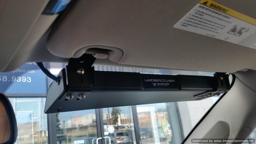

    In your case If you dont want a top lightbar, Id recommend some visor lights (They attach to the visor brackets and run across the whole windshield). Those are also non-permanent and you can remove them without any holes if you ever sell the truck. Everything else will likely require some drilling/ bolting. Like this

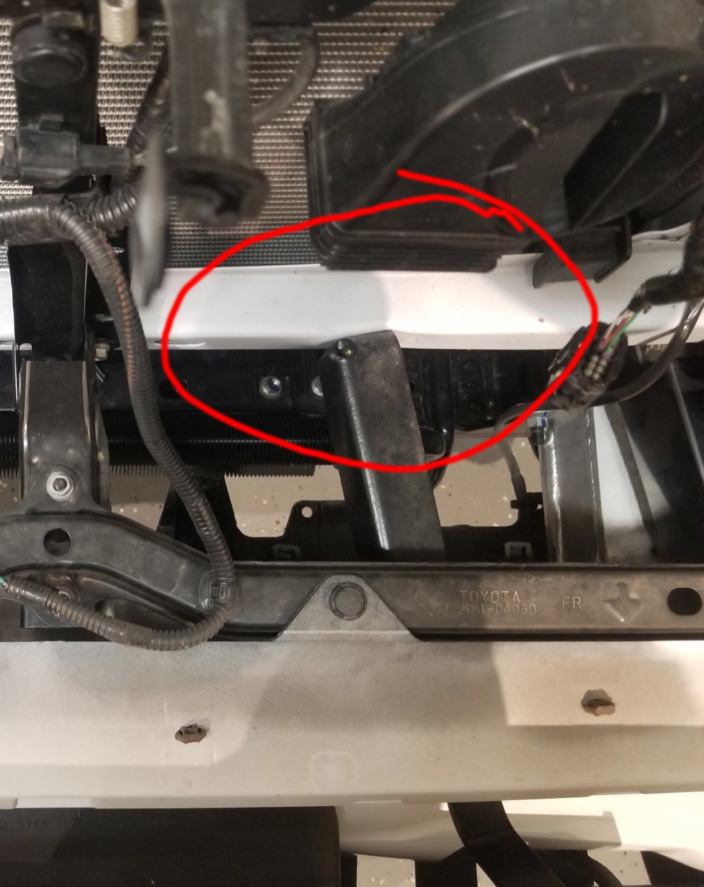

    Get a Whelen headlight wigwag flasher to flash the highbeams and consider installing some Hideaways in the turn signal areas as in my video above. You may be able to install some grille lights behind the grill using some custom bent brackets (a vice an some flatbar from home depot can get it done) but visibility might be hindered due to the grille design. And as someone above showed, the smaller grille on the bottom bumper is a good spot too. They make little U-brackets that attach to the underside of the hood right by the windshield area. You can mount surface strobes to them and are super low profile. Forget who makes them.
    Also you may be able to fit some Whelen Micron surface mounts on this fascia area on the bumper although not certain on the exact size.

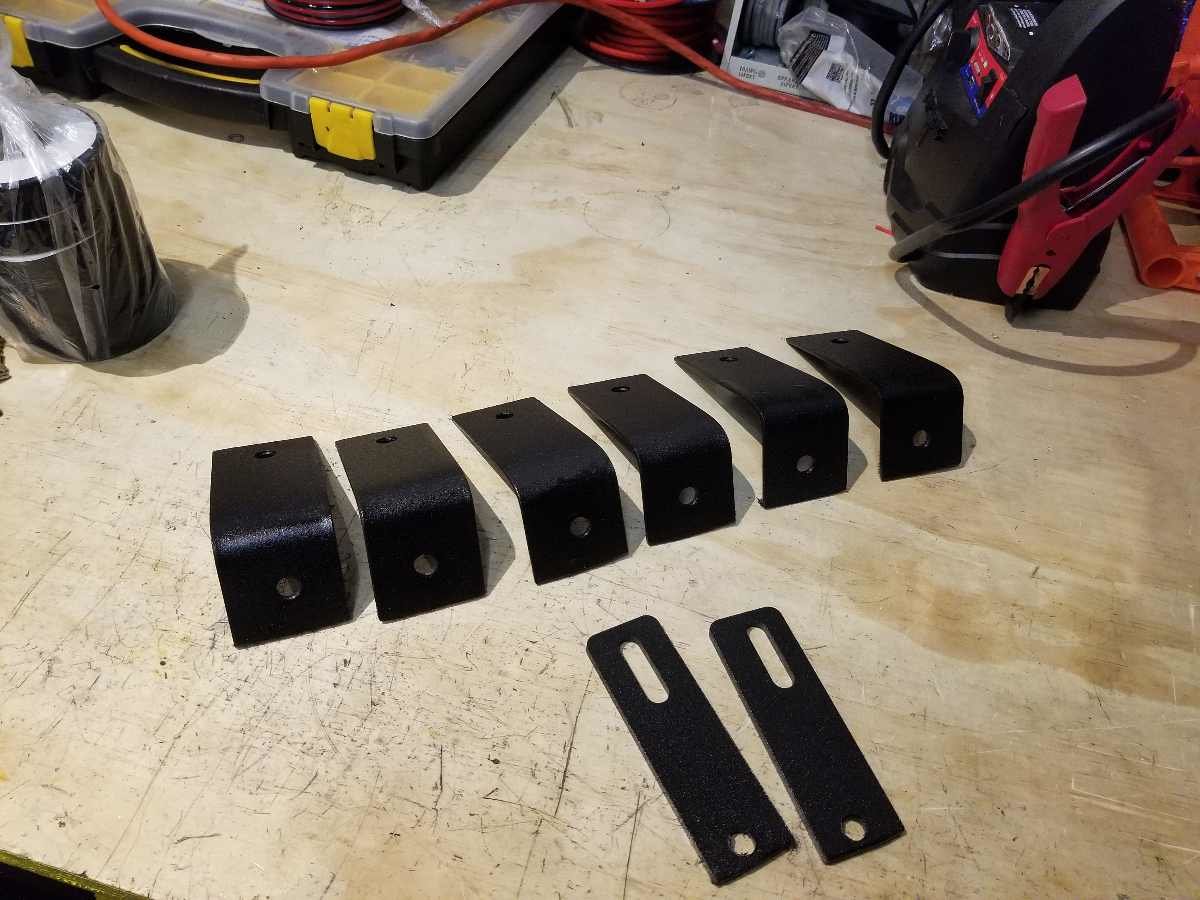

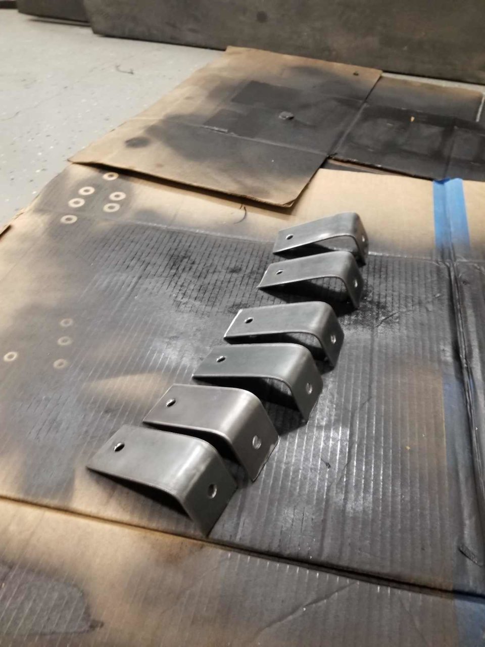

    For the rear bedsides, You can install some flatbar brackets to attach to the bed rail and mount some surface LED strobes similar to the ones I've made here. They mount to some T bolts that you slide into the rail.

    If you need to mount a PA speaker, the middle support behind the grille is a good spot for it provided you get a flat 100w speaker. Ignore the bent bracket. Some idiot already ran into something and bent the center support Screenshot_20210625-132727_Gallery.jpg

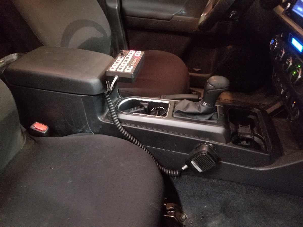

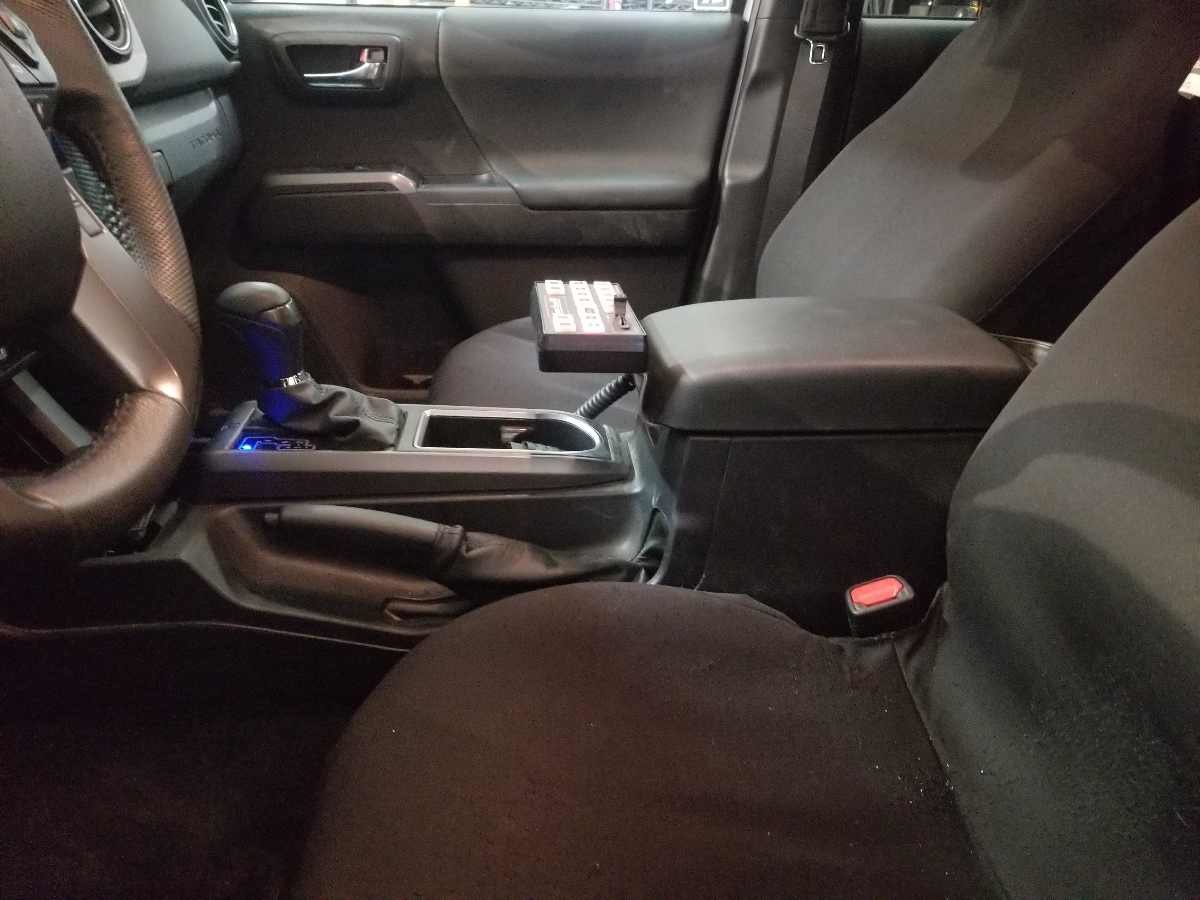

    The control box was mounted inside the center console with the switchbox mounted on some brackets that attached to the underside of the console lid. I used a fuseblock along with the chargeguard CG12 to control timer functions after you turn the truck off so it doesnt drain your battery.
