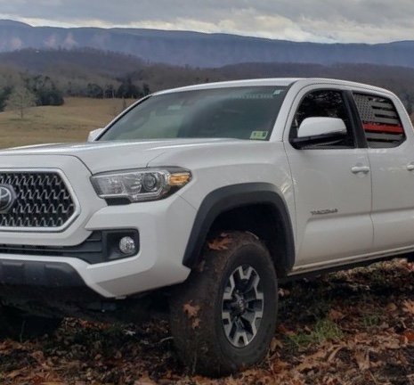

    Does anyone have any info/ideals on how or where to mount surface LEDs in the grill and or towards the rear

    Hurt my neck by making me look at his truck picture at an angle.
    Why do people do that?

    To fit it in the frame if you’re forced to take a vertical photo. Probably Snapchat or some kind of social media.

    or you could step back a few feet?
