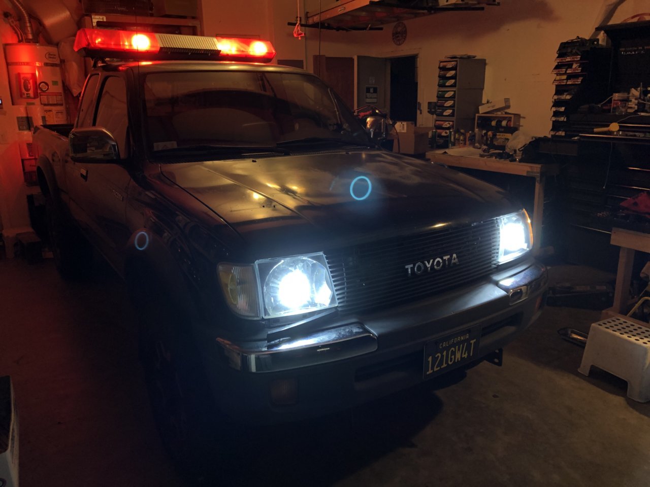

    You can always refer to the documentation for the system to see specific amperage ratings of each output.

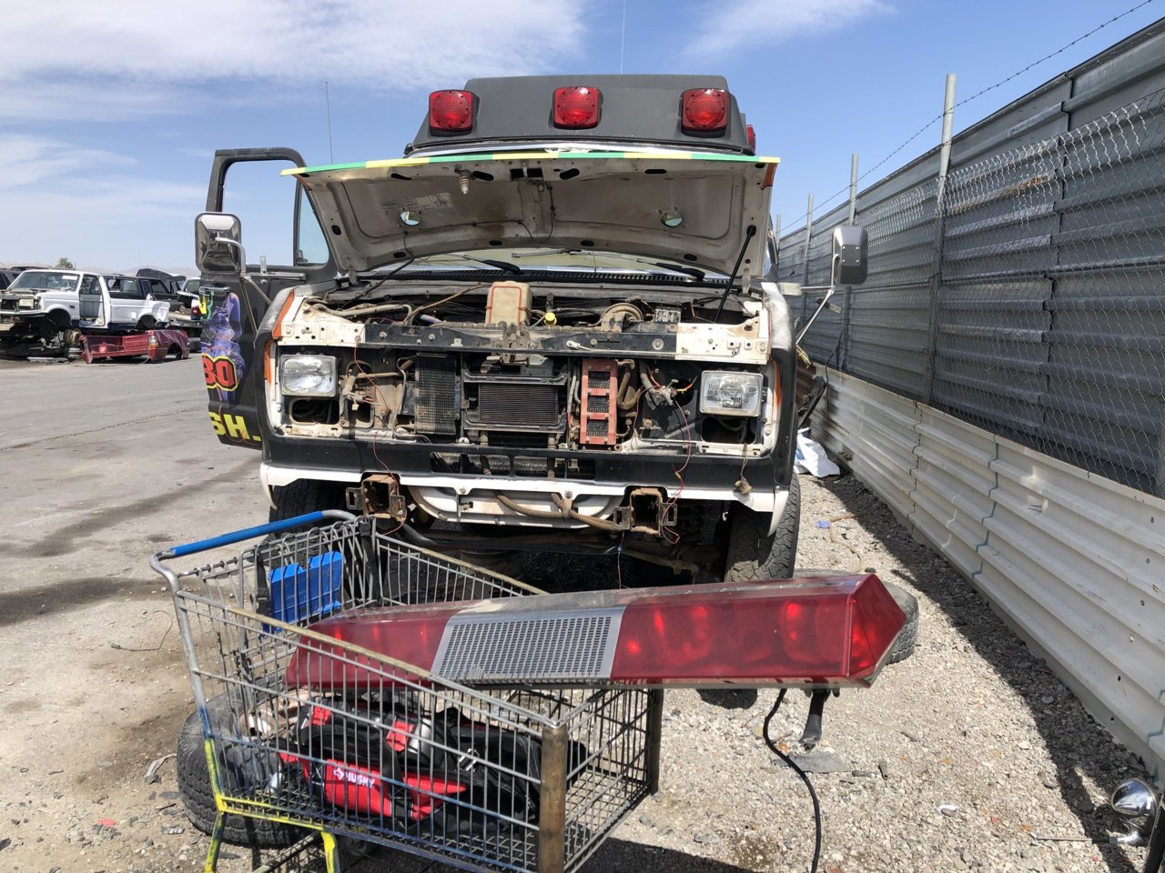

    These light and siren systems come from a time where high amperage Halogen lighting was the norm. I have a Code 3 XL lightbar from 1984 that draws 26 Amps from the factory.
    I tried it on my truck for shits and giggles. I didn’t take it out of the garage of course.
    I got it straight from a retired ambulance in the Las Vegas Pull-a-Part.

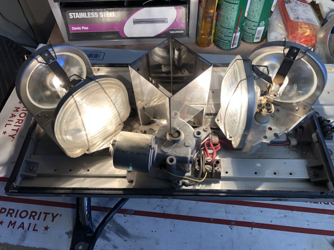

    Dual Alternator? :rofl:
    This isn’t a fire truck running lots of equipment. That style of lightbar went obsolete in the early 1990’s. Everything is LED nowadays which draws considerably less than 26 Amps.
    I mean just look at it, it’s so primitive. It has a worm gear motor driving a belt rotating four incandescent landscaping lights.

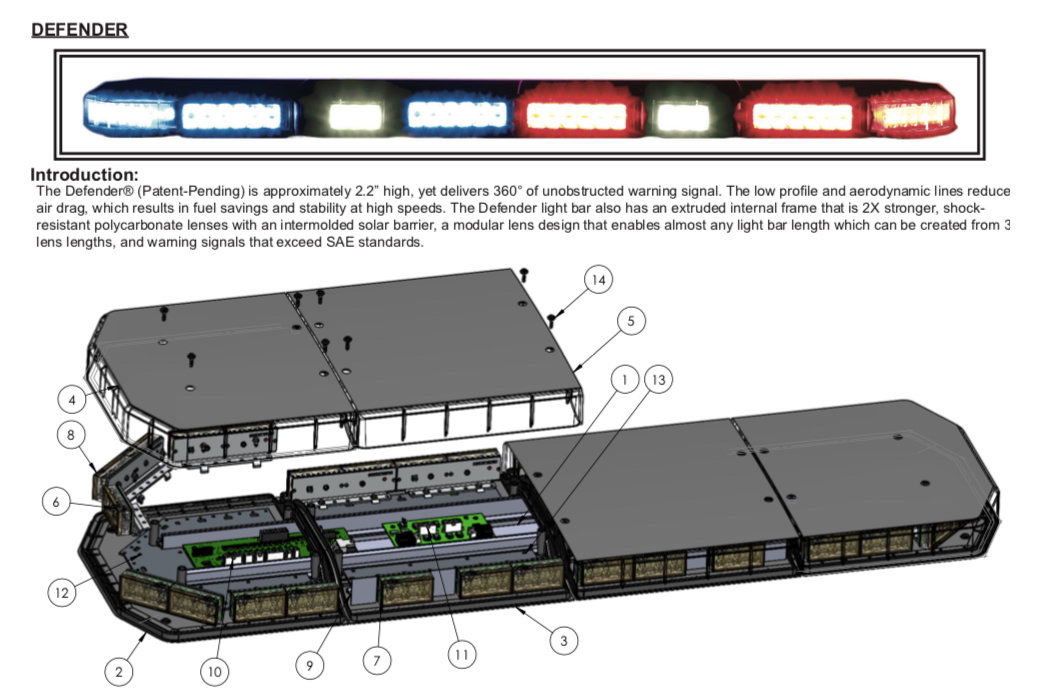

    This is a modern example of an all LED lightbar (Code 3 1000 series) used on most emergency vehicles, or similar variation thereof from Whelen or Federal Signal.
    They only draw a few amps thanks to how efficient LED’s are over Incandescent or Halogens.
