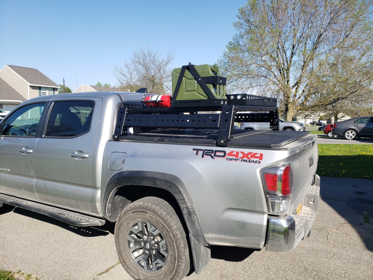

    I actually just posted a picture of my setup: pics 1 and 2 should be enough to see what I did. Drilled one hole into my VooDoo rack to mount the quick fist
    https://www.tacomaworld.com/threads/taco-life-hacks.665214/#post-23316600
    As far as longevity, I had the same unit in that spot for a year with no major issues (had it in the cab for a year or two before this). I did notice a bit of discoloration on the plastic handle when it got replaced due to recall. The recall was due to a design flaw in the plastic handles, so as far as I know the new units should be steel handles and pull pins.

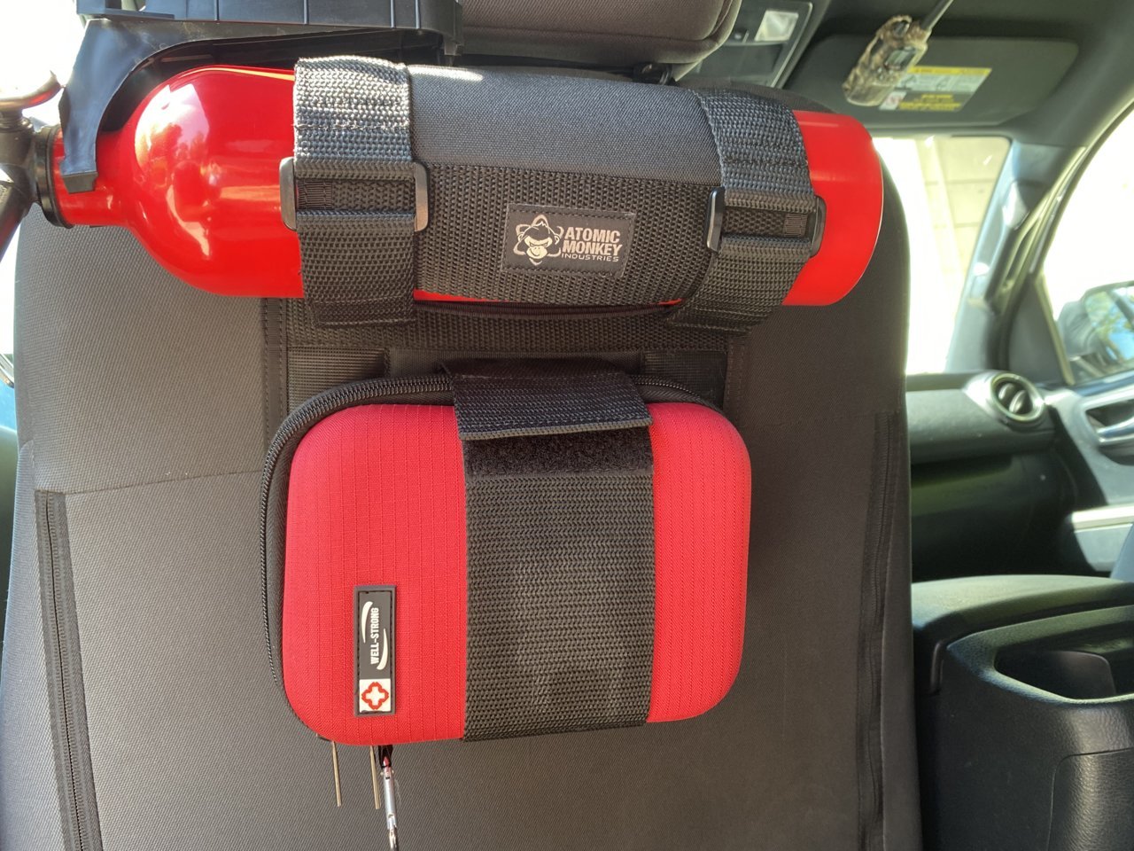

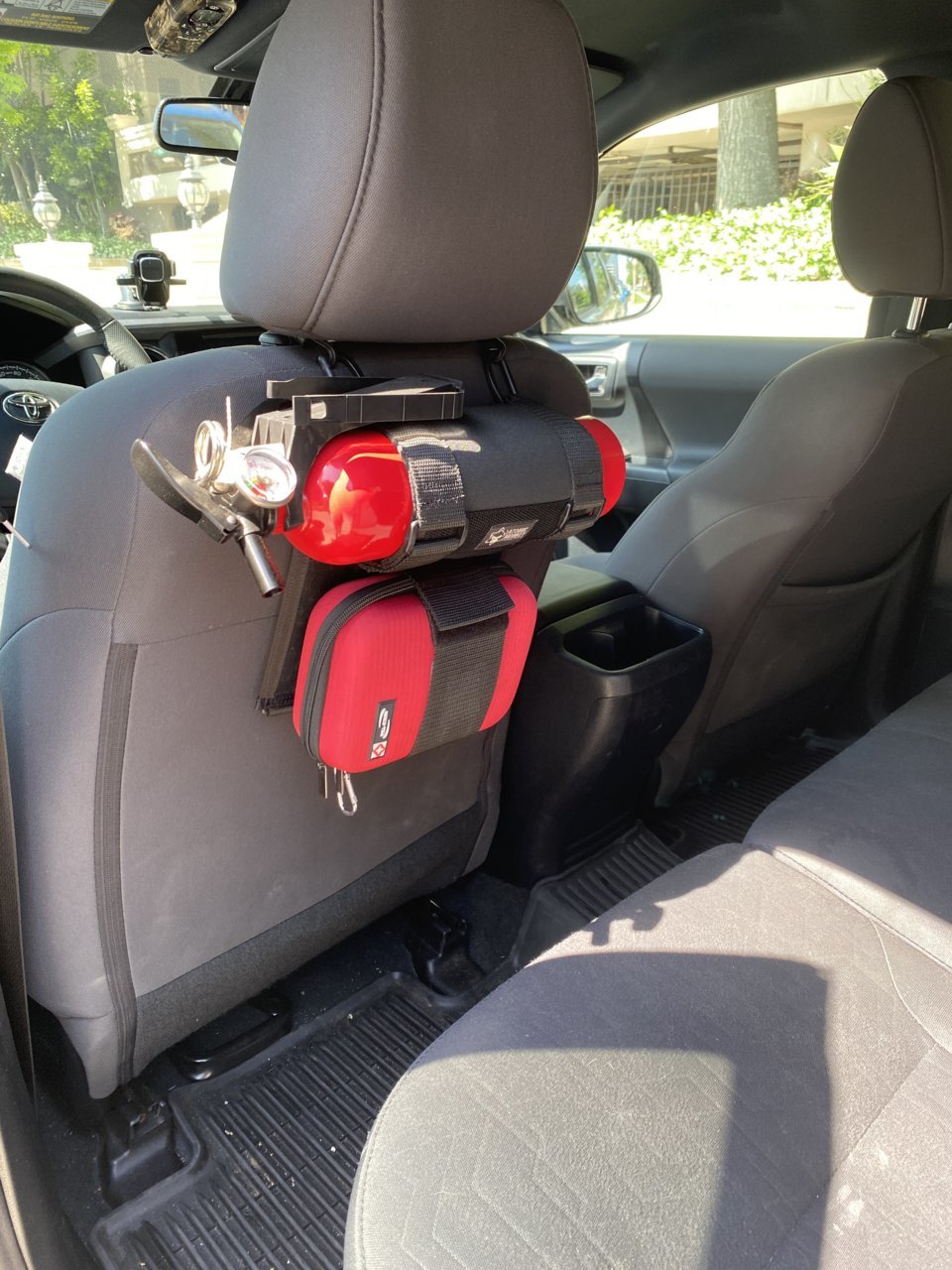

    This is my setup on the back of driver side

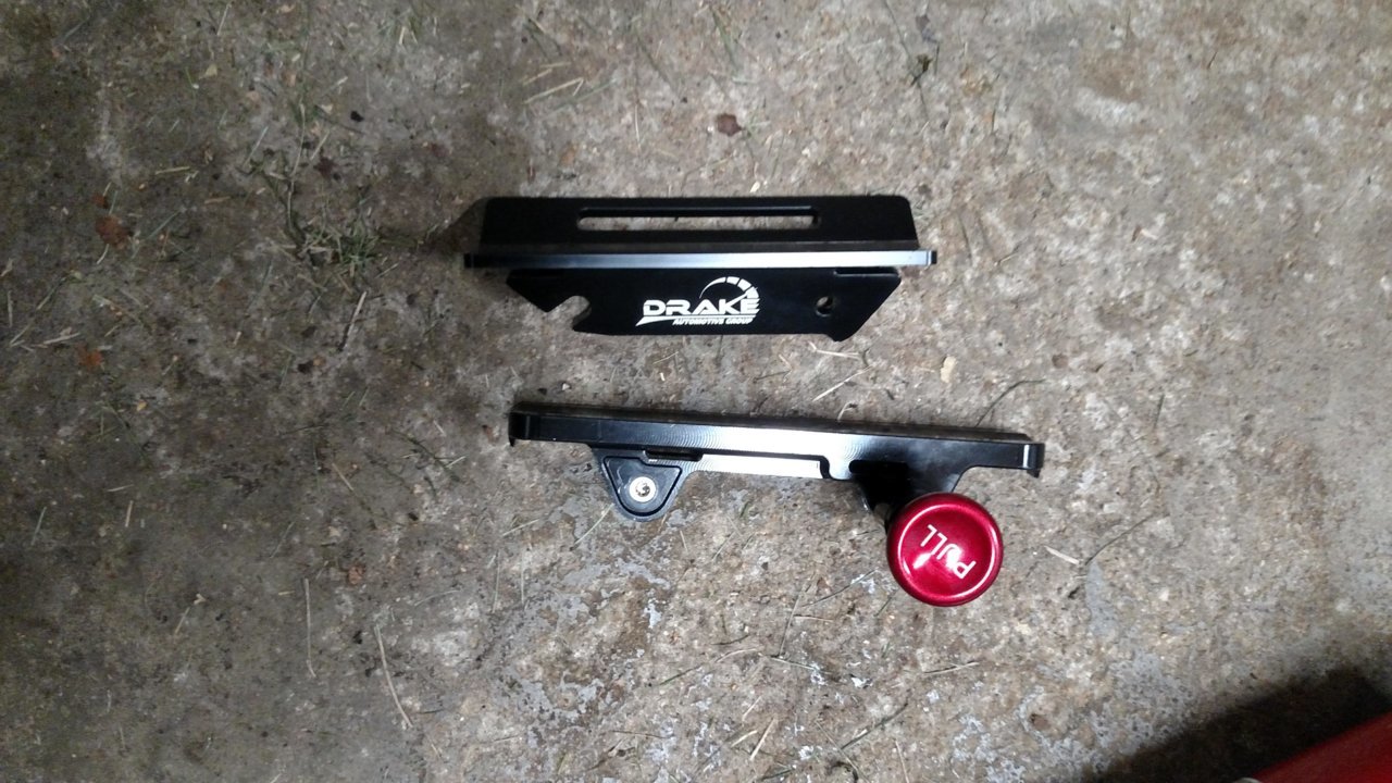

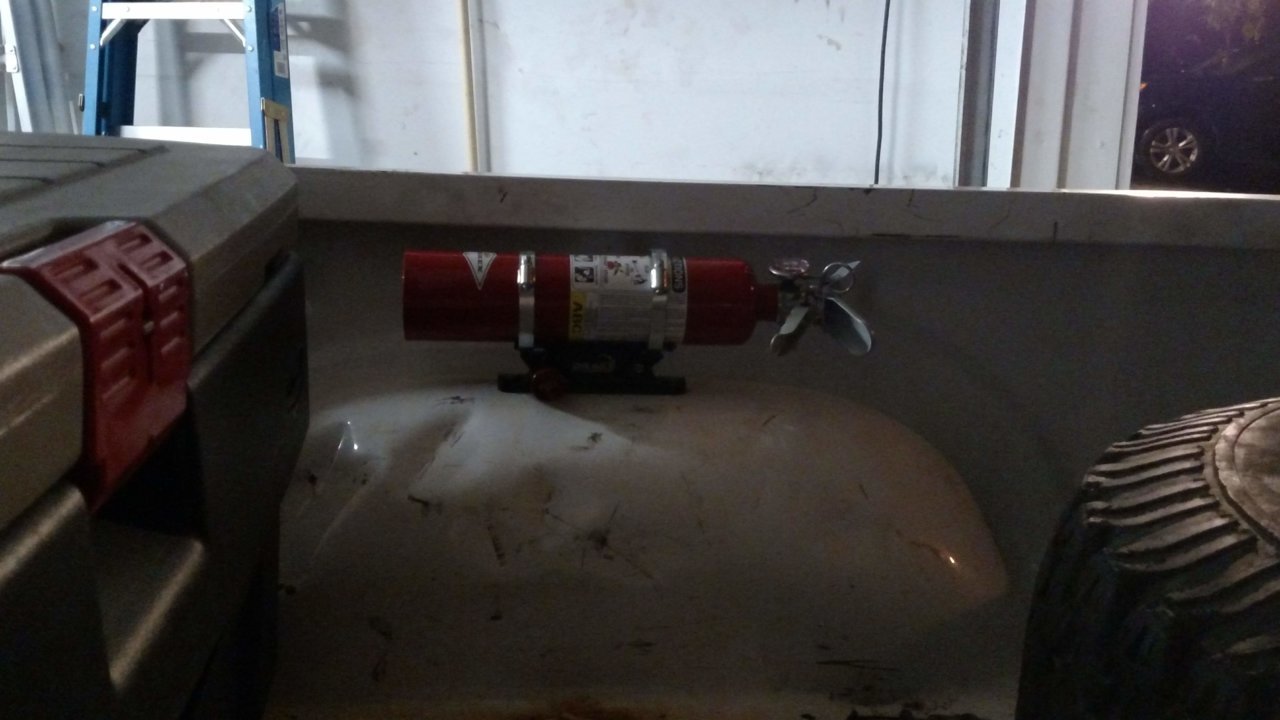

    I have an Amerex 5lb ABC extinguisher in the bed mounted with a drake fab bracket. I recomend getting a good quality indsutrial type extinguisher like an amerex with the metal head and components, they are only a few bucks more and made in the USA (I have been to the factory).

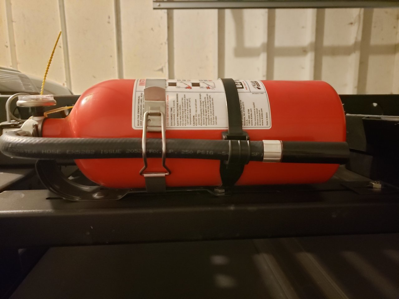

    Here it is. Kidde pro 210 4lb extinguisher in a Kidde DOT/USCG approved mount. I believe the mount is supposed to be used upright but it feels sturdy enough the way I have it mounted. The extinguisher rattles a bit in the mount so I'll probably glue some foam in to steady it. I'm also brainstorming a way to make a cloth cover for it to minimize UV exposure, but the cover has to be quick to remove and snag-free.
