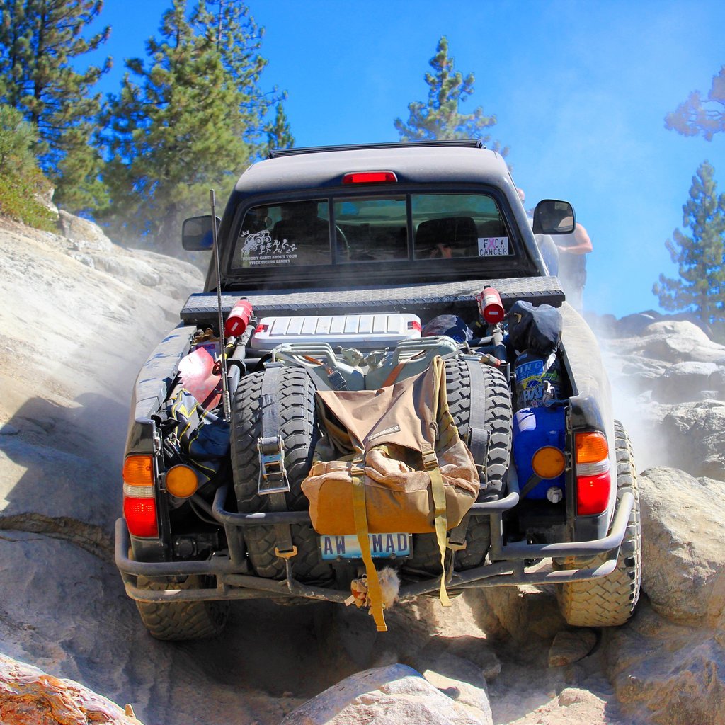

    Anyone have pics of a good mount setup in the bed?
    Can I mount one horizontally under on of the rails near the tailgate?
