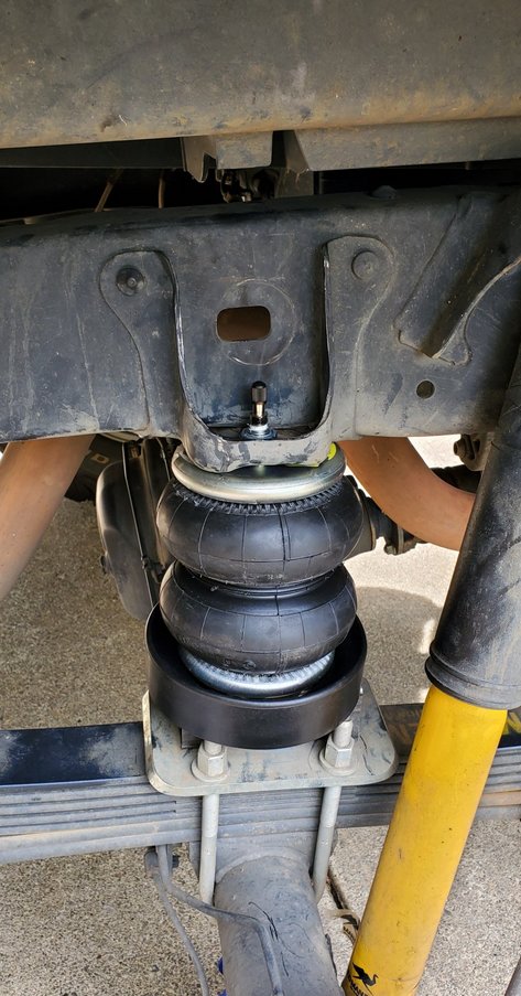

    I was looking at adding airbags to my 2021 Tacoma. While searching it out I came across this thread: https://www.tacomaworld.com/threads...lip-daystar-cradle-bump-stop-sold-out.638686/. Does anyone know of a similar design, or if anyone else has made a similar product. I have searched all over but been unable to find anything that will work with the ubolt flip kit that I already have installed. Any help would be appreciated.

    I have that @badger kit, and it works great! At some point, @Crikeymike was interested in selling them, but nothing ended up happening.
    Interesting thread about airbags with internal bump stops here, but @Blueberry.Taco used 63" leafs. Maybe look for a different length of that bag that will work with the stock leaf springs?
    :thumbsup: GL! Keep us posted.!

    Yeah, I never got any further on it. I just sell the airbags and cradles which use regular downward facing u-bolts.

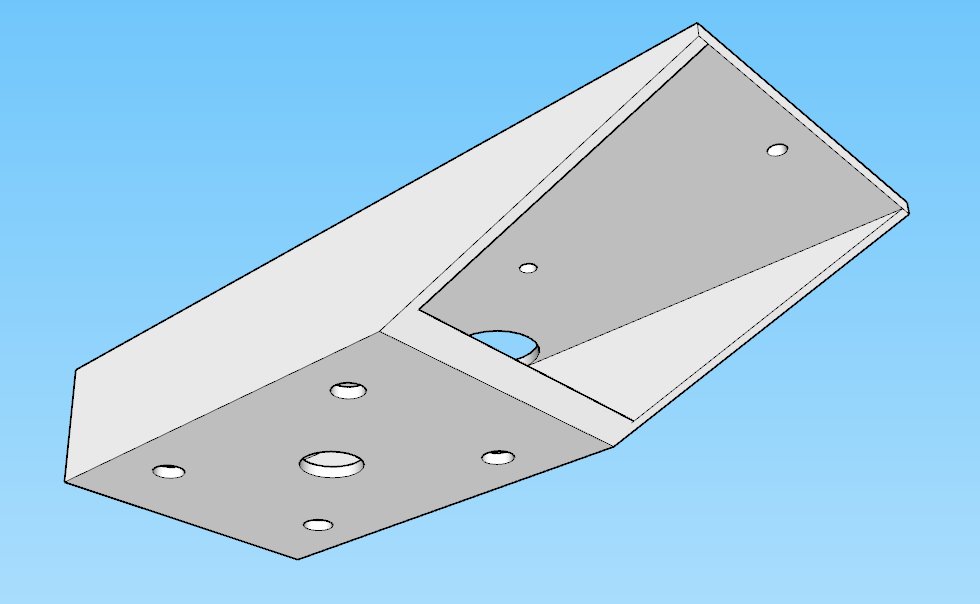

    Looking for any feedback as I move forward with a design I'm toying with. I've installed the Firestone bags by drilling a hole in the factory bump stop pad so it's centered over the leaf pack instead of off to the side. Right now I have a piece of rectangular tube underneath the cradle that's fastened using the bump stop holes in the plate.

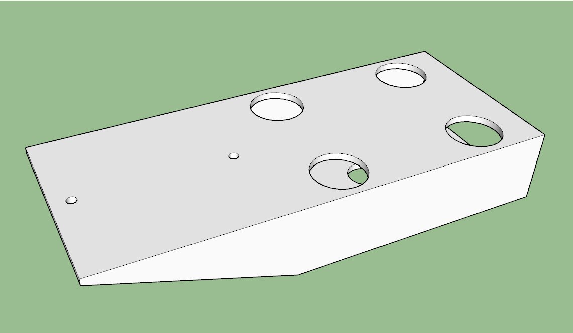

    I'm looking to make a new ubolt plate out of a piece of 2x5x.25 rectangular tube. It will be cut at an angle to allow leaf movement and will have holes drilled to mount a bump stop (Wheeler's Superbump in this case) forward of the area where the cradle will mount. Holes in the top of the plate are there to feed a socket down to the fasteners on the ubolts to torque them down to spec.

    Keep me posted I had these bags on my 03 Tundra and loved them. My 20 Taco gets a bit saggy in the ass.
