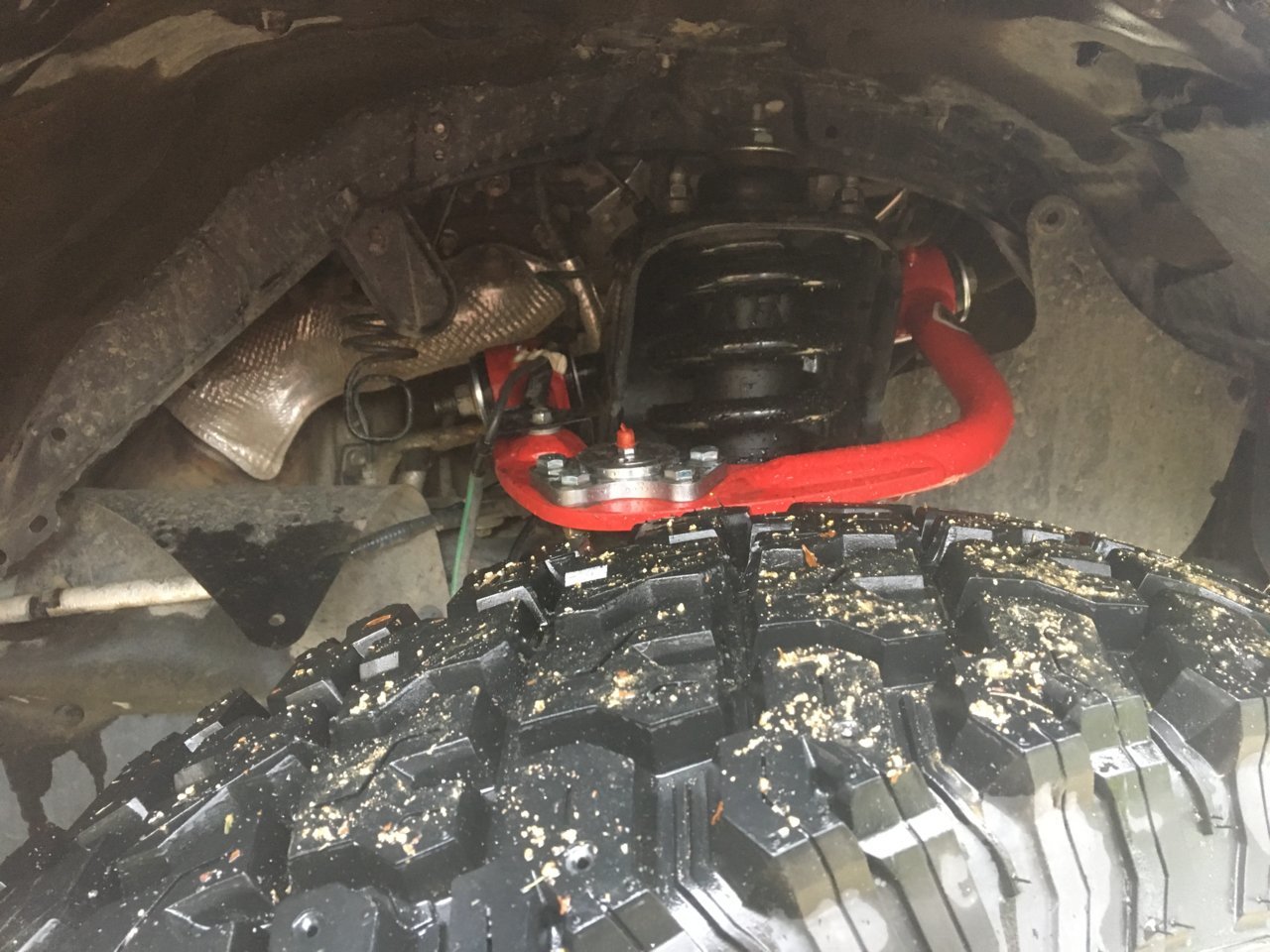

    at Firestone now for an alignment but they say they probably can’t get camber in spec with my JBA high caster arms. Wtf?

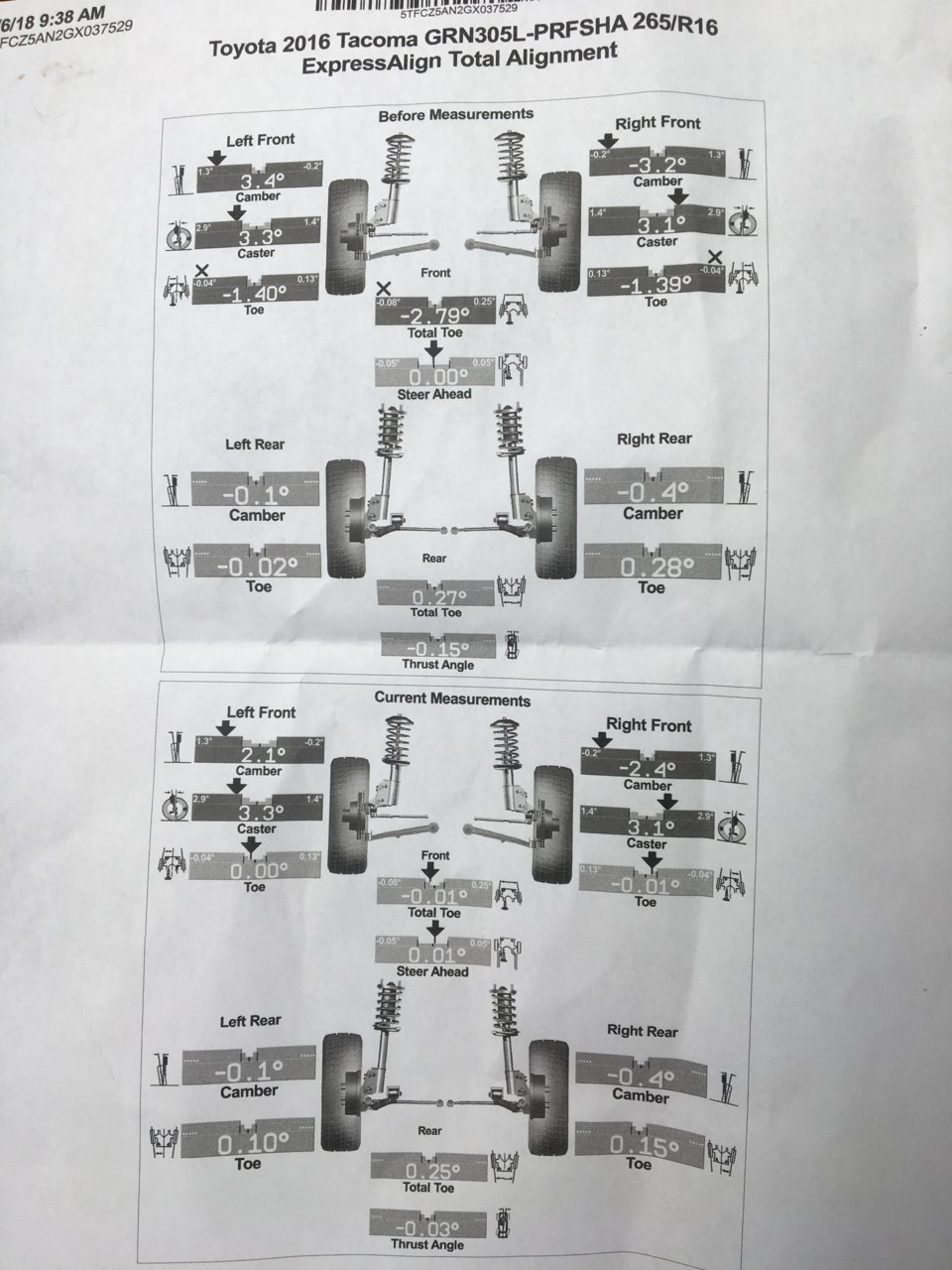

    They showed me the cams and they’re maxed out, and these are the numbers.

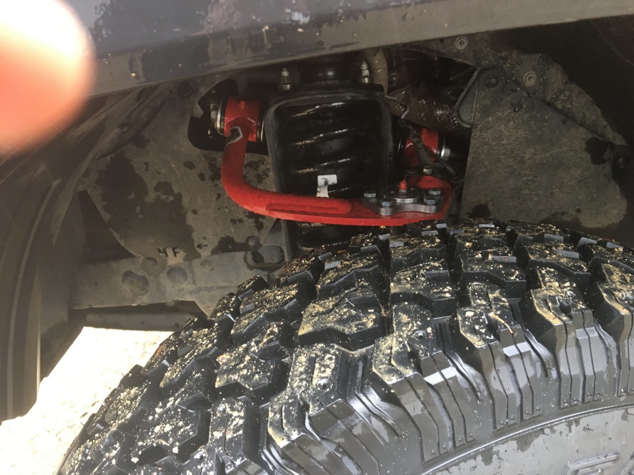

    passenger side arm
    Bastek likes this.
  15. Apr 6, 2018 at 10:24 AM
    Rujack
    Rujack [OP] Stop Global Whining
    Aug 16, 2016
    #194732
    2,447
    2016 Tacoma TRD Off Road 6 speed manual
    Driver side
    Bastek likes this.

    2” OME with heavy Dakar packs

    yeah firestone sucks. wouldn't max out my caster with the JBA UCA (for some reason couldn't get past 2 degrees of caster) and even made the alignment worse. to make things worse the grease monkeys flattened my alignment tabs.
    went to a shop that specializes in alignment and they dialed it in less than an hour. a month later i got TC gussets welded on because firestone ruined mine

    You should be able to get into spec. I'd like to see the alignment cams to see if they are rotated correctly. Specifically the front cams
