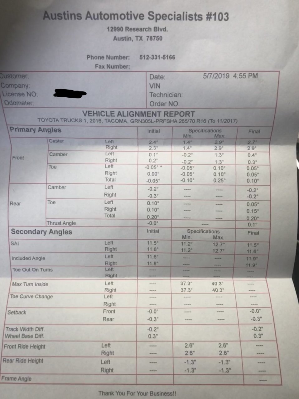

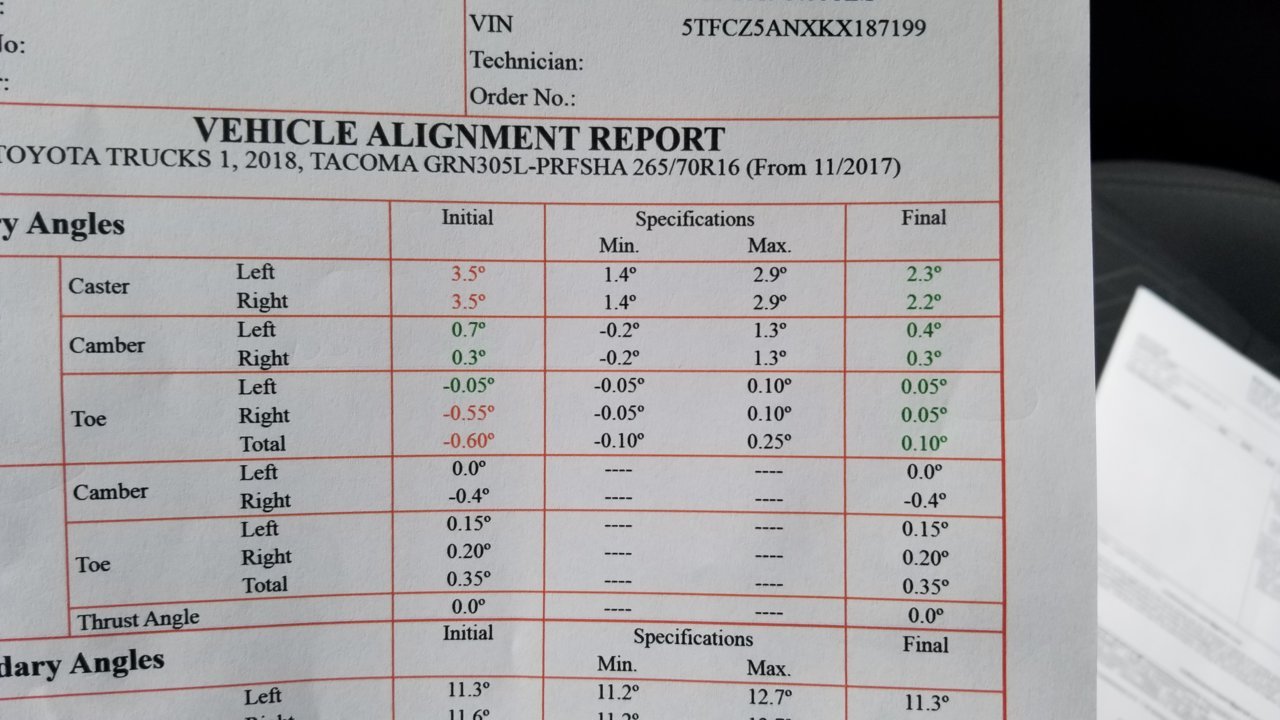

    Dude, your numbers were better before than after! They just needed to adjust toe pretty much.

    They went by the specs. Its within spec now so it works for me..

    Those are indeed the specs for a non-lifted truck. They have basically used your adjustment cams to remove all of the caster that you bought the UCAs to achieve. The truck will drive much better if you get back to that 3.5 degrees or higher. Take a picture of your alignment cams and you’ll see what I mean.
    This is my alignment with stock UCAs. It drives a LOT better after than before.

    Remember that your steering angle changes as the tire cycles from full compression to full droop. By lifting, you’ve changed the point of the suspension cycle that your truck sits in at rest. If you wish the truck to handle as it did before lifting, you must increase the amount of caster that the truck has in its new neutral position.
    Take a look at my before/ after numbers. Just adding that small amount of caster made the truck handle much better. If I could get 3.5, I would definitely do it. It’ll drive OK where you are, but steering is much twitchier, does not return to center after a turn in the same way, and you’ll experience bump steer when going through corners.
