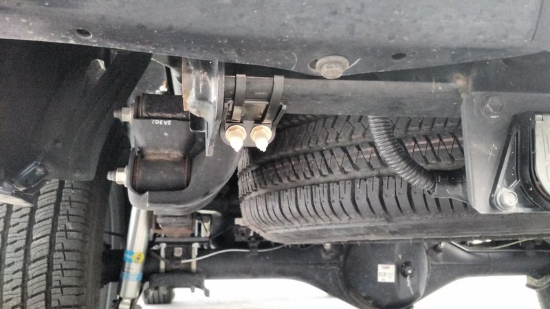

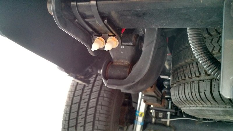

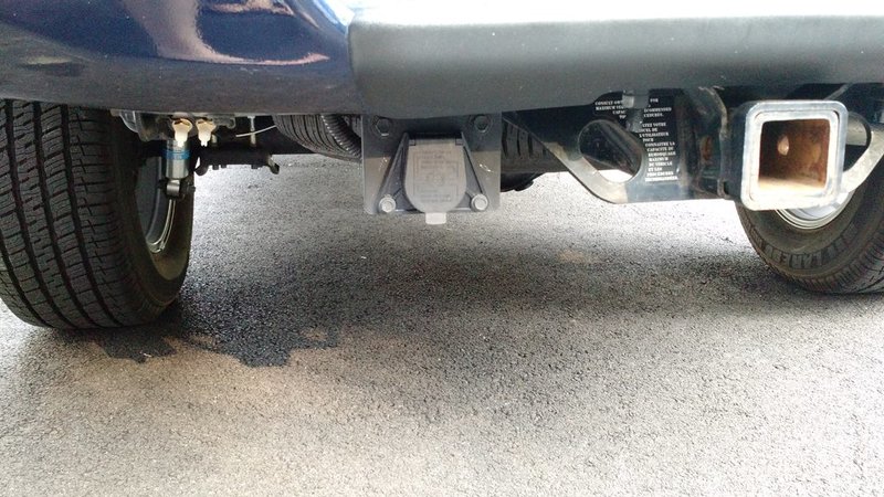

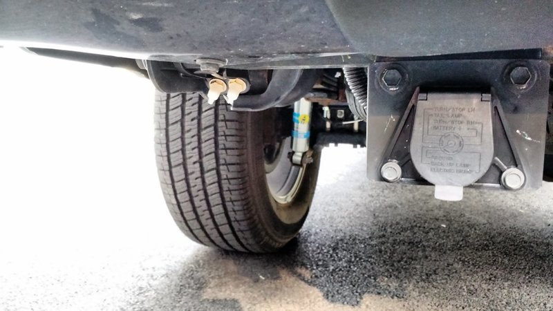

    Yup! That's exactly where I picked mine up at. They shipped same day too!
    Installed yesterday...
    I haven't seen this on other Ride Rite installs, but now they include a mounting plate that zip ties to the square receiver tube. Nicely tucked out of the way of damage.

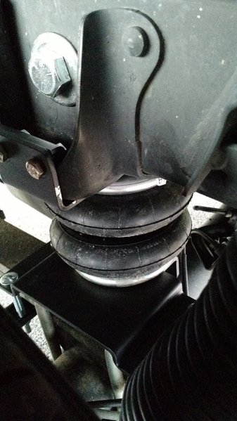

    Why does every ride rite install look like the air bag is way off center and about to slip off of the mounting plate? I've seen the day star cradles and they seem to correct this issue somewhat. Maybe I'm just crazy. Anyone?

    When the spring is loaded the rear hanger flex backwards moving the axle slightly backward. So it's better to have it offset to the rear slightly.

    The airbags are mounted directly under the frame which puts them offset to the center of the truck as the springs are centered outboard a bit (the tab sticking out of the frame is the bump stop bracket). Why Firestone chose not to extend the mounting plate more to the center for the bottom mount, who knows. Most likely, not a strength issue and so they didn't.
