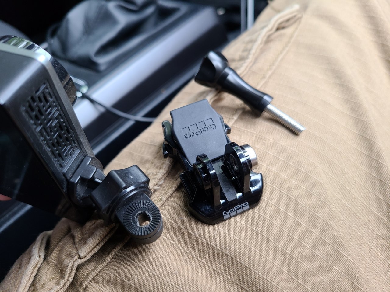

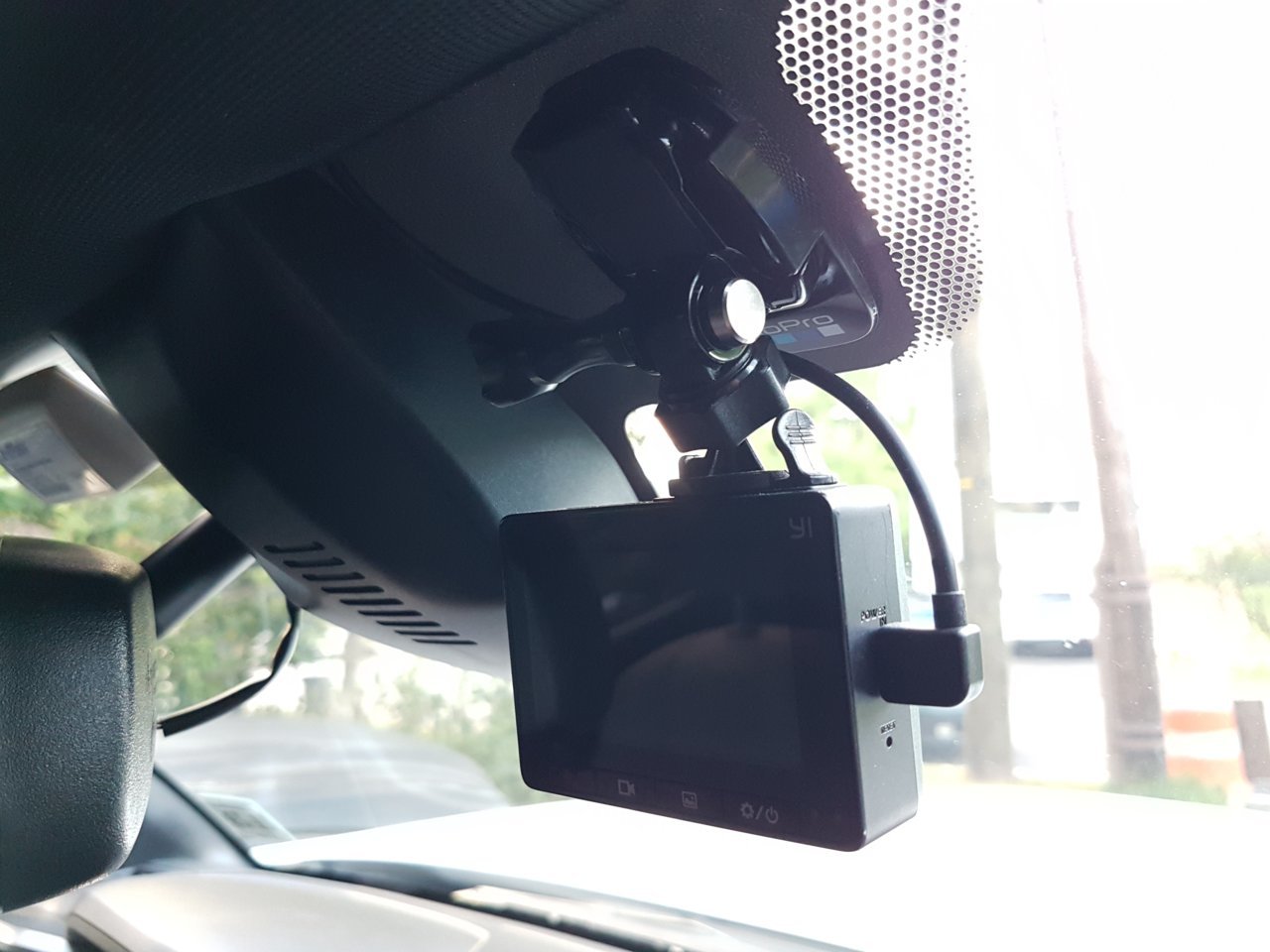

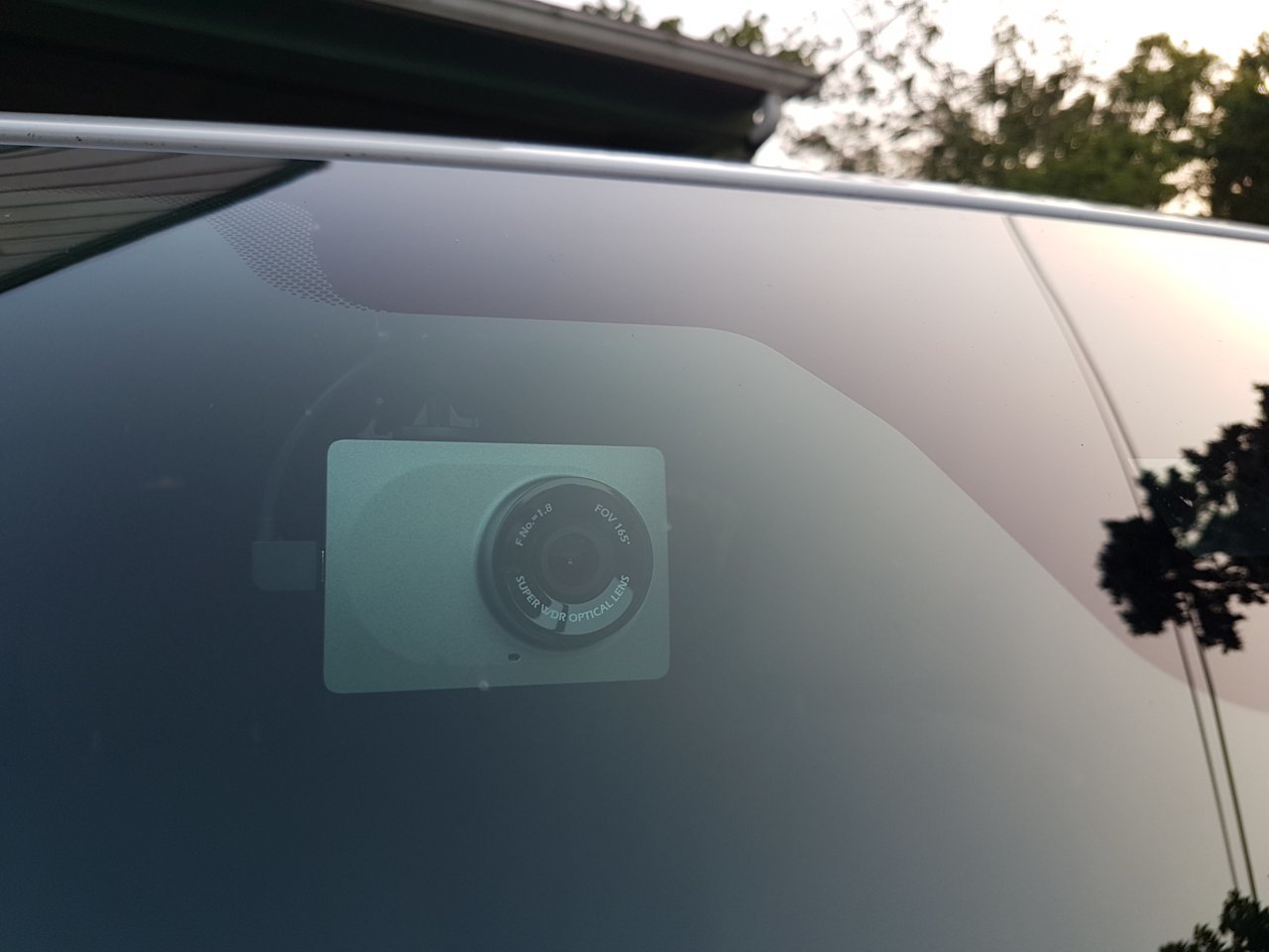

    Good question! I chiseled out the center "prong" on the standard GoPro mount that clips into the factory car location. Then drilled out the diameter of the tightening screw on the camera supplied mount. The parts fit together perfectly after a little sanding.

    I’ve got the same camera mounted the same way. :thumbsup:

    Thanks for this, that looks really good. I just did a quick Amazon search to find the "standard GoPro mount" that matches what you have in your picture and couldn't find it. Do you mind providing a link for that?

    Would either of you please post some pics of the modified gopro mount. Sorry about the truck OP. And thanks for sharing your camera setup!

    Yea man, it's this guy circled in red. If you take out the center prong out, you can shoehorn the supplied mount (also circled) in there.

    You might be able to find the regular mount on eBay for cheaper! Then do the following mod. Ez pz.

    Thank you Sir! Definitely going to use this setup.
