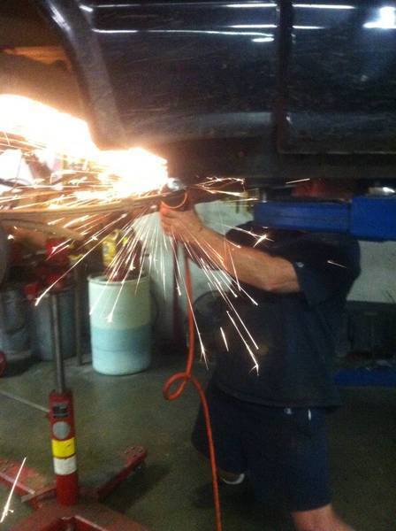

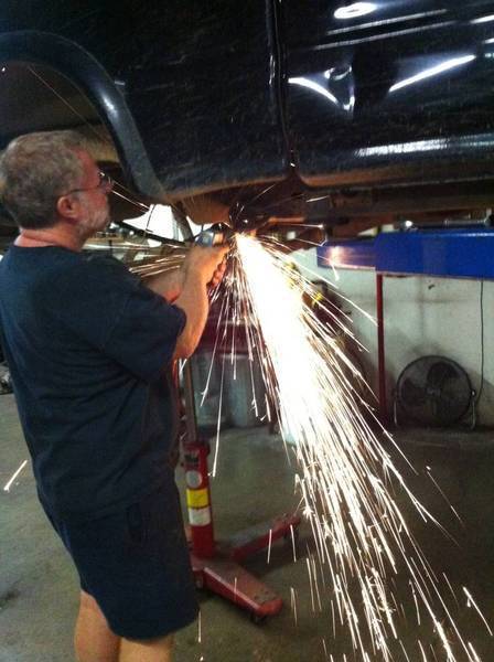

    So i finally got the pics off my phone and posting up here the man in the picture is my father. He is grinding the bolts that hold the springs to the truck because they were froze into place.
