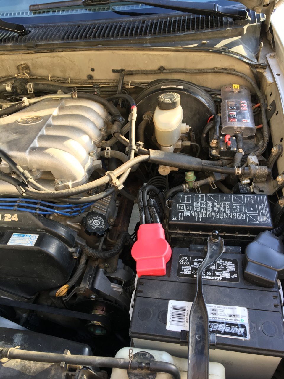

    hey guys I’m in the process of building a fuse panel/electrical tray for a 2003 with a manual trans. Unfortunately I don’t have the truck with me so I was hoping someone could get me the measurement from the fire wall to the point on the slave revisor cap closest to the front of the truck. I’m planning on starting it right before the cap so it’s not obstructed. Thank you guys !!!
    Pic is basically what I’m doing but this is on my truck which is auto

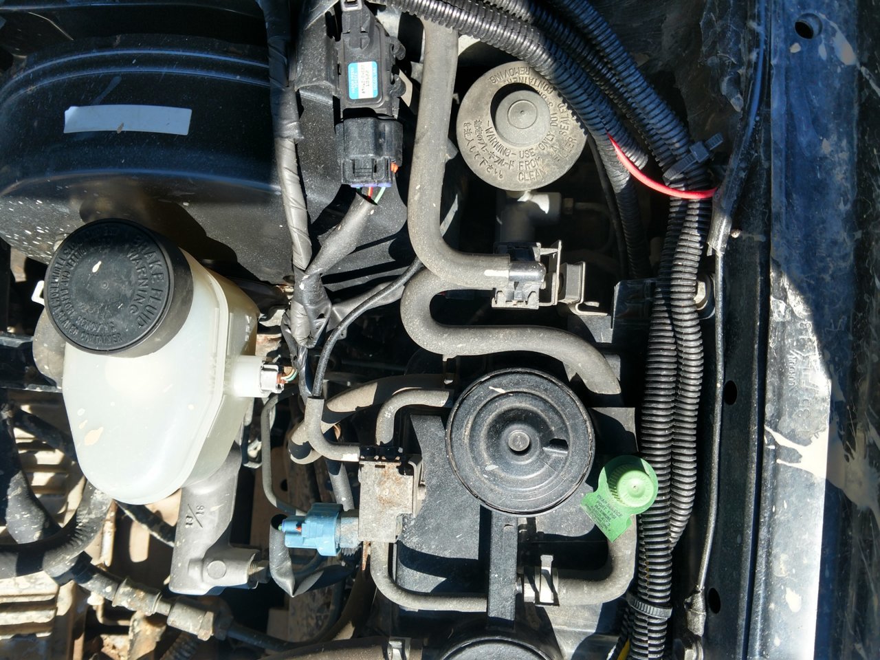

    You talking evap canister???

    Top right cap is for the clutch res... Just trying to see where you need the measurements from

    Firewall to center of clutch res cap is 2.5" exact. 3 1/8" from driver side of engine bay to center of cap. 4.5" from top evap canister to center of cap. 7 1/8" from evap canister to firewall. 5 7/8" from brake booster to driver side engine bay. When I reference the evap can I mean the closest edge of the circular portion to the firewall...sorry I'm not sure what the actual name is.

    No he doesn’t have the evap in the engine bay but the 2.5 to center of slave res will get me where I need to be. I’ll start my mark 4 inches from the fire wall and that’ll give plenty of room
