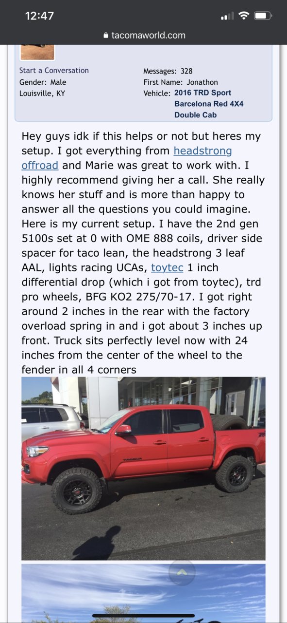

    Thank you! That helps. I’ll share what I’m looking for if you can help me too
    So Ordering my first lift.
    going to go with headstrongs kit.
    885 or 887? Leaning towards 887
    single leaf or 3? Leave overload on?the post you shared helped (Eventually want to get a camper shell or possibly a alu cab at some point) so don’t want it to sag
    still not sure what to do with the camper shell in mind. Thoughts?
    Uca needed if going with 887? (If I don’t need it, I’d like to save the money here)
    this guy started with 885 and went to 887 with UCA. So wanted to hear other opinions. Want to keep it level if possible.

    Just something to note, Bilstein 5100's are designed to lift using the factory spring, while the OME springs are a lift spring designed to work with factory shocks or OME shocks.
    Although the combo of Bilstein and OME springs are done regularly, there are lots of complaints of harsh rides from the combo of a lift strut and lift coil combine.
    This is why I decides on a system designed as a single unit over mixing and matching.

    OP, He's right ya know
    Bilstein 5100s on OME 884s
    Icon AAL
    Be sure to keep the Billies on 0 though if you go aftermarket coils

    You probably don't need UCAs for the ~2" lift you're going for. Once you get it set up and take it in for an alignment you'll know. If they can't get the truck into spec you may need to get new caster correcting UCAs (basically any decent aftermarket set).
    Go with the progressive 3 leaf AAL for a smoother feel. Maybe get a ubolt flip kit and new bump stops while you're at it since you'll have the rear suspension apart anyhow. I've got the Icon 3 leaf AAL w/ overload left in since I have a Leer shell and some other weight over the back end.

    OP, I did the 5100s W/AAL as well and couldn’t be more happy. I did end up going back and adding UCAs later and I’m very happy that I did. Plenty of clearance and room for my 33s.
