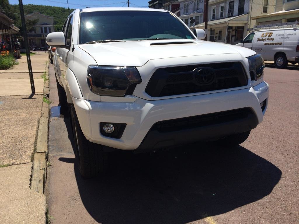

    Hi all,
    Just got my 2014 Tacoma DCSB a few weeks ago, and had to retrofit in HIDs as i do with all my vehicles since Matt got me hooked about 10 years ago.
    I went with the FX-R 3", with 55w ballasts and 55w 5000k Morimoto bulbs, and Apollo shrouds. Playing around, I also installed two small washers to color mod them, which i think turned out pretty good.
    Shipping was lightning fast from The Retrofit Source, and it's nice knowing whenever I have a question, however dumb it is, they're right there to answer and help me out. I wish all modifications came with that support!
    Install was pretty easy, and these headlights baked nice and easy using the "preheat to 200, then turn off, and bake headlights for 10min" method :)
    Painted the whole housing Toyota black, and didn't mess with any parking light or anything yet.

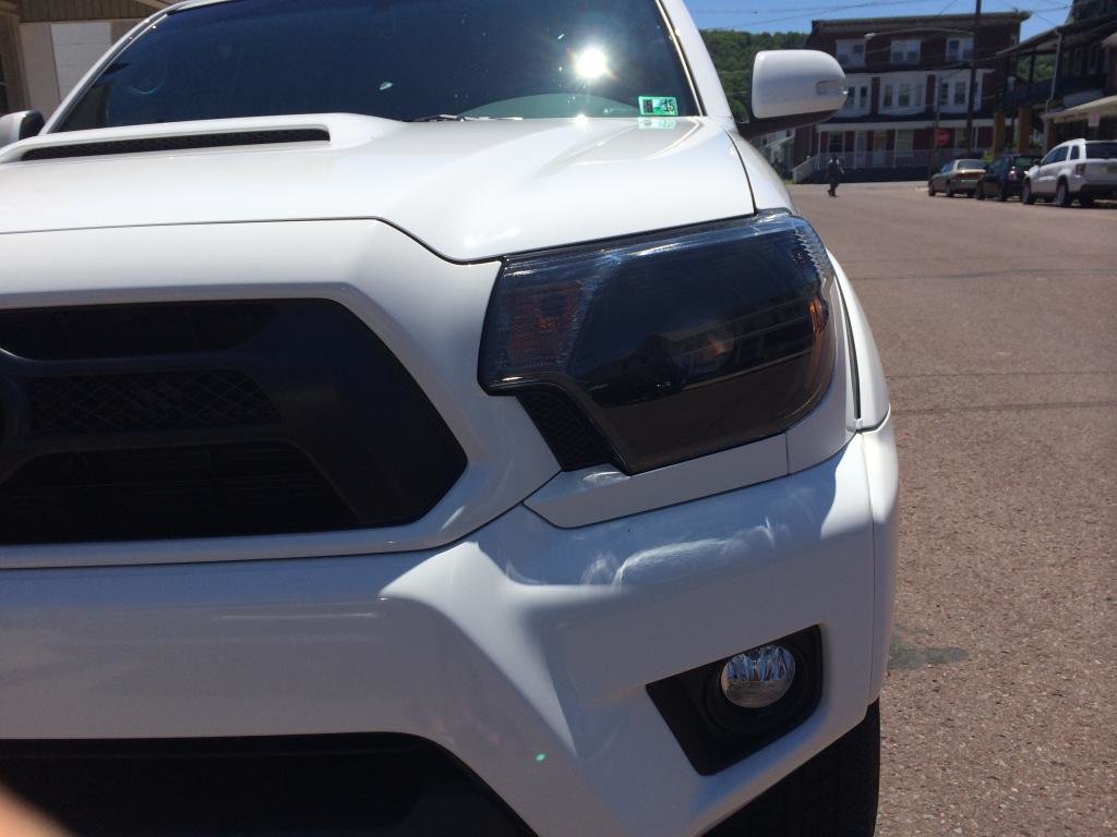

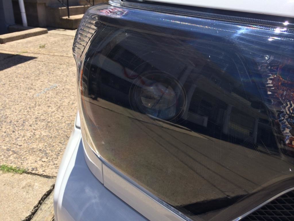

    I have a little bit of aiming to do later, and i'll post output pics later, but wanted to get this started, so here's some shots from a few mins ago.
    Thanks TRS!

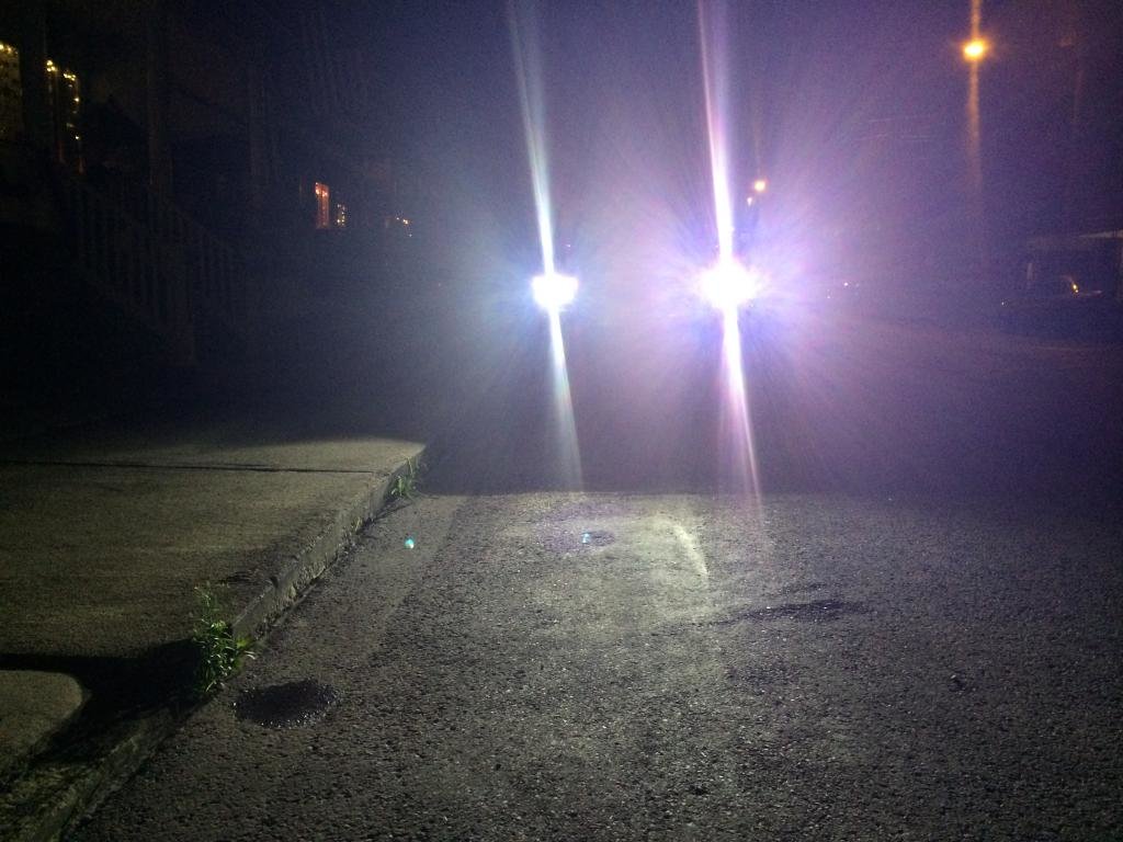

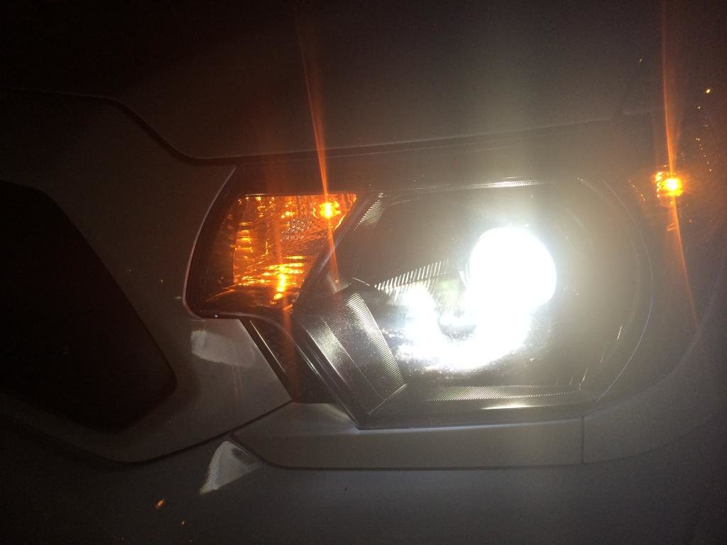

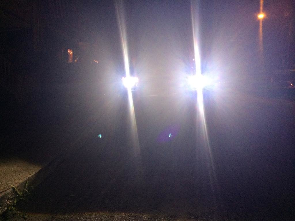

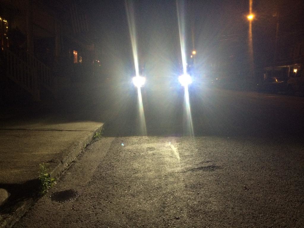

    Couple night shots:

    Thanks, yeah, thats where i got mine as well, TRS is the place to go!
    I recently did a friends subaru with halos, and we just wired them up to the parking lights. Like the truck, we could have also wired them to the DTRL, but on his subaru, we disabled the DTRL, so that ruled that out.
    A tip i could offer is to make sure you align them on the car while they are lit up. It's such a PITA to take the JBweld off if the projector isn't aligned.
    I got in on TRSAndrew's Group Buy pricing.... i think it came to a little over $250 shipped from TRS. Then a few bucks for some machine screws, washers, and bolts to secure the projector, a few bucks for some paint for the housing. All in all, a pretty cheap mod for what you get! The whole process took me a Saturday to do. I started in the morning, and did paint the same day, then took a break and did some other things, then finished. So I'd say about 6-7hrs I had in it total.
    Since i don't use my fogs now (because the HID's are so bright) i might put some black tint vinyl over them.... still up in the air on that one. I might wait for a really foggy day just to be sure I'm not gonna use the fogs! :cool:

    I actually used base/clear from a spray gun. My friend does body work, so i just had him spray them with a black then clear them.
    I aimed the first, and it was smooth, then i was rushed, and didnt aim the second, and i paid the price. I had to take that one back apart because i couldnt get it high enough with the aiming screws :(
    I started using a 2.5" hole saw bit, then just added a bit around using a dremel. I wouldn't even attempt it without a dremel.
