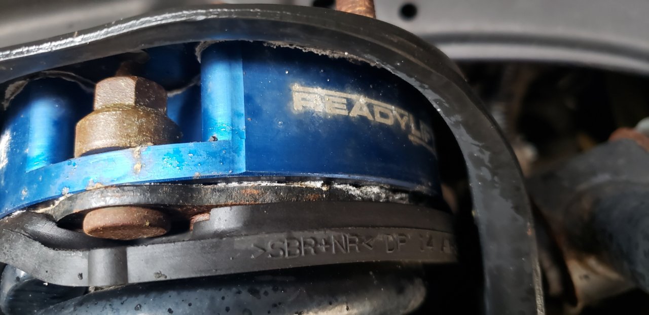

    On top of the front coils are blue aluminum READYLIFT spacers<?>. Is this part of some leveling kit? Or is this a "lift" kit? (Technically, leveling would lift... right?).

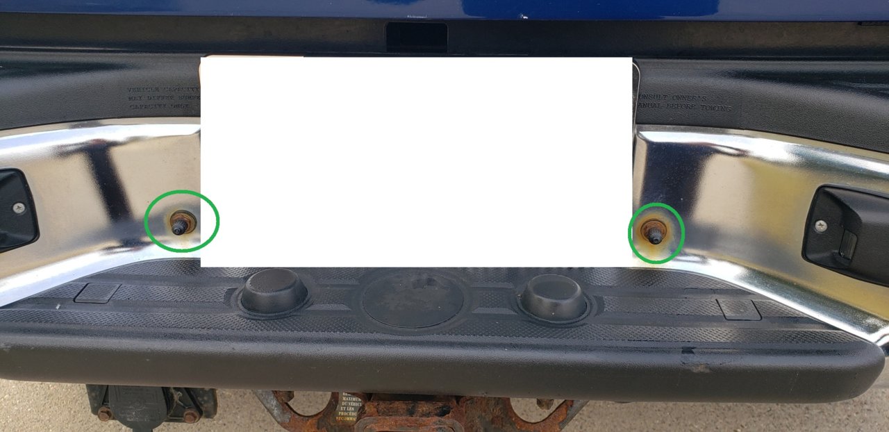

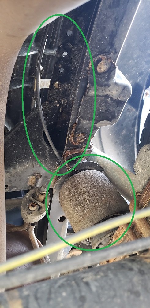

    The rear suspension has air bags? This is not OEM, correct? The tube runs to a schrader value on the rear bumper. One for each side. Wouldn't it be better to have them connected to a "T"?

    That would be a spacer front lift. Probably netting you around 2in of front lift.
    Def air bags in the rear, you don't want them to go to a T as they will create more body roll (outside of the truck compresses, which sends air to the inside of the truck extending that bag even more pushing the inside of the truck up... No bueno)

    If you measure from centre of your wheel/hub up to fender you can figure out your lift height.
    Front stock is 20 inches, rear around 22.

    Thank you all for the responses. Thanks @nd4spdbh for the quick education on why not to use a "T". :thumbsup:
