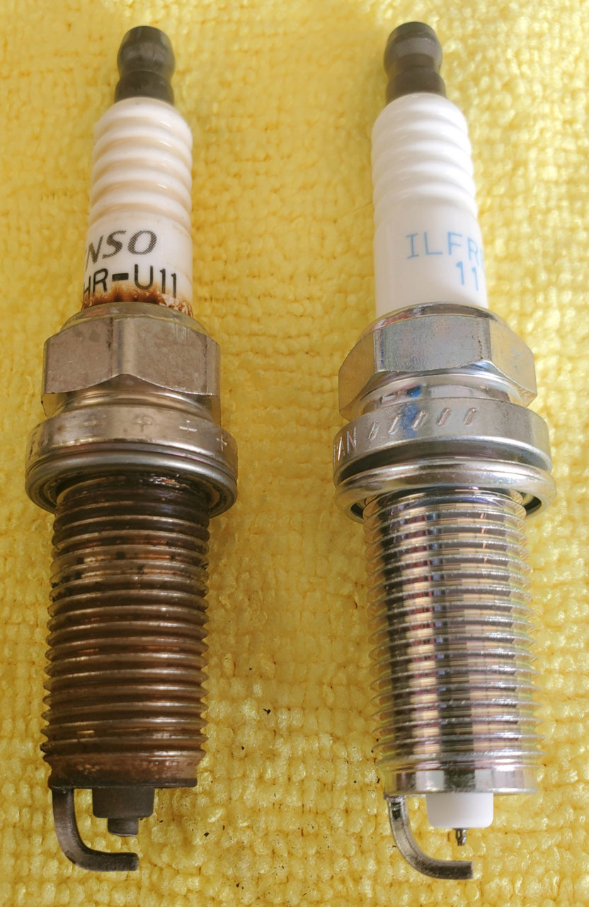

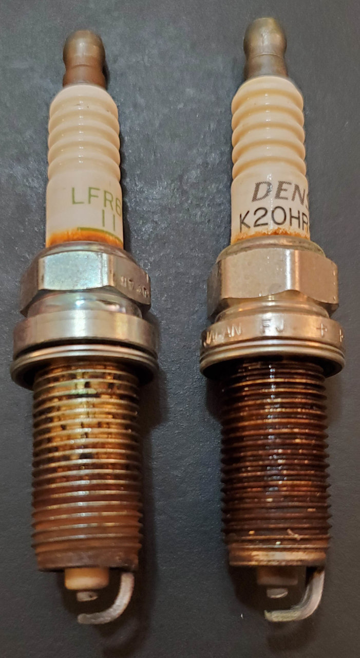

    So I have a 2007 Pre-Runner V6 with almost 60k miles. I finally did the trucks first spark plug change out and have some questions. The truck has been serviced like clockwork at the same dealership for the past 13 years but strangely they never did or recommended a spark plug change out (still do not). My main question is that the Denso plugs (according to Denso website) recommend plug change out at 20-30k and the NGKs (according to NGK website) recommend change out at 30k - but the dealer says the plugs are good until 100k miles. I did not notice any issues but thought it would be prudent to do as they were quite old. Swapping to Iridium (great experience with my Celica), I notice the truck is smooth er below 500 RPM and at highway speeds. I attribute this just to new plugs rather than iridium. It could also be that I clean the MAF. Anyhow, any thoughts on the discrepancy in plug life?

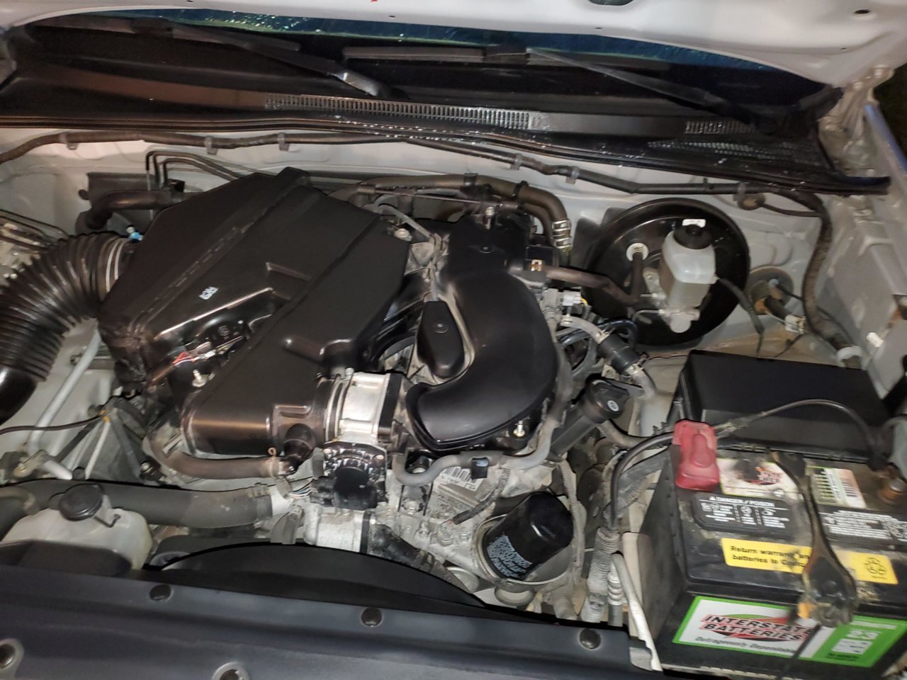

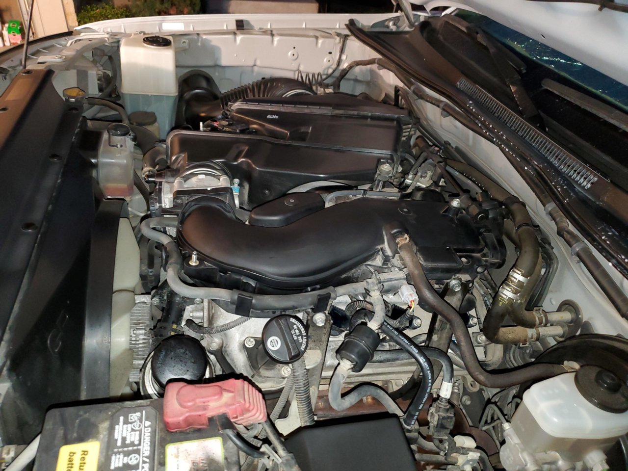

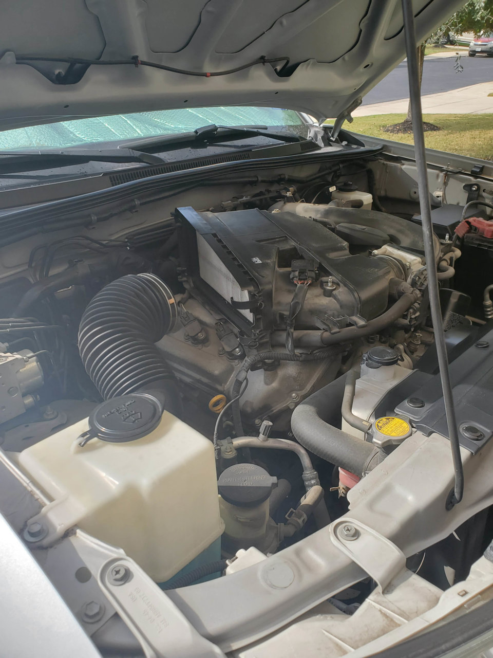

    Attached are photos of the factory plugs and a comparison of the new/old plug.
    For next time any recommendations of making coil removal easier on the cylinder closest to the driver? I slid the metal bracket over but there is a soft hose with rigid inside in the way. It did not want to come out easily so I left it alone.

    There is a rubber hose that runs to the pcv valve , disconnect it at the pcv valve to give a little more finger room to disconnect the coil, plus moving the bracket you mentioned

    Here's a video showing what to move out of the way to access those tricky plugs on the driver's side: https://youtu.be/EDONxuxYbvQ?t=403
    It should come up in the middle of the video at what I THINK should be a relevant time.
    I found that using a dedicated spark plug extension ( https://www.amazon.com/gp/product/B07MH5ZDMD/ )made it mostly a breeze, and for that last one (closest to driver) I also tossed another wobbler extension on because I happened to have one.

    The rear plug on the Driver's side is a bit of a bugger to access. I pulled off several hoses to get space. PCV and a couple other hoses attaching to the manifold. Just work the hoses off with gentle force. Mark them if you have trouble remembering where the hoses live.

    NGK vs Denso @ 205k Miles :D
