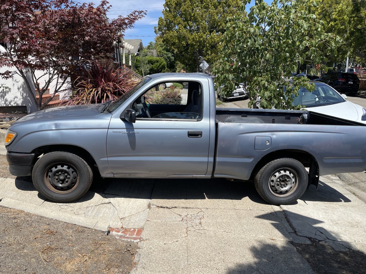

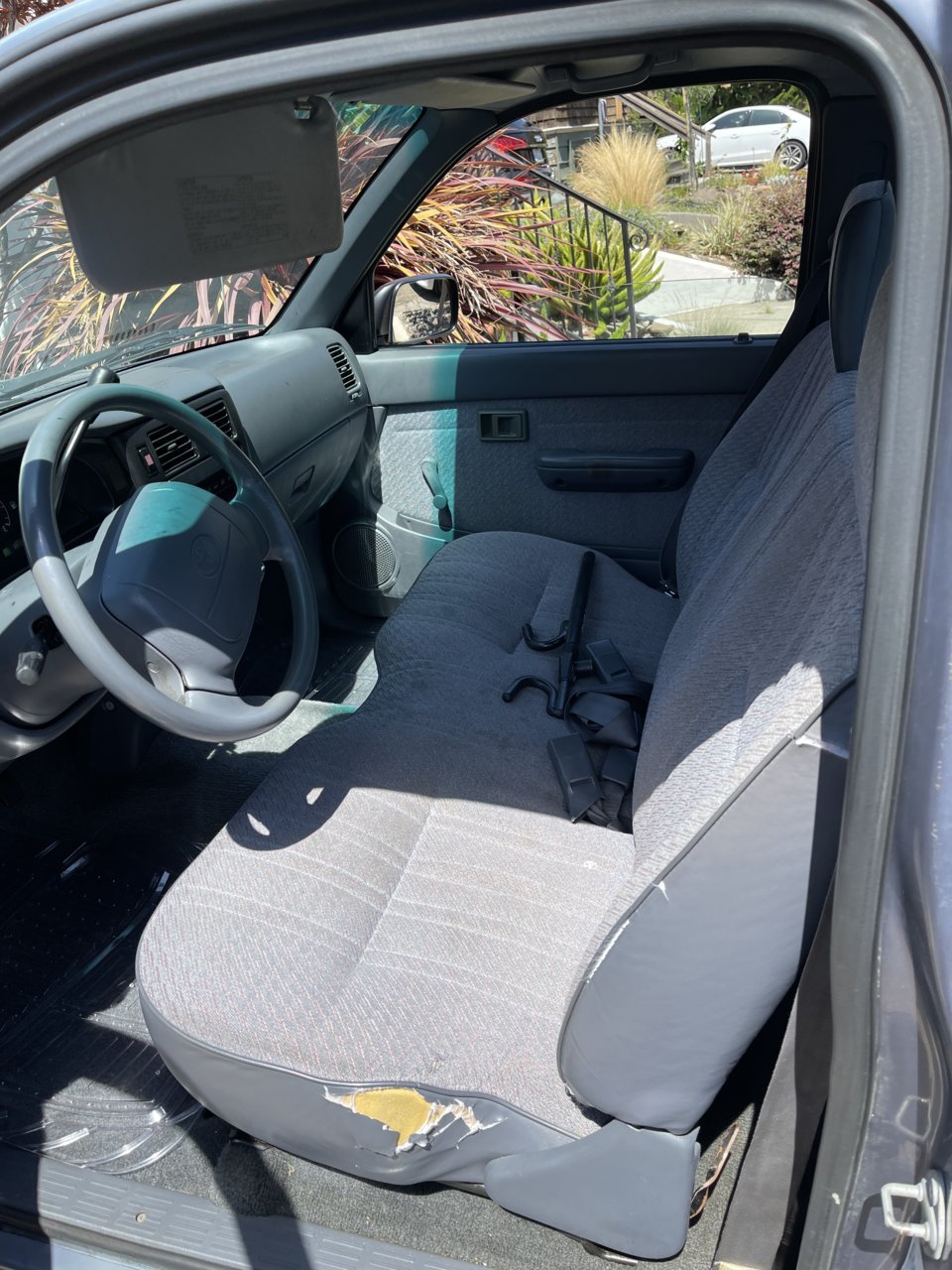

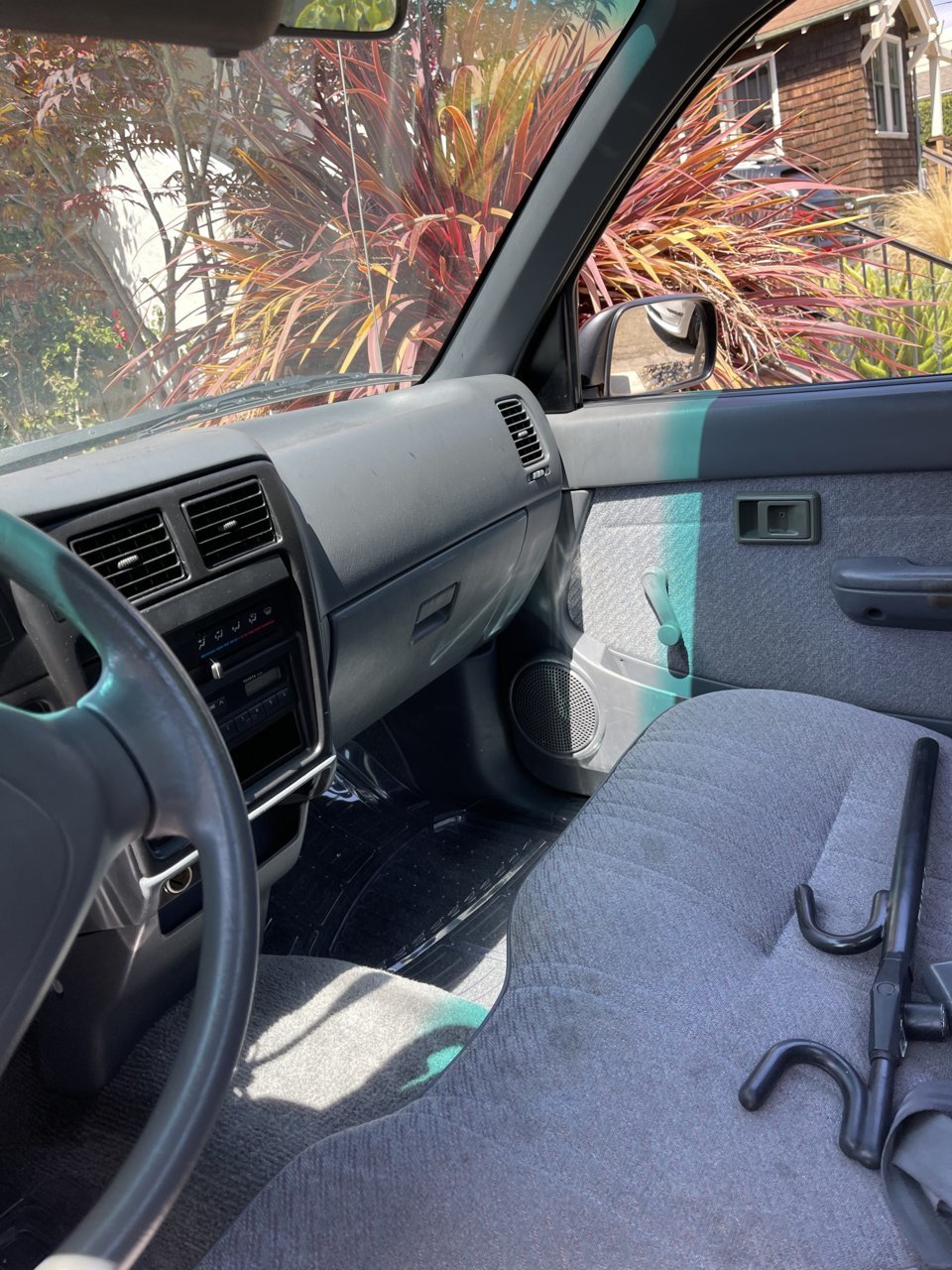

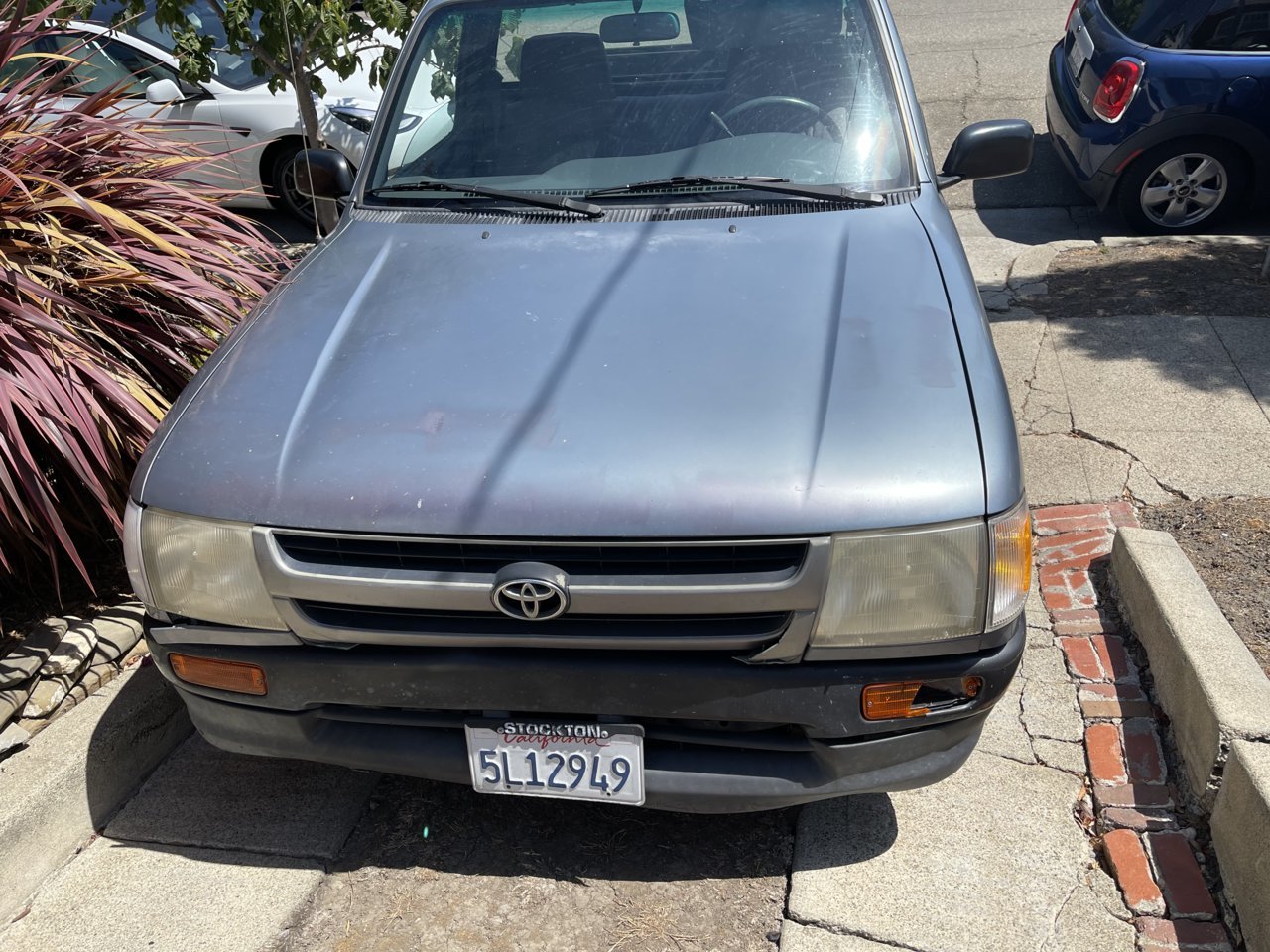

    8E487FCF-0064-4085-8757-10CCD13518D5.jpg Here’s a couple pics still learning how to reply on here so I apologize in advance for doing this wrong.This truck was definitely not sold to me as a project and I test drove it but haven’t drove one of these before so I assumed air in the steering line , brakes needed pads ,and I know the hood vibrates on most of these and I couldn’t see the cracked headers so it was my bad I was wrong on all accounts. The interior looks like 150 but the paint doesn’t so I’m confused on where this truck is really at as far as usage.It came with a matching camper shell as well thanks for the advice everyone I really appreciate it !!!

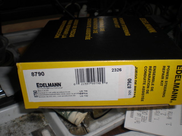

    As far as the steering rack, I've got the rebuild kit waiting for mine to fail....
    but would have to catch it early when it just starts to leak......

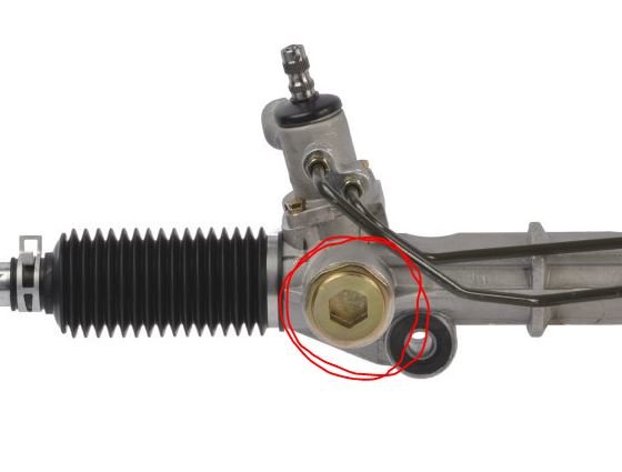

    If you replace your rack and pinion, I believe you should look for one that has this allen key'd bit in it.

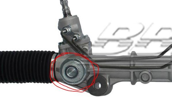

    And not one with this external hex head piece.
    The former one is the newer model less prone to failure according to an R&P rebuild thread on here. The latter one there with the external head is the older type more prone to wear and failure. Both are available on rockauto for a few hundred $$$.
    Others more experienced may correct me here if I'm wrong.
