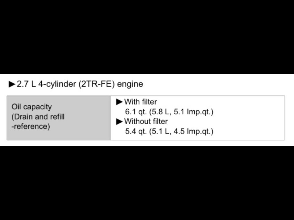

    Hey friends! Tomorrow I'm going to change my oil for the first time and I wanted to run my plans by you guys to see if I have all my bases covered.
    I have a 2011 2.7l 5 lug double cab.
    What I purchased for the change is as follows:
    - (2) 5 qt jugs of Mobile 1 0W-20
    - Toyota oil filter
    - Toyota washer
    - Fram filter wrench
    - funnel
    - catch pan
    Ok so my plans are:
    1. Unscrew oil cap in engine bay.
    2. Remove bolt in oil pan and start to drain oil.
    3. Remove oil filter.
    4. Wait for oil to stop dripping
    5. Replace oil pan bolt with new washer.
    6. Install new oil filter (after putting some oil on the seal)
    7. Add 6.1 qt of oil
    8. Run truck for a few minutes and check level.
    Am I missing anything?
    Is that the correct oil pan bolt pictured?
    Thanks for any advice!

    With the location of the I4 oil filter I like this style of filter wrench with a 8" extension. That Fram wrench may be tricky to get around the filter.
    And +1 for fumoto valve.
    I only add 5.5 quarts, 6.1 will overfill.

    Thanks for all the advice guys, it was a great success!
    The fram wrench worked just fine.
    It worked great. Didn't leak a drop!
    Haha because I wanted to be so OCD about my first oil change that I put in 6.1 qt on the nose.
    The mobile 1 at my wal mart was $25 for the 5 qt jug and $7.99 for 1 qt jugs.
    Plus I figured I could use the remainder 3.9 qt for my next oil change.
    After checking the oil level afterward it's really difficult to tell where the oil actually stops. It looks to be way over the full line.

    There always seems to be confusion on whether to add the amount of oil shown in the manual or to add oil to the full line on the dipstick.
    For what it's worth I go by the dipstick. I'd rather the engine be slightly low than overfilled and risk added pressures wearing seals.
    Either way I'm sure you're good to go. Following the dipstick is just my preference ;)

    From the Owner's Manual:
    "The engine oil capacity is a reference quantity to be used when changing the
    engine oil. Warm up and turn off the engine, wait more than 5 minutes, and
    check the oil level on the dipstick."
    So it sounds like they want us to use the dipstick to verify oil level.
    And I don't know that a high level will increase pressure. But if it is high enough for the crank to hit it, it could get whipped up which is probably not a good thing.

    Being the cheap, frugal old codger that I am, I use 5.5 quarts of Mobil 1. Two five quart jugs and a 1 qt bottle from Wally World gets me two oil changes at a very affordable rate. And 5.5 comes out just about right on the dipstick.

    Knew I should have stayed out of this. If either way checks good on the stick, what's the diff? And if you check the stick at 2000 miles and it needs oil, you add it. Personally I'm at 95K; I change oil and filter every 5K using approximately 6 qts. I say approximately because I'm usually pouring the last qt off a 5 qt jug. I verify on the dipstick and adjust as necessary. I check the stick about every 1000 miles roughly. I have yet to have to add any oil in between oil changes.

    My BAD, I started the controversy after OP like most of us found 6.1 shows way overfilled on the dipstick.
