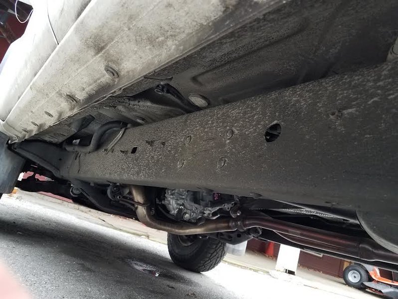

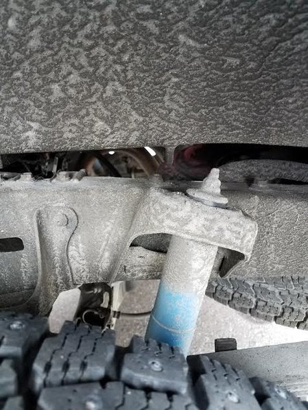

  17. Oct 27, 2016 at 7:44 AM
    #37
    backroadsvt
    backroadsvt Active Member
    May 1, 2016
    #185796
    40
    Cabot VT
    2017 Tacoma TRD Off Road M/T
    SR grill
    This is after three weeks of living on a dirt road in Vermont, the product is corrosion free. The truck has 3000 miles
