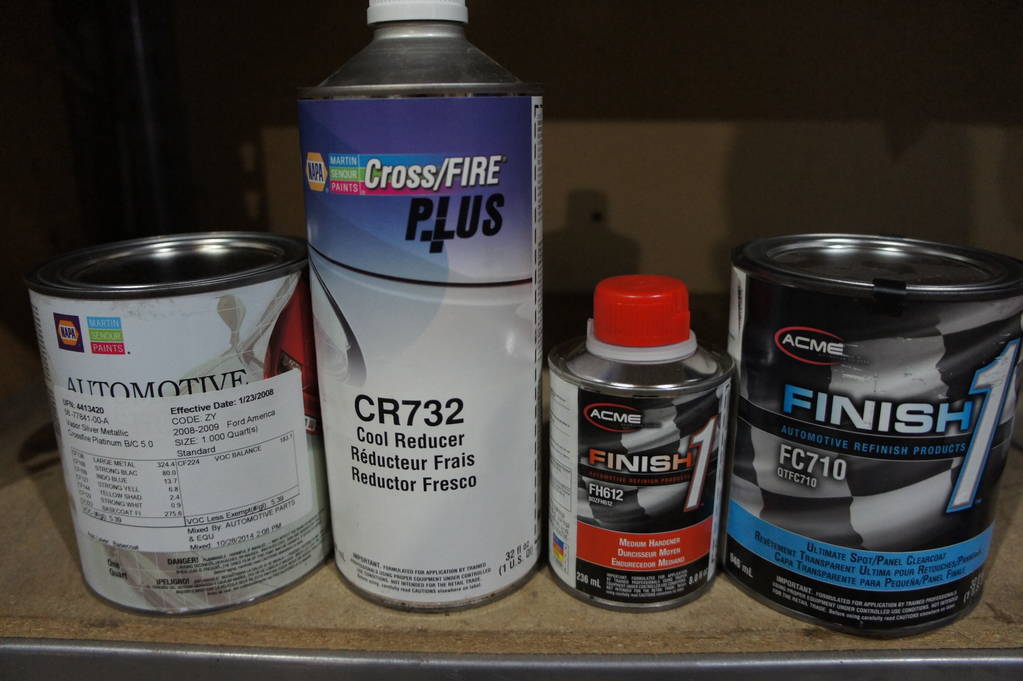

    Ok, so my grandparents had a fender bender. It was gonna be like $2000 for repairs, but F that. I bought a new bumper cover and fender for less than $250 and paint for ~$100.
    I bought the stuff at Napa and they gave me a couple sheets with some very basic instructions. I can't seem to find any decent info online as to what to do here. Plus, the sheets give drying times based on an ambient air temp of 70 degrees F. :rolleyes: We're looking at highs in the 40s this week. I don't know how much that will affect dry times, especially in between coats.
    The fender came pre-primed but the bumper cover is bare plastic. Do I need to prime the bumper cover?
