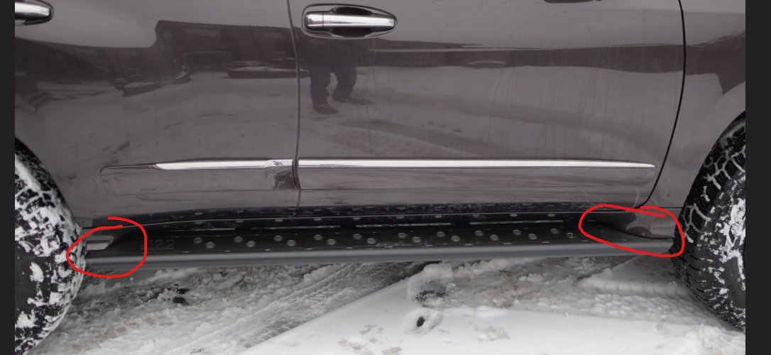

    I've been wanting to get sliders for the GX and the only sliders specifically designed for the GX cost $2,200 from the states after shipping, currency, and tax. Most of the less expensive sliders you see on the market for the GX are 4Runner sliders mounted on the GX, so they end up looking too short and unappealing.
    So I decided to make my own. I designed the sliders on Solidworks then had the pieces laser cut. The toughest part was working in an unheated garage in the middle of winter haha. looking forward to testing these out at Ardbeg and maybe the Algonquin trip!

    dude, those are absolutely mint.
    what metal did you end up going with all around?
    my only "worry" is where the body trim/ rocker panel(?) are against the sliders, but with how built it appears i dont think that's an actual concern at this point.

    Thanks!
    I ended up using 2" square 3/16" wall inner tube/frame extensions and 2" round 1/8" wall outer tube. The step plate and box ends are also 1/8" thickness.
    I hear yeah on the space between the sliders and trim, there's about 3/16" of space. I do think I should trim it back another 1/8" or more for good measures on a warmer day haha

    That's beefy. Most Taco sliders on the market use 1.75" x 1/8" wall round tube for everything.
