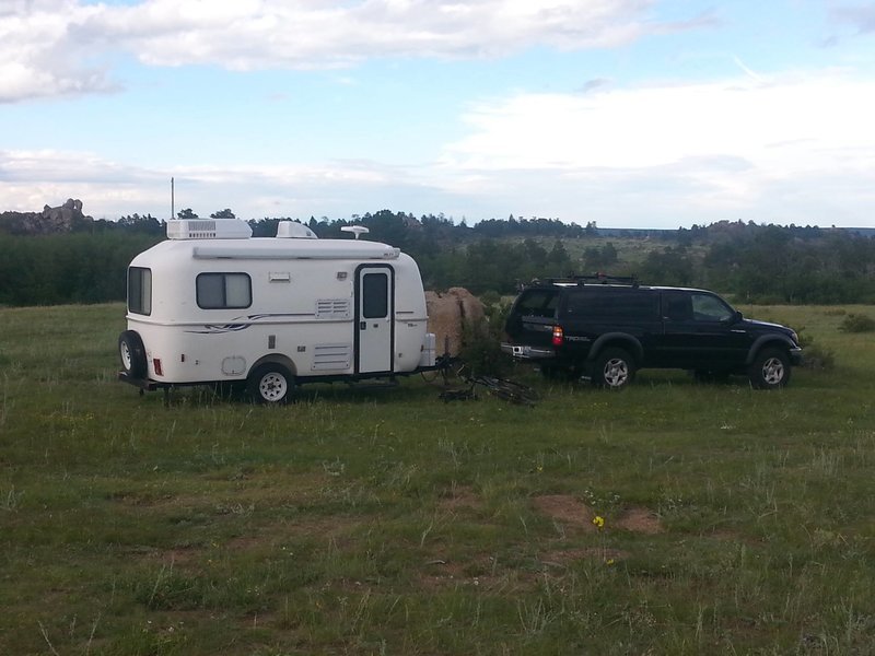

    OP, is yours a Freedom Deluxe like mine? I love my Casita. Got any pics?
    As far as power goes, any V6 in today's mid-size class is gonna hunt and rev more when pulling a trailer. When I pull my Casita with my 2002 I have to downshift to 3rd gear and rev to 4500 RPM's on some of the climbs out here in Wyoming. I am usually only doing about 45 mph in the process. The benefit of newer motors is the timing is much better and engines can run at higher RPM's no problem. It feels weird seeing the tach spike but that doesn't mean it's hurting anything. I test drove a Silverado 5.3 and when you put your foot in it, it too would shift to 4,000 RPM to get you some extra horsies.
