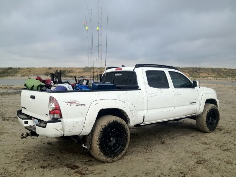

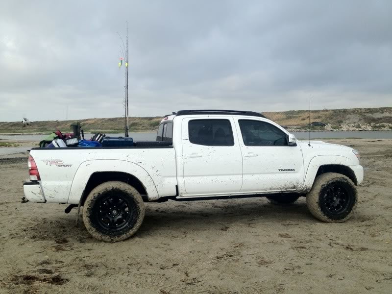

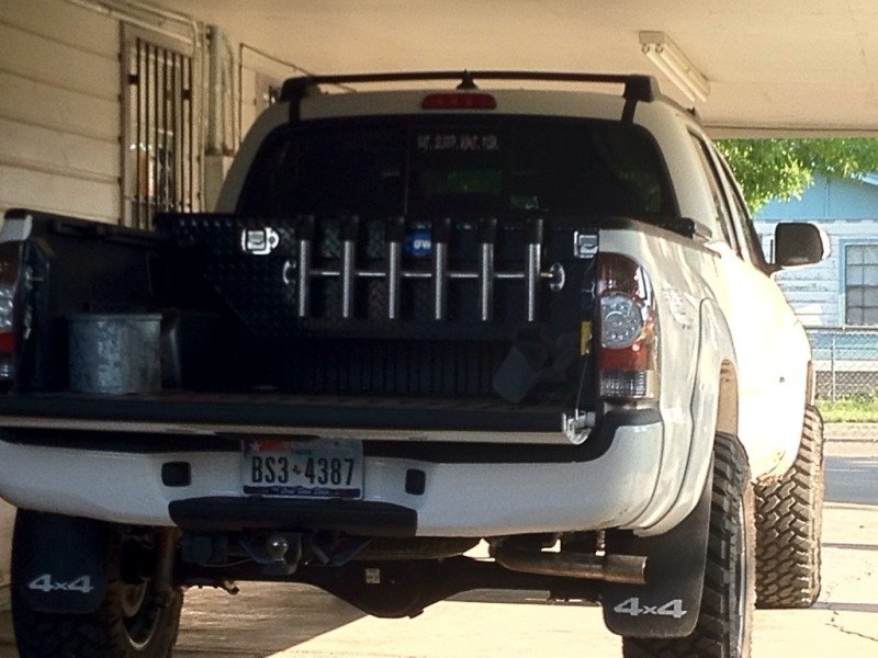

    Here's my solution...I've had these bad boys for at least 6 yrs...worth every penny of the $90 I spent.

    quite a rig you got man, looks awesome! heavy duty too.

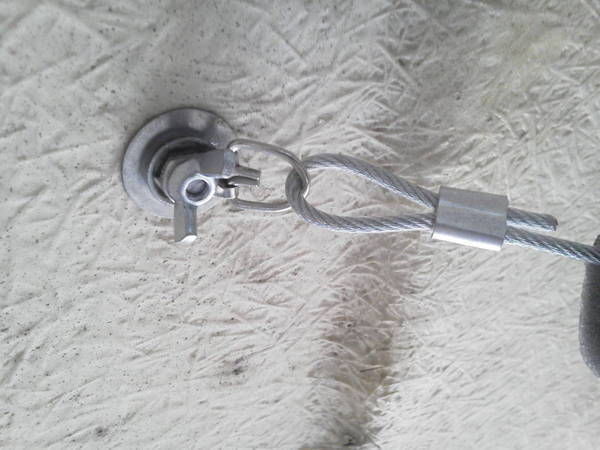

    I have a Thule Track that is thru-bolted to the roof of my cap. The bolts extend enough that I configured a way to attach aircraft cable from one side to another using d-rings and wingnuts. I put the cable through a length of pvc pipe and then foam pipe insullation over the pvc. I then cut out spots for the rods to sit into.
    its working pretty well so far, still trying to figure out the best way to keep them from shifting when hitting bumps/offroad.

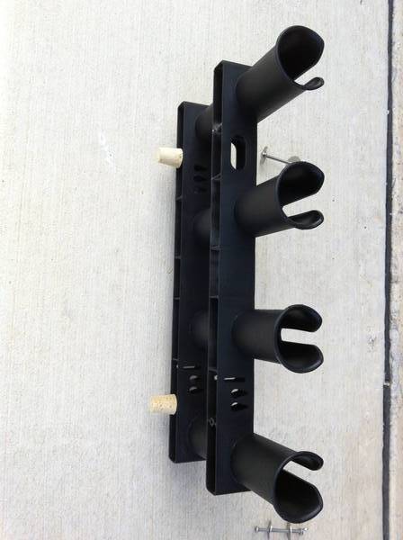

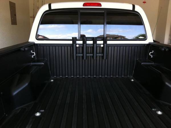

    Here's mine. This is first mod I made. Just got my truck last week and needed something quick for a trip this coming weekend. I bought a four rod holder from the local Bass Pro Shops and painted them black. (They didn't have them at the Walmart by me, so I probably over paid @ $25.) I just bought some stainless steel hardware at Lowes to mount it. I got one inch washers that I used on both sides. I angled the one end into the utility rail system and popped it in place and used a wing nut on the other side to secure it. It's really easy to remove when not needed.
    You can see it here before mounting where I screwed corks to the bottom. These keep it from bending in toward the bed wall:
    Here it is pre-assembled and ready to be mounted:
    Here it is mounted. It's a little off center because the corks needed to go into the indentions to fit. I may cut the corks to allow me to center if it starts to bug me.
    Here's the hardware I used:

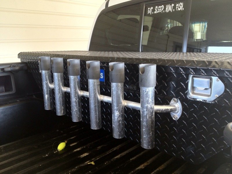

    she's real strong

    Did you make that or but it?

    all hand made

    Would you make one and sell it? Or tell what you used to make it?
