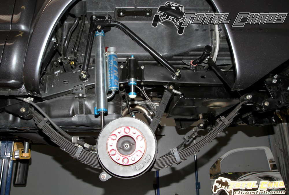

    Chaos used 14” bypasses on custom hoops on their morroco rally truck. 14’s under the bed are less than ideal. The mounts will hang lower than sua leafs and the shocks will end up about 1.5-2” off the frame. You’ll need proper tube layout, and a wider rear end or 2” wheel spacers(and still may run) 12” shocks fit much much better under the bed.
    Besides archive no one makes what you’re looking for it will need to be custom fabbed
    Here’s a pic of 14” bypasses under the bed

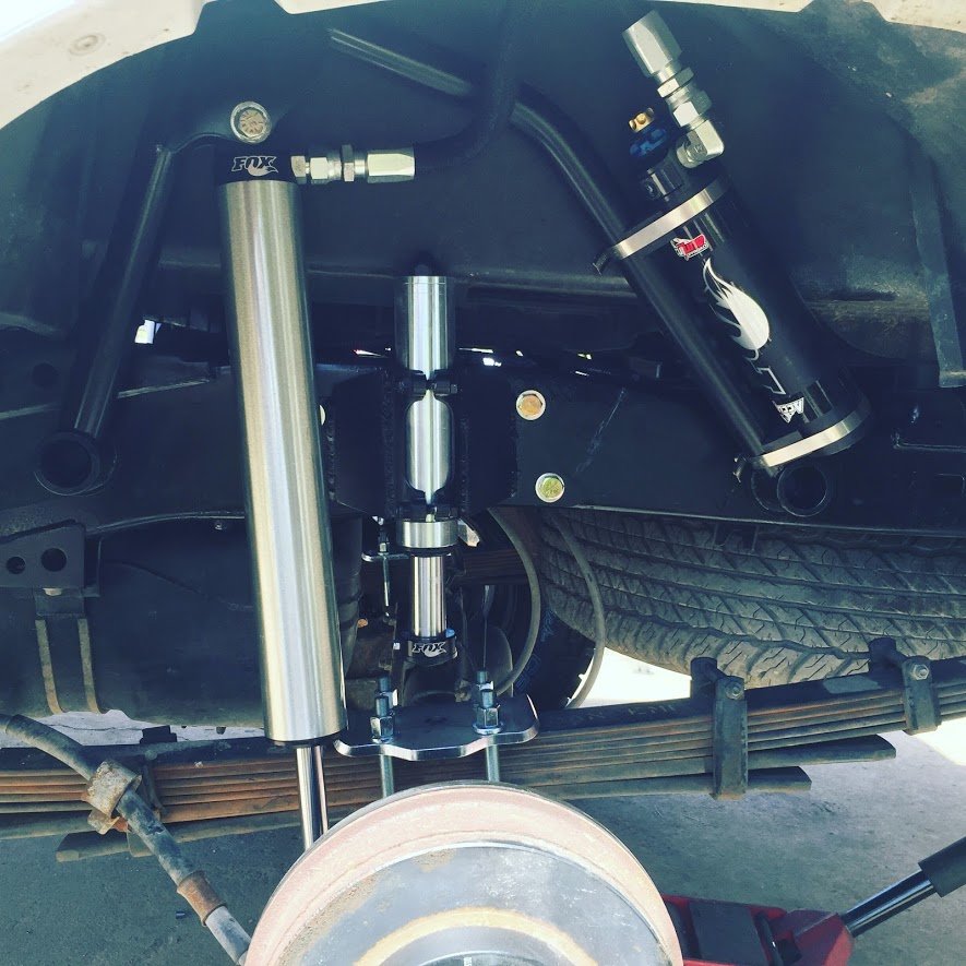

    i did 12" but could have fit 14" your best bet is to have some custom mounts made. Also, if you have a shell and a rtt, take a look at it when driving off road, that sucker moves a lot, i would recommend an internal cage to support the weight of it. I cracked my last shell due to that. And once you do that you can run glass fenders with no issues.
    I am also thinking about SUA just got get more room for the bump lol

    Are those the tc or custom hoops?
  15. Aug 12, 2018 at 3:33 PM
    anomalyTRD
    anomalyTRD [OP] Well-Known Member
    Jul 12, 2013
    #108160
    294
    Oakland, CA
    2019 Ford F150
    VO Nomad
    Those look like custom hoops to me.
    Slvr14tacoma likes this.
  16. Aug 12, 2018 at 4:52 PM
    #16
    paranoid56
    paranoid56 Well-Known Member
    Jul 25, 2012
    #83443
    3,444
    San Diego
    14 double cab taco
    yes, just a custom one i made that i mimicked the TC one
    yep :D
