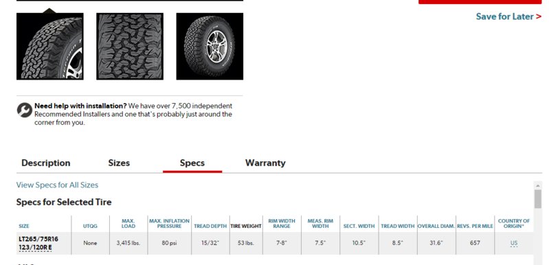

  10. Jun 13, 2017 at 8:39 AM
    eccracer104
    eccracer104 O.G. Member
    Apr 9, 2008
    #5854
    14,169
    San Diego, CA
    2016 Tundra 4x4
    Cool little trick here, tire manufacturers list a thing called "approved rim width range" which will tell you what width wheels are safe to mount that tire too.
    Like @JimboAnz mentioned this info can be found on the manufacturers site. Bfg's site isn't the cleanest because you have to download a huge document to get the info needed, but tons of other site list this info too, like tire rack for example.
    DustStorm4x4 and JimboAnz like this.

  12. Jun 13, 2017 at 8:42 AM
    Jamestaco17
    Jamestaco17 [OP] Active Member
    Jun 13, 2017
    #221397
    25
    2013 grey access cab sr5 prerunner
    3 in lift 32 ko2 tires blue interior led limo tint
    They can only fit a width of 7.5 so it looks like I can't fit 16x8
  13. Jun 13, 2017 at 8:44 AM
    DustStorm4x4
    DustStorm4x4 BBC 2020
    Jul 2, 2015
    #158634
    8,931
    U S A
    04 Jeep LJ
    Rim Width Range = 7"-8". You'll be fine.
    JimboAnz and eccracer104 like this.
  14. Jun 13, 2017 at 8:46 AM
    eccracer104
    Apr 9, 2008
    #5854
    14,169
    San Diego, CA
    2016 Tundra 4x4
    ^ What he said
    meas. rim width (measured rim width) is the width of the wheel used when they took all the measurements for the tire. rim width range is 7" - 8" you're 100% safe with a 16" x 8" wheel.

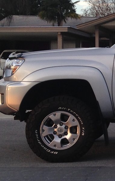

  17. Jun 13, 2017 at 8:58 AM
    #17
    Jamestaco17
    Jun 13, 2017
    #221397
    25
    It also says it has a bolt pattern of 6 by 5.5 is that what I already have IMG_1094.jpg

  19. Jun 13, 2017 at 9:14 AM
    #19
    3coma
    3coma my kid says my truck is "Boss"
    Sep 19, 2015
    #164680
    1,067
    rob
    19 dcsb sport cement 4x4
    You'll get a slightly wider stance and should look good. About even with the flares, to a hair outside.
