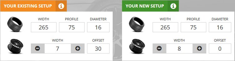

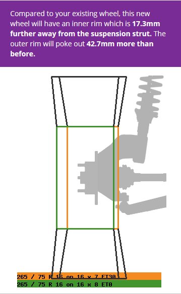

    Because the wheel is an inch wider than stock and has a lower offset than stock. Offset/backspacing controls the positioning of the wheel in the wheel well. By having a 0mm offset it moved the hub mounting location to the center of the wheel vs the stock wheels which have it located more towards the face of the wheel. In turn this moves more of the wheel away from the suspension creating more clearance between the spindle/uca from the tire. Its a great fit for our trucks because the wheel and tire end up flush with the fender and there's enough inner room to fit larger tires.

    This is a fun tool to use to compare the before and after. You just plug in your specs. upload_2017-6-13_9-30-8.jpg
