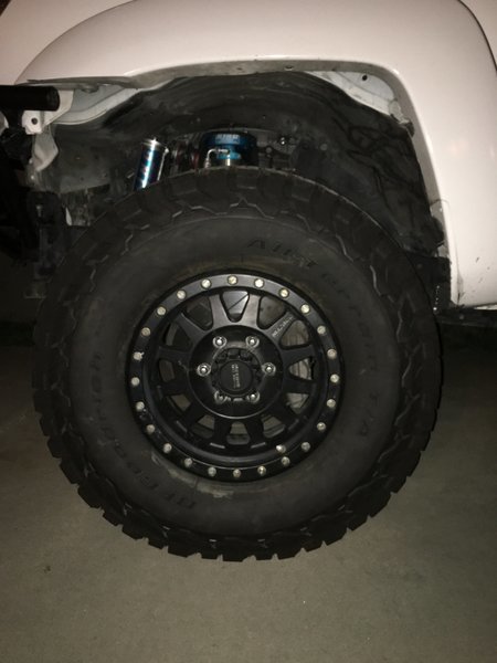

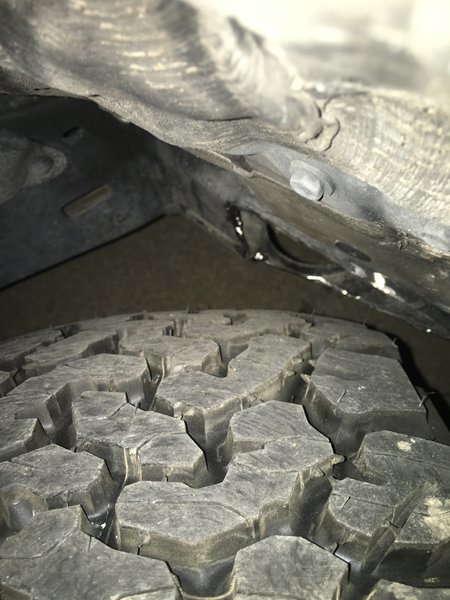

    I had 5100s @1.75 and stopped at 265/75/16 with method standards removed mud flaps and was ok... now I have 285/75/16 KO2 with tc uca kings and wheel spacers... Cmc, pinch weld flatten and still rub... no one true answer fits all for ur question just keep pounding and cutting mine still rub IMG_4181.jpg Probably going to chop a little more
