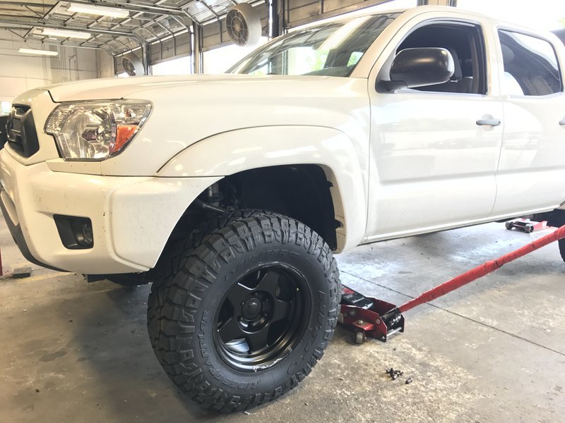

    Tac0caT
    Tac0caT Icon Stage 4, Dakars, Pelfreybilt Sliders, CVT
    Jun 10, 2014
    #131691
    14
    Joe
    Salt Lake City, UT
    13 TRD OR
    Icon Stage 4 Dakars 285/75/17 SCS F5's CVT MT. Shasta Pelfreybilt Sliders
    I just put on some 285/75/17 ridge grapplers with some SCS F5's and they fit great with caster around -3.6* with icon stage 4 lift. They barely nick the cab mount at all. I will still have the CMC done for full stuff at full lock and have done some moderate trimming so far. Too early to tell what will need to be done after taking them off-road. The offset of the F5's is the absolute sweet spot for these tires in my opinion.

  9. May 30, 2017 at 9:37 PM
    #89
    jg805
    jg805 Well-Known Member
    Feb 16, 2016
    #178431
    117
    My 265/70r17's rub in reverse with a 2" lift.
  10. May 30, 2017 at 9:38 PM
    #90
    jg805
    Feb 16, 2016
    #178431
    117
    Hard to believe they would fit on a stock rig.
  11. May 30, 2017 at 9:38 PM
    #91
    jg805
    Feb 16, 2016
    #178431
    117
    Could be the backspacing on my SCS F5's though.

  13. May 30, 2017 at 9:42 PM
    #93
    Tac0caT
    Jun 10, 2014
    #131691
    14
    Joe
    Salt Lake City, UT
    13 TRD OR
    Not stock. 3" lift. And what backspacing are your F5's? Mine are 4.3"
