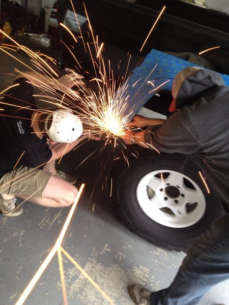

    A torch and a prayer

    Your gonna have to do the cab mount chop.

    cut the pitch welds and do the cab mount chop.
    i had to cut the cab mount with 285 and now that i run that 315s i had to cut the cab mount again but i have long travel suspension tho.

    Cut the cab mount, flatten the pinch weld, and probably have to cut your fenders.

    I'm sure some locals would help ya. It's not bad. Cutoff wheel for the cab mount, sledge hammer for the pinch weld, and jigsaw for the fenders

    Just look up Tacoma cab mount chop and I can send you pics of the pinch weld tomorrow

    been searching the forum, is it necessary to cut the fenders? That I defiantly dont want to get into.

    You'll atleast have to cut the backs of them, and that's with aftermarket UCA's
