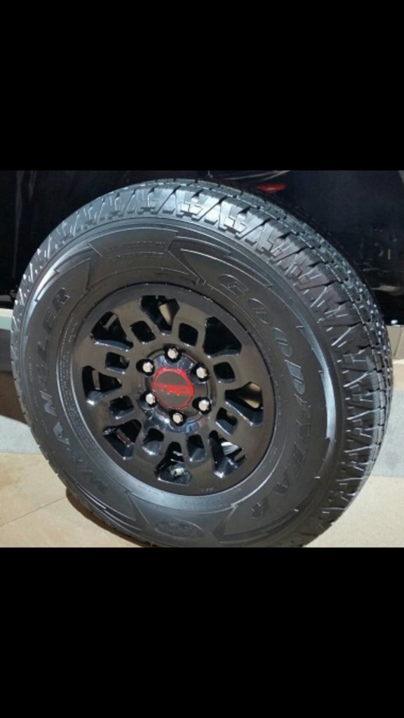

    Welcome to the forum. Take some time and look around. Lots of good information to be found. Those are stock wheels from the TRD pro and they are gloss black. They are not available in matte you would have to have them powder coated if you want them matte or any other color.

    There is no way that's a -13 offset. You can tell it's not even close to that in the picture.
    Definitely positive offset which is less likely to rub.

    If it's this video then yes they are the wheels but they are not available in matte black. Specs are 16x7, +13mm offset and 4.5bs.

    They are a +13 offset and supposedly do not rub according to that video and a couple people on Instagram I've found.

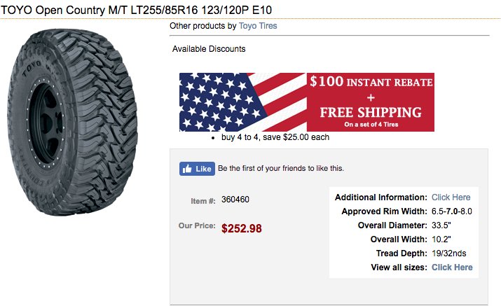

    I too am curious as to how those will fit, as I am looking into that same wheel. If they do fit that would be awesome, or I was also looking into the Toyo Open Country MT in 255/85R16 on that same wheel. The only thing that has me really concerned is that the Toyo MT is 33.5" tall. Not really worried about the width, as that should not be an issue.

    +13(not minus) sounds much more likely.
