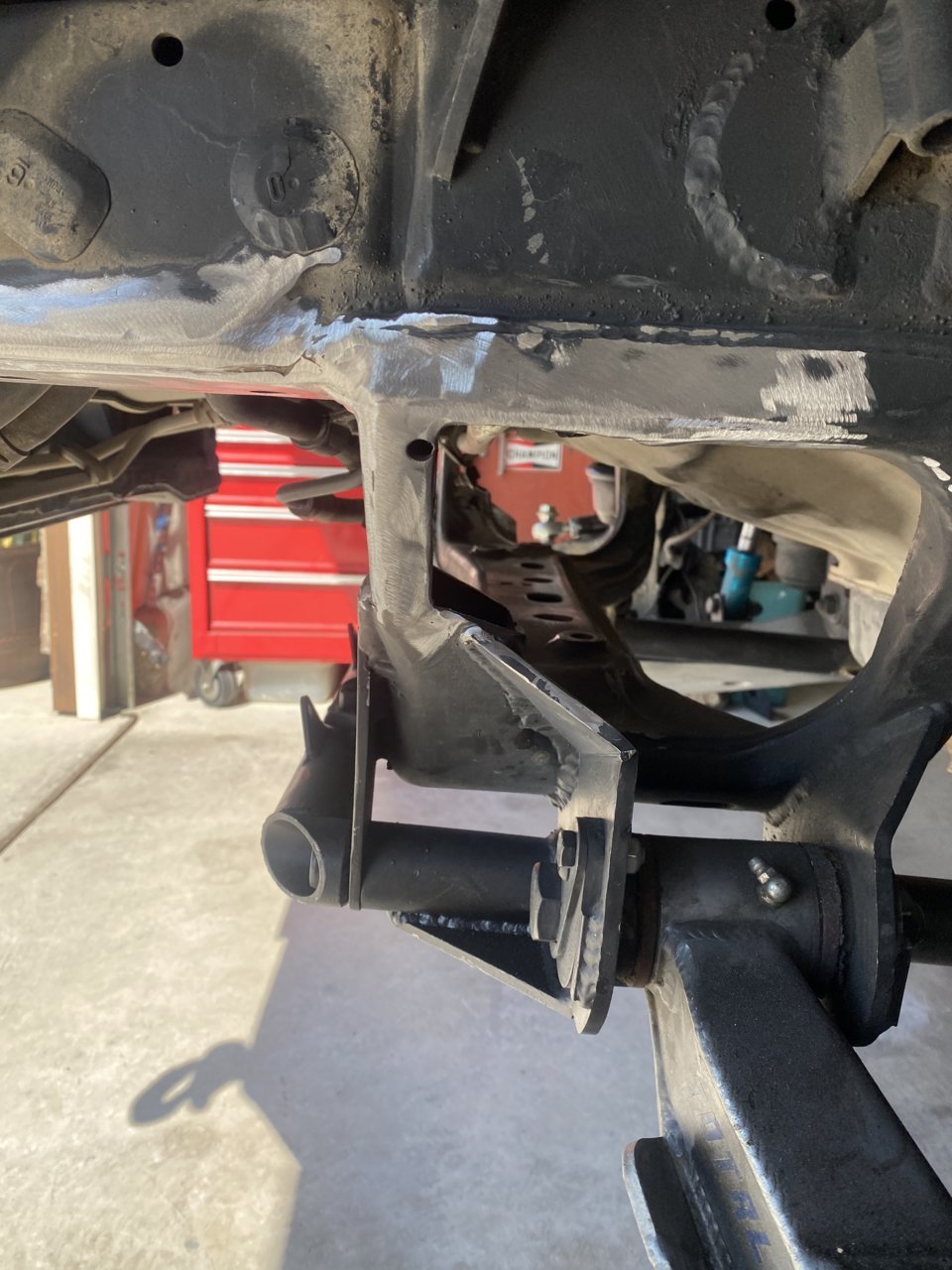

    Anyone else doing some cutting this weekend??
    jdiola, Torspd, llibrm and 7 others like this.

    I’m planning on cutting this exact spot this weekend. I told Ze he can learn on your truck first haha.

    In about an hour he will be learning. Lol
    oni06 likes this.

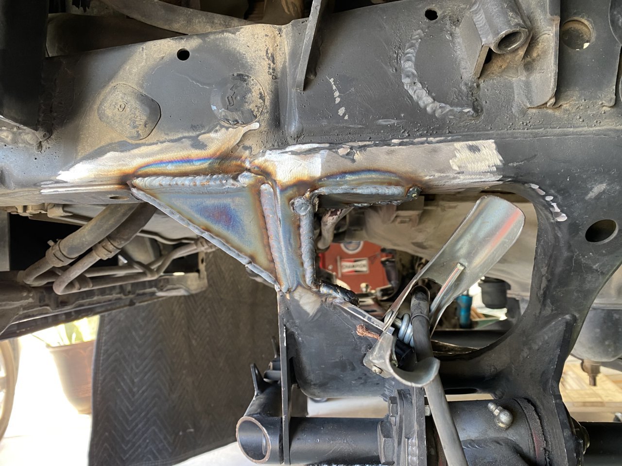

    All welded up. Gonna finish it up tomorrow.
    whatstcp, NcTaco27, Slashaar and 11 others like this.

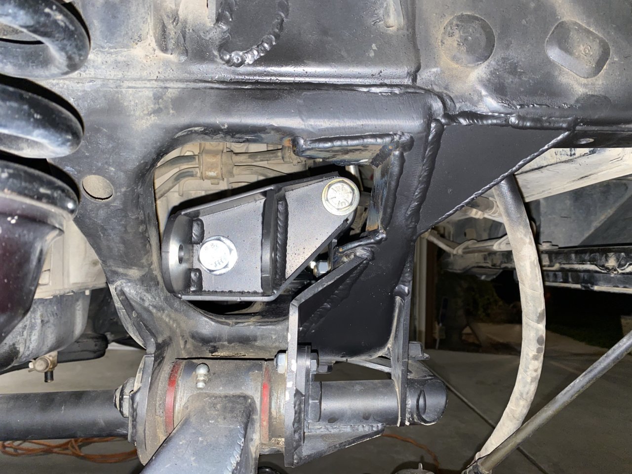

    Install of the slide rack is complete. Everything worked out perfectly for me. Not going to clutter this thread with my pics....Go here to see pics on my build thread
    Torspd, whatstcp, Slashaar and 6 others like this.
