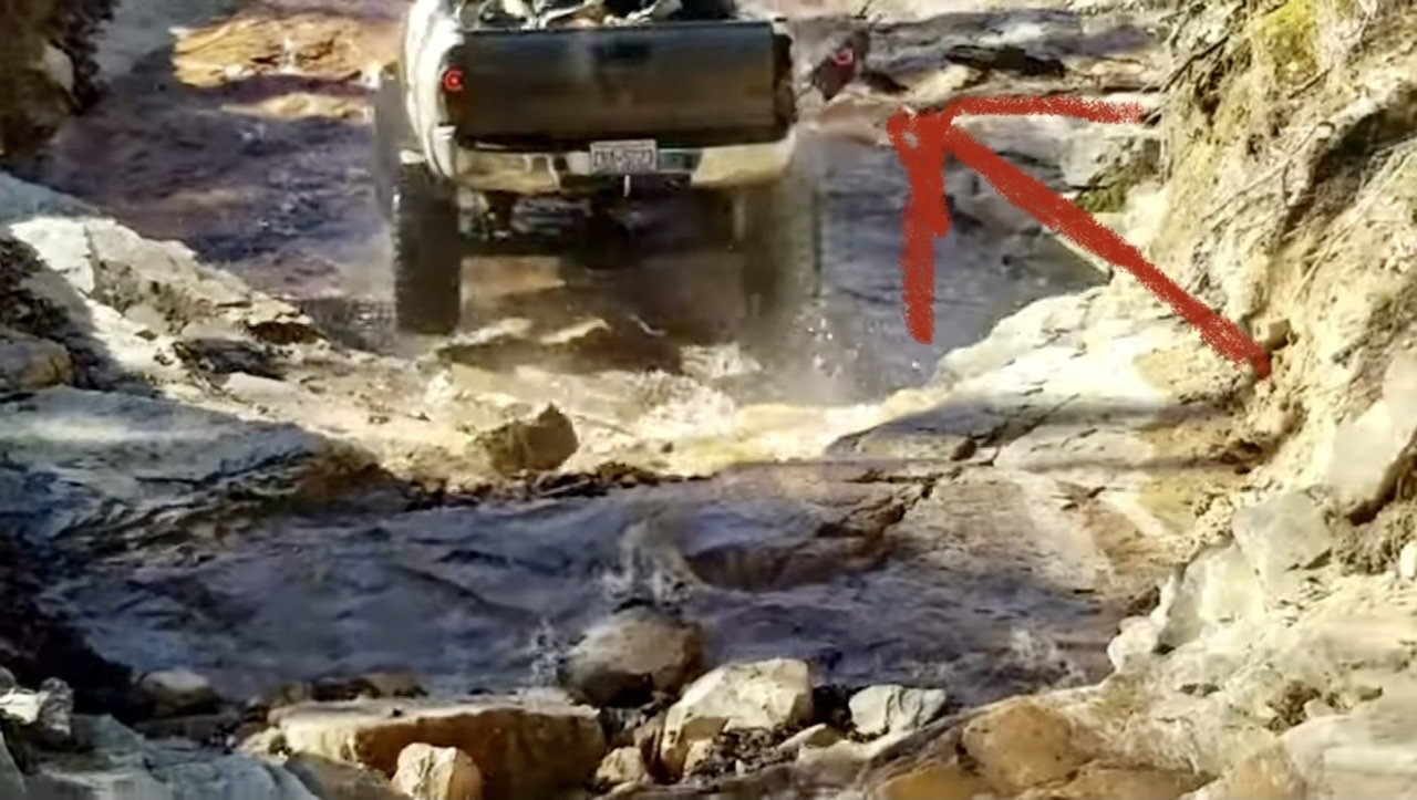

    How are its tail lights attached though? Toyota really screwed the pooch on the tail light assemblies in these trucks. How could it just eject itself under normal driving conditions like that?

    because plastic. ill venture to guess it didn't have the bolt and was only on with the spring/ tension pins

    Pretty much but the video show's the true nature of how it got ejected. Yes that tail light was damaged prior to that and the bolt parts were broken off. That whole side is a wee bit pancaked from riding a gulley.

    They've popped out a time or 2 :anonymous:
    Nice stoppage of the video and screen capture I'm keeping this for later :thumbsup:

    I mean his axle housing bent on that run too but damn that tail light should have held on.
    https://youtu.be/AKjvQgnfyd8
    Also, that’s Skip not me Jonny thought it was my silver truck.

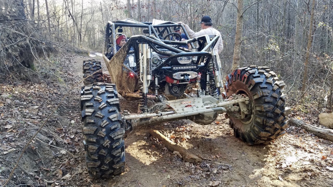

    Can my taco haul this? :anonymous::anonymous::anonymous:
    only a short two hour drive from here and a cool 80k brand new. Tail lights even have heims and are non-ejectable. I’ve heard no trimming for 35’s either, but who knows if that’s true.

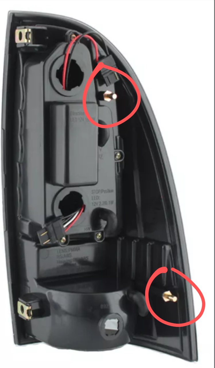

    One of the problems with the tail lights is that folks sometimes use the wrong screws in them. There are two different length 10mm’s in the tailgate jamb area and if you use the longer ones in the taillights when you tighten them they bottom out and then you break the tab off of the taillight. After that all it takes is a good bump to make the taillight fall out…ask me how i know
