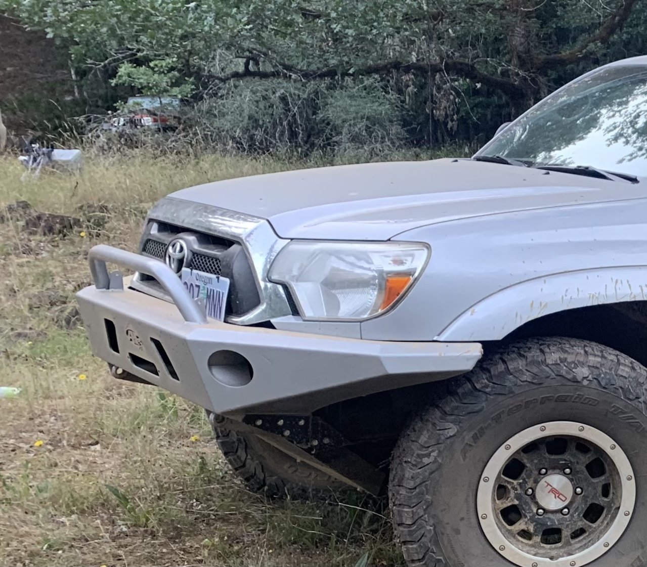

    A190B0D5-BF7C-4980-9F81-0DE8B6937222.jpg I used an all pro front bumper with out the bottom piece that comes with it. Built some brackets that tie it in to the frame and added some bolts in the middle to rivnuts in the new crossmember I welded in. Doesn’t hang down any farther than the frame rails.

    I hate the 2 piece design that allpro comes with, I might have to copy this

    I prefer plate bumpers and knew I didn’t have the time or patience to build one I would be happy with right now. I believe they also make this bumper in aluminum. I don’t have a way to weld to AL if I needed to do I stuck with the steel
