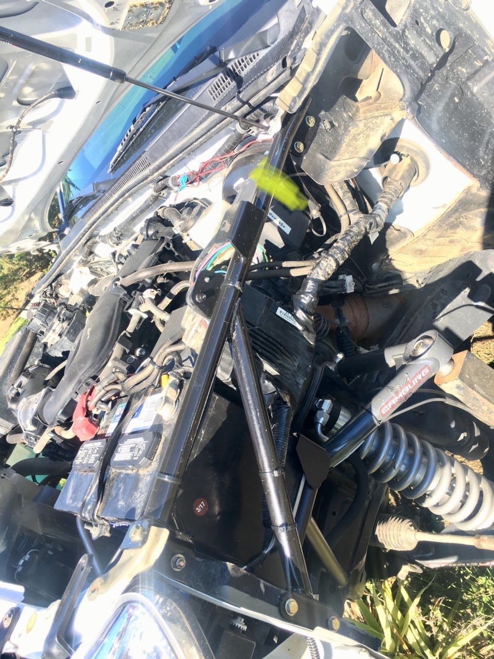

    You cannot stop the frame from flexing different from the body on our prerunners. They must move independently from each other or we'll have bigger issues. Yes, you can do a full blown cage and try and tie it all together but somewhere it's going to be a weak point and flex and crack. What you can do is think about the forces. I'm talking for pre-runners in general with flexible (rubber) body mounts. Think about the cab moving independently from the frame and look at how far the radiator support sticks out front with little or no support (fender wells). I looked at where my radiator support and fender wells were cracking/cracked. I reinforced my new radiator support in the important areas...mount to frame, 4 mounts to radiator, and hood support (I had already lost my hood latch so I have hood pins going into the top of the radiator support). To keep it flexible I drilled out the spot welds and used 1/4" bolts. I cut the fender well out where the tire was rubbing and left it out. I then came in and formed some aluminum panels in the missing areas and pop riveted them in, again, so they flex. Back to the top of the radiator support. I tied that into the inner fender wells and up to the cab where I came out with another plate and a bushing to tie them together so they're tied together but allowed to flex. Finally I went across from fender support I made to the other side with a tube and tied in 2-more hood pins. 9-years and still going strong. I lack pictures but above is my basic write up.

    Something like this but a bushing where the yellow line is. Most of my fender liner is there also.

    Would be fun till the sudden stop at the bottom

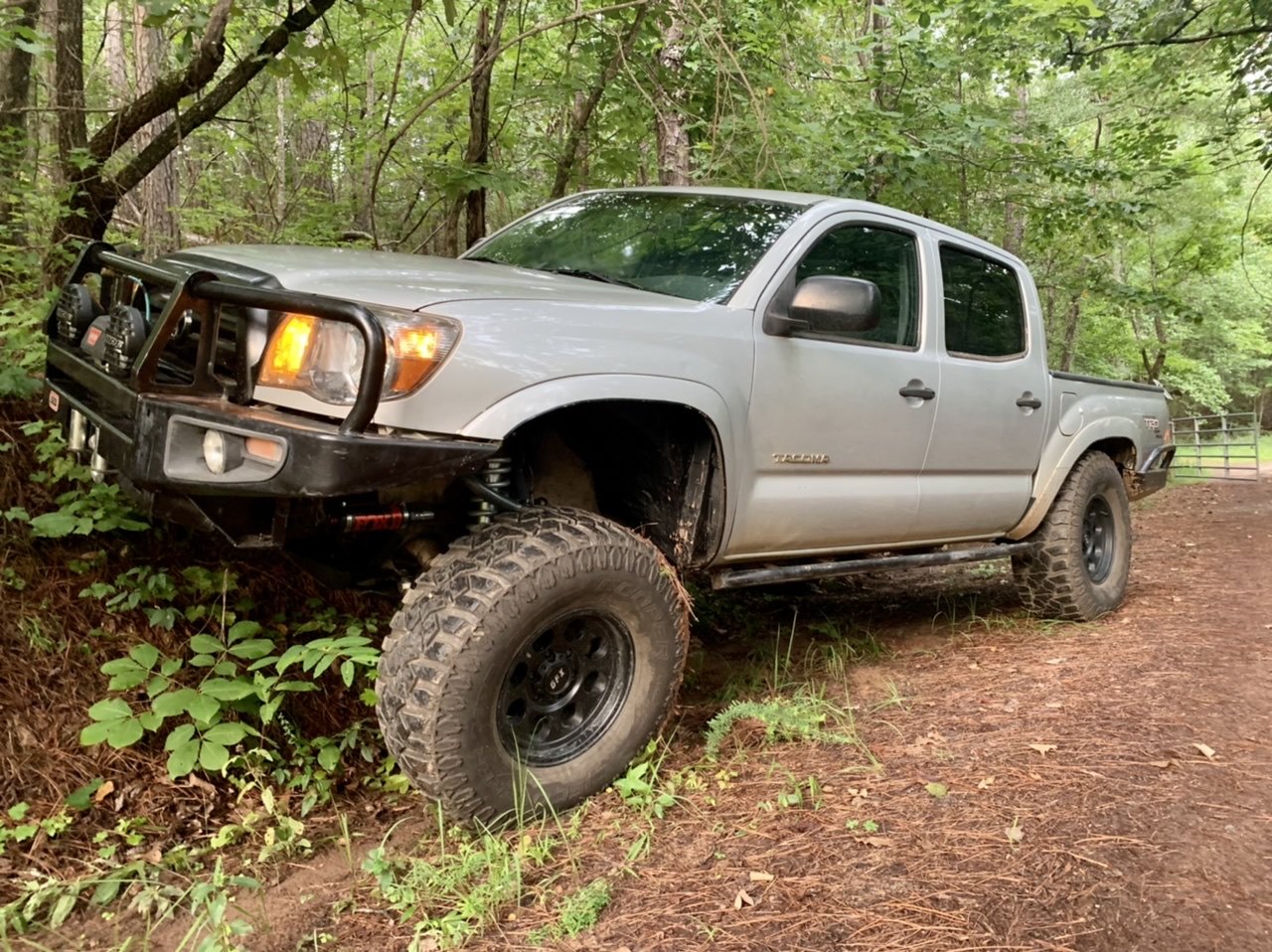

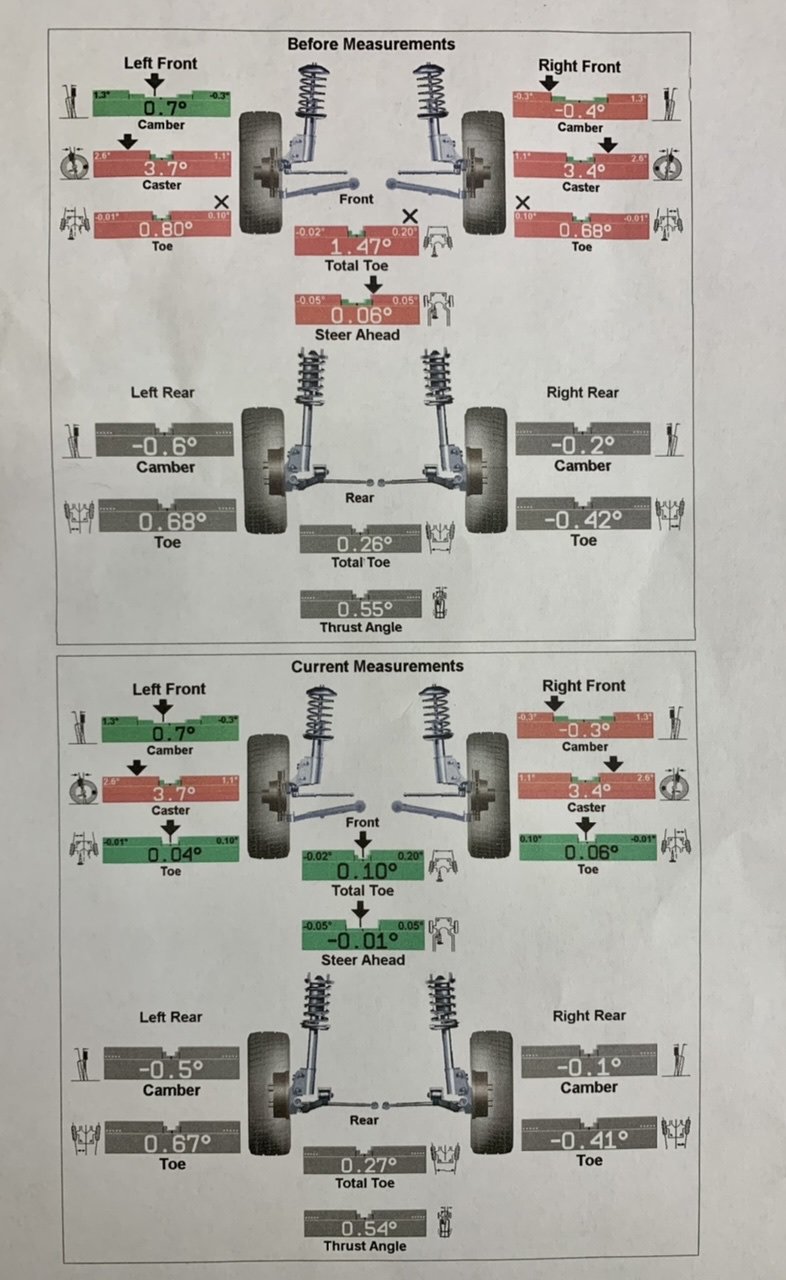

    Aside from the coil bucket gussets, all is done. 16” 600 lb coils were the ticket. I did end up trimming between 0.25-0.5” off of the inner tie rods to get the toe in check. This was my first shot aligning with the taco tabs, I could probably get the drivers side a little more negative camber, but I’m not worried about it. Even if this is as good as the alignment gets, it’s a good trade off knowing it won’t get knocked out every time I sneeze too loud.
    this is nowhere near flexed out and I was still strapped high when I took this. I’m not much for photo shoots. It’s the best ride I’ve ever had in the truck. @81Trekker has done an incredible job with this kit. Ready to see what all it can do!

    Glad you were able to get your toe worked out. Those numbers look just fine.
