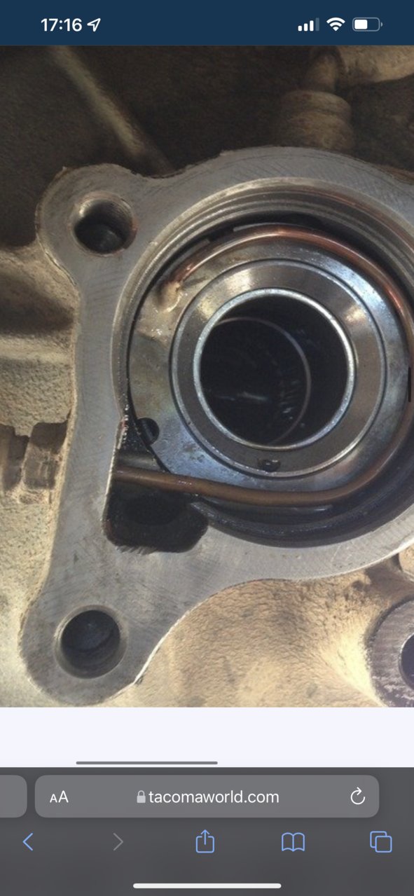

    It has to be from the passenger side needles. It’s funny too is at one point my 4x4 got stuck. I was able to pull over and rock the truck forward and backward and it finally disengaged.

    I wonder if the ECGS bushing would work on that side or not? This is the first time I’ve seen a passenger side fail. Has to be what it is though.

    Does no one pay attention the PS doesn't have a needle bearing. I even linked a thread that shows the pictures

    I’m pretty confident it does, the stub for the ADD rides on it.
    And FWIW, it looks like the bushing would work as the numbers are the same.

    Exactly. It’s not on the literal passenger side of the add tube.

    In that picture you’re just seeing the side gear splines. That’s an ARB and they run a bushing on both sides. But if you have a stock carrier you 100% have a needle bearing on that side as well. Toss a bushing in and call it a day.

    My mistake. Thought that was the needle bearing but yeah they should have one on both sides. It had to come from that side as my driver side bearing was long gone. We’ll see what the damage is tomorrow.

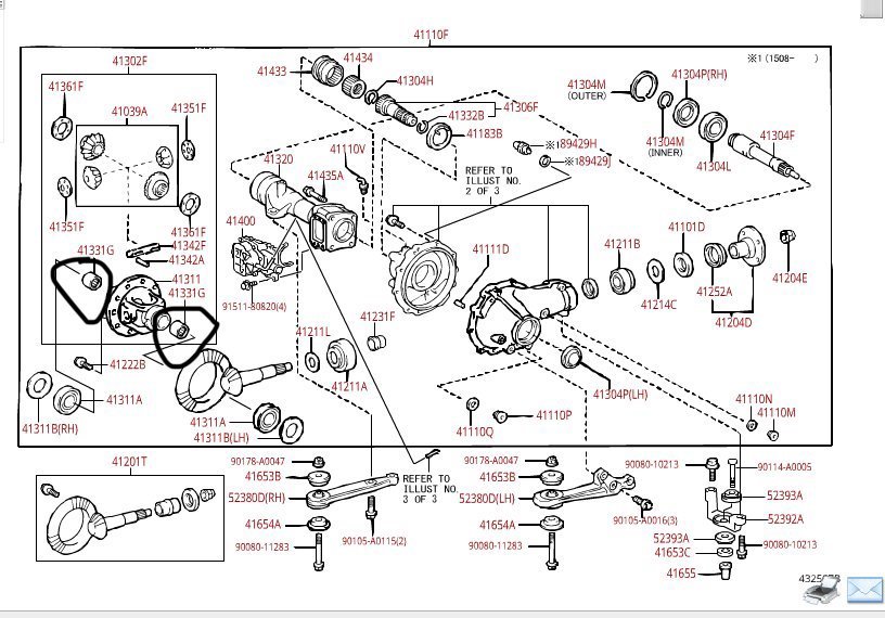

    Well I'll be damn ok I stand corrected.
    If they fucked that needle bearing up that's pretty nuts. Time to upgrade to an ARB and not have to worry about them anymore.

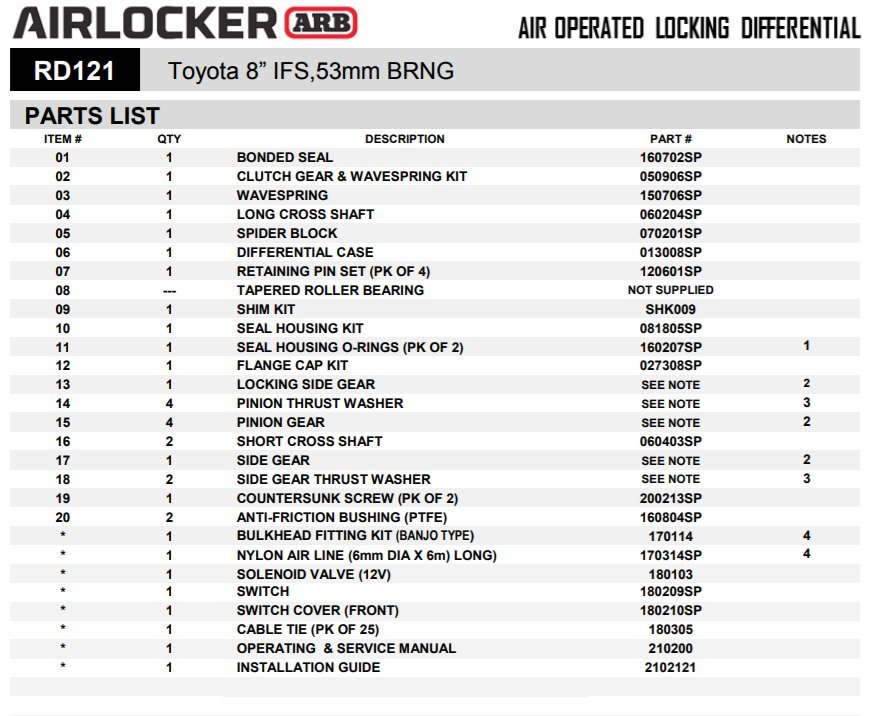

    Looks like #20, Qty 2 which seems to mean the passenger side needle bearing gets replaced as well. Arb ftw

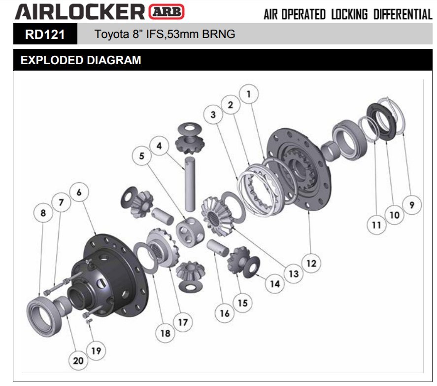

    The harrop uses a different style bearing too, but looks like its still a kind of needle, just beefier.
    I did just read the Harrop install requires grinding out parts of the housing, does the ARB require anything more than drilling a hole for the air line?

    http://gearinstalls.com/Clam8CJ2015Taco.htm
    Pics of basically step by step. Looks like very minimal grinding.
