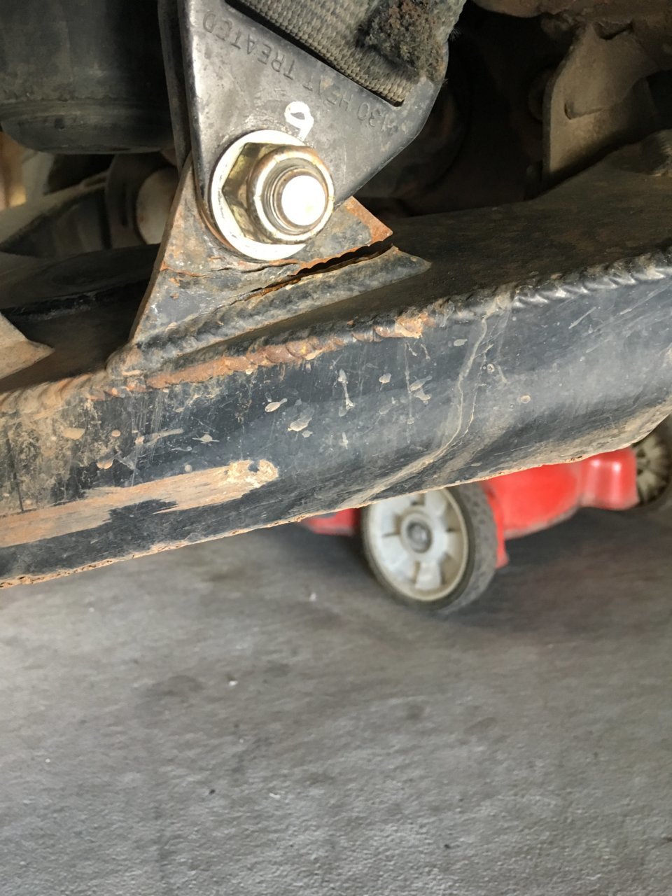

    Am I too late to enter the damage challenge? Noticed this crawling under the truck today.
    I guess 2.5 years of smashing through dirtbike whoops finally caught up to me. This was the only thing I didn’t like about the dirt king kit. But now it’s nice and double shear as it should be.

    Are you saying that because it double sheared
