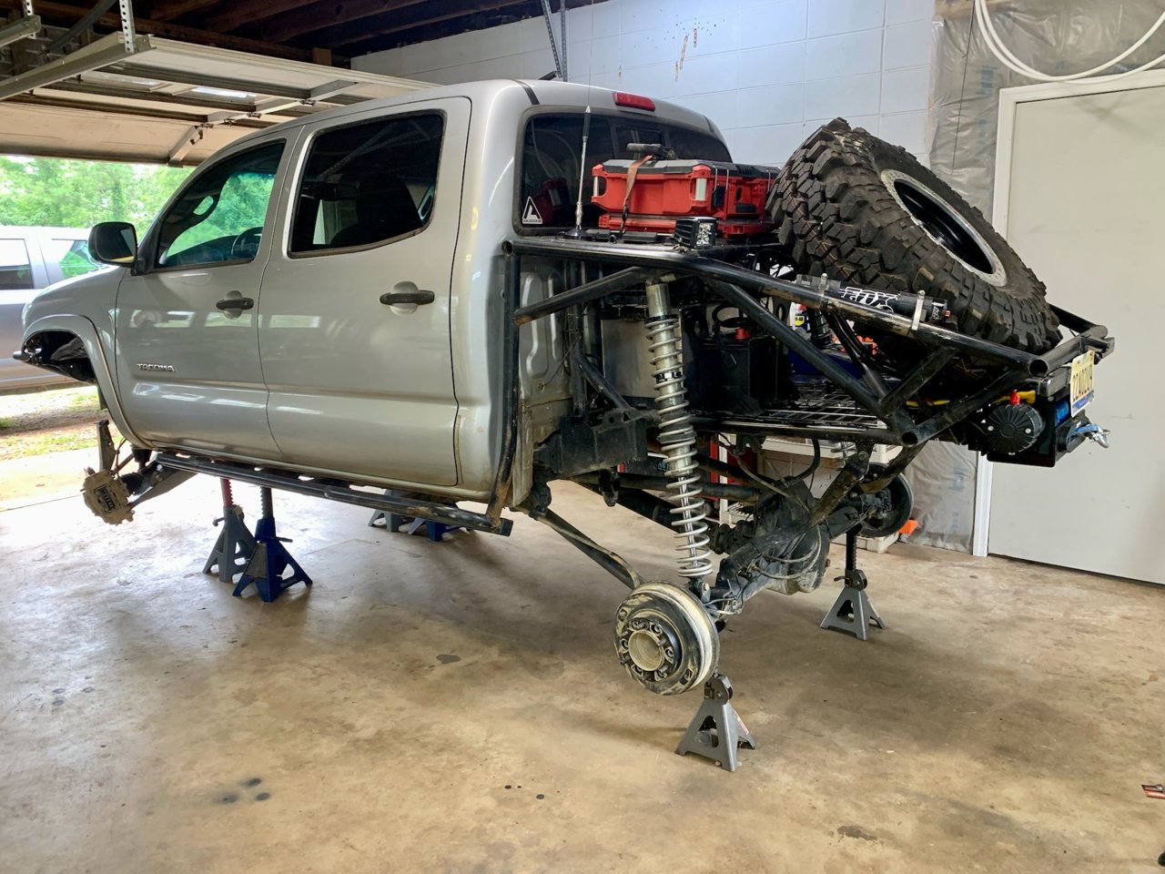

    Are your rock sliders tied into something right behind the cab where the round tube connects to the square tube?

    Yeah I’ve got it tied into the tube bed. Really helped unify stuff.

    You need to make sure you grease the shit out of all the cam hardware and spacers that way the truck can be aligned without a ton of force

    copper work hardens so in a pinch you can anneal them with a torch to soften them back up for good sealing.

    So I guess JD Fabs kit can only handle 285s according to big mike over in the RCLT thread.... o_O

    4 link or 3 link? I assume 4.

    Only and always a true 4 link, we will not do anything else... ever

    My 3rd gen comfortably clears 315s with the JD +4 LT kit, LCA Pivot Kit, Inner Fenders, howe steering & SUA.
