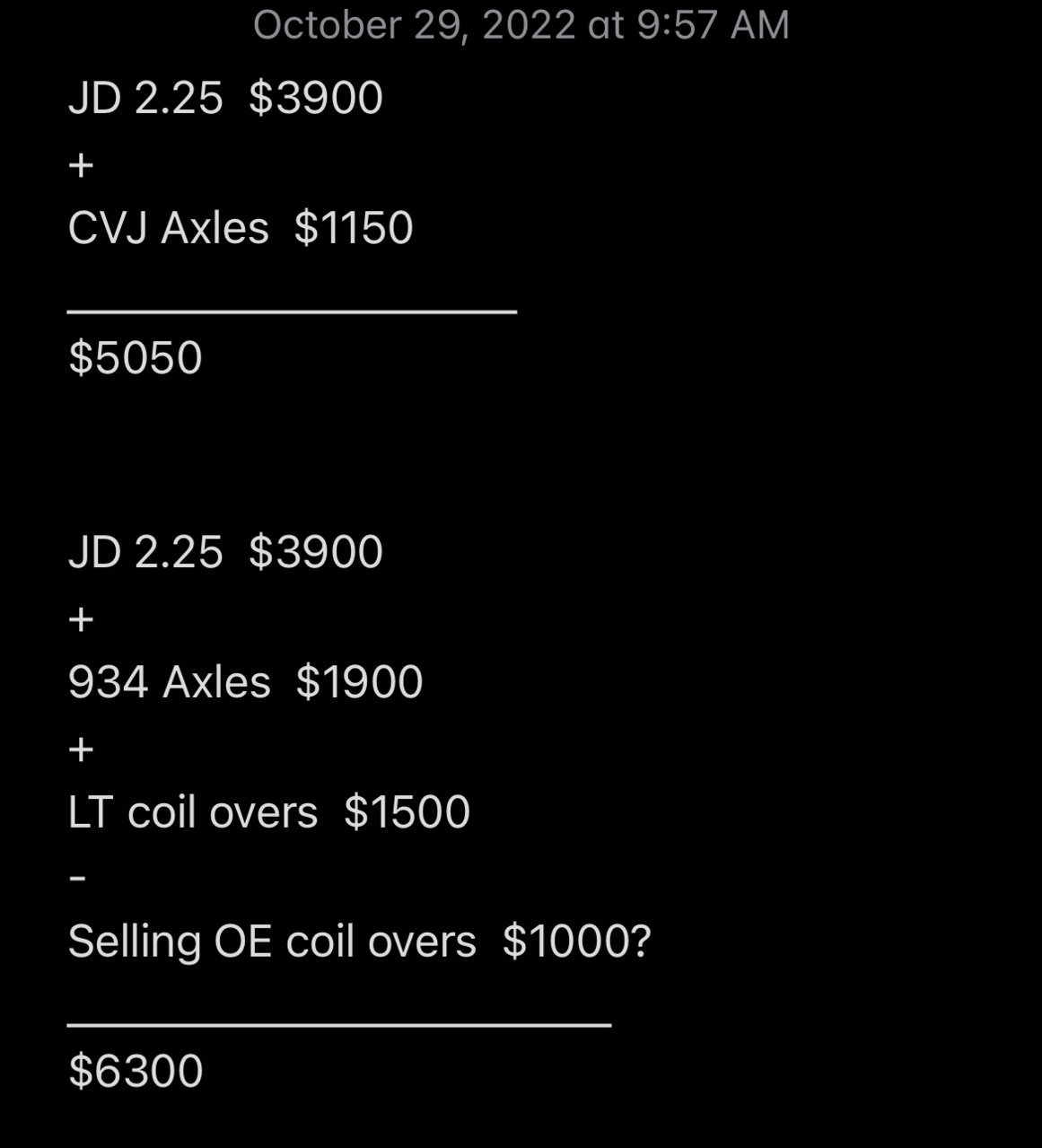

    In the endless battle of "Should I LT or not", I am just trying to run all of my price options through.

    It all depends how crazy you go. Could do a bare minimum LT build with 934’s for probably 6-7k. My last MT front setup was damn close to that. My LT setup I’m 12ish in just the front. And you can go wayyyyy deeper than I did.
