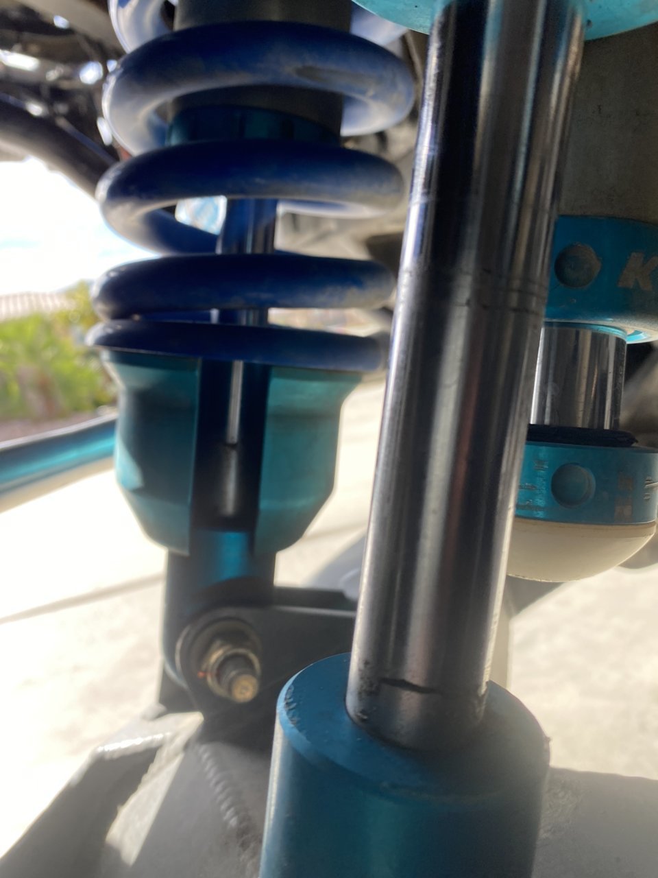

    Just to chime in. I like to think that i'm one of the guys that uses his truck. I beat the shit out of it at least twice a month in either johnson valley or Ocotillo wells. Last week at OW i'd hit some shit pretty hard that gave me "hey look a penny" moment....probably the first time since I put the SUA on almost 4 years ago. The front hit the berm of a dirtroad I was crossing pretty hard (almost the shape of a concrete curb but a bit higher but still made of dirt)...enough that i pulled over to give everthing a quick look see...no issues at all....steering wheel was still straight at the end of the day. All I can say is this would have been possibly day ending if it wasnt for the fact that I have all the JDfab tacoma product on the front of my truck. I also set my bumps very conservative. You can see in the pic that the bypass only gets to about 1/4 inch from bottoming out (im basing this off the oil/dirt line on the shaft)...the coilover is a bit more.

    Careful, you'll be labeled as a fan boy. But I too have had similar experiences where I question how I was able to drive it away. And I attribute it to the JD parts. Hell, I've been driving the truck pretty hard for 2 years now on 37's and haven't had to realign the truck one single time.
