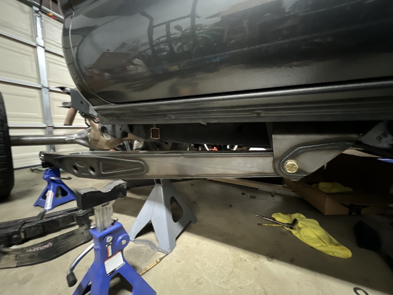

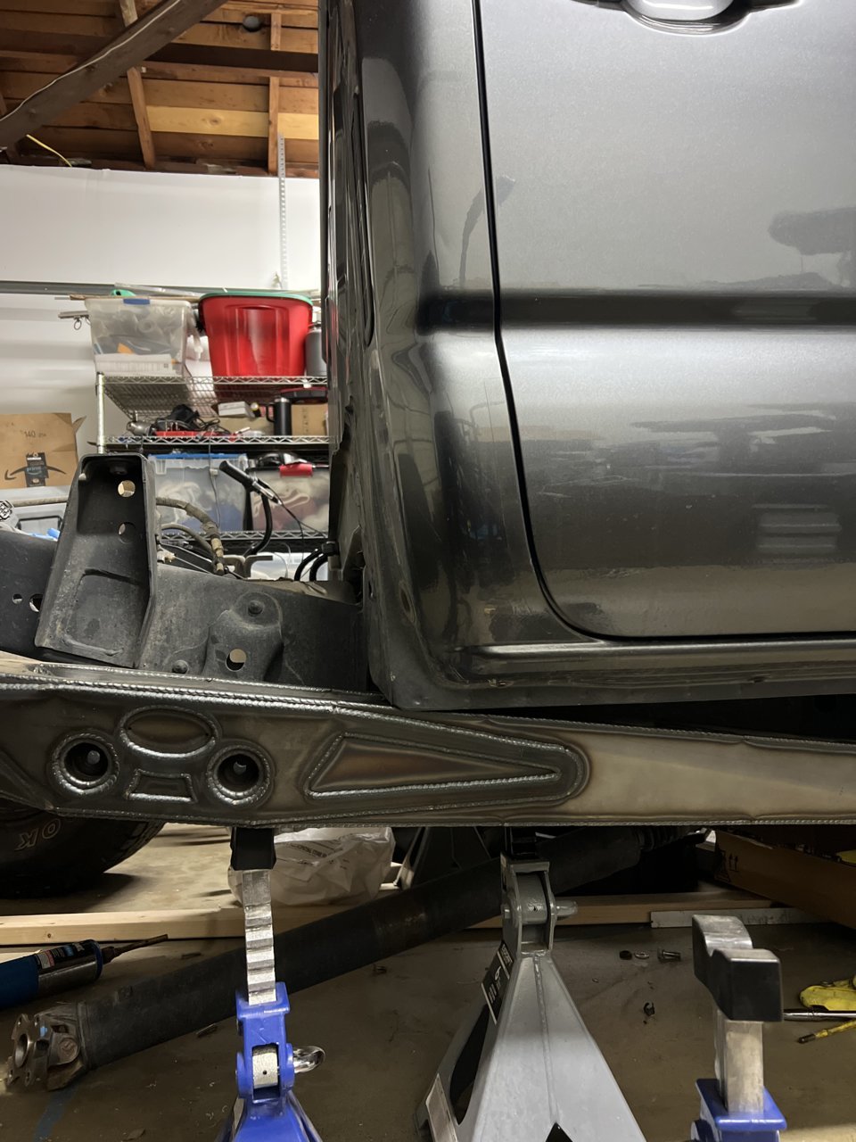

    Little mock up last night, still have to open up some of the existing holes to fit the bolts for full mock up. This is located currently on the intended carrier bearing cross member location. I have to make some room for more up travel.
    This came down to about 135-136” wheel base with the links at their shortest config.
    Who votes I send it 5 inches shorter and really put these coil overs in the cab? Lol

    I know others push them into the cab. But it sure doesn’t look fun when it comes to getting at shocks.

    It would still be longer than a dcsb. Wheelbase 127.4”
    If I move the links forward 5 inches, I’ll likely be at least 130 with the heims at the shortest.
    Yeah if I was doing an access cab I think It would be less of a pain. I’m still hoping to fit 2 seats or a bench back here so it would be tight.
    I might just go with this 142” to 135” for the sake of not having to redo all of the back corner.

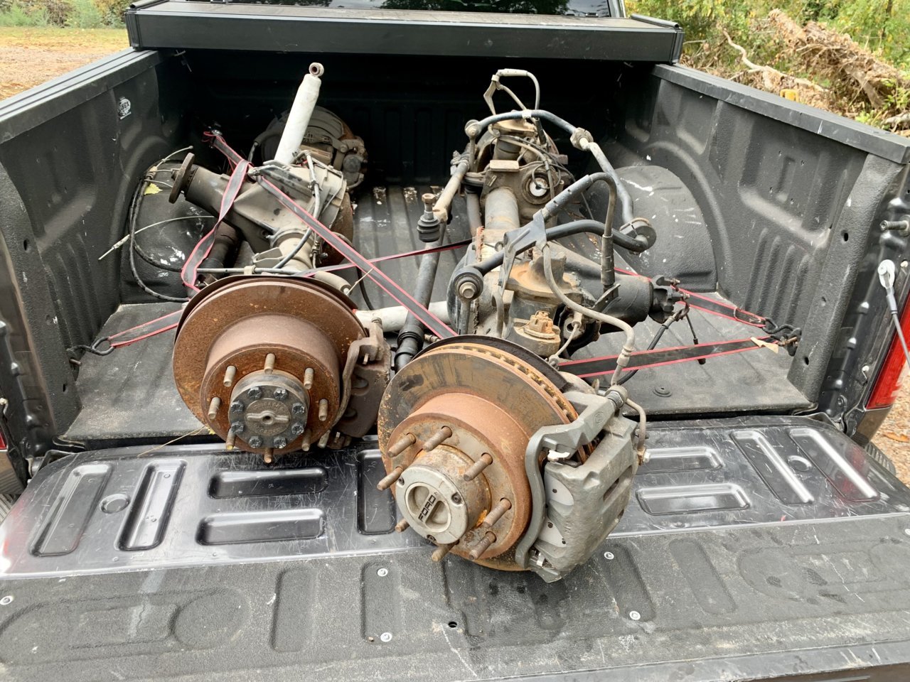

    Axle on the left is missing the steering components
