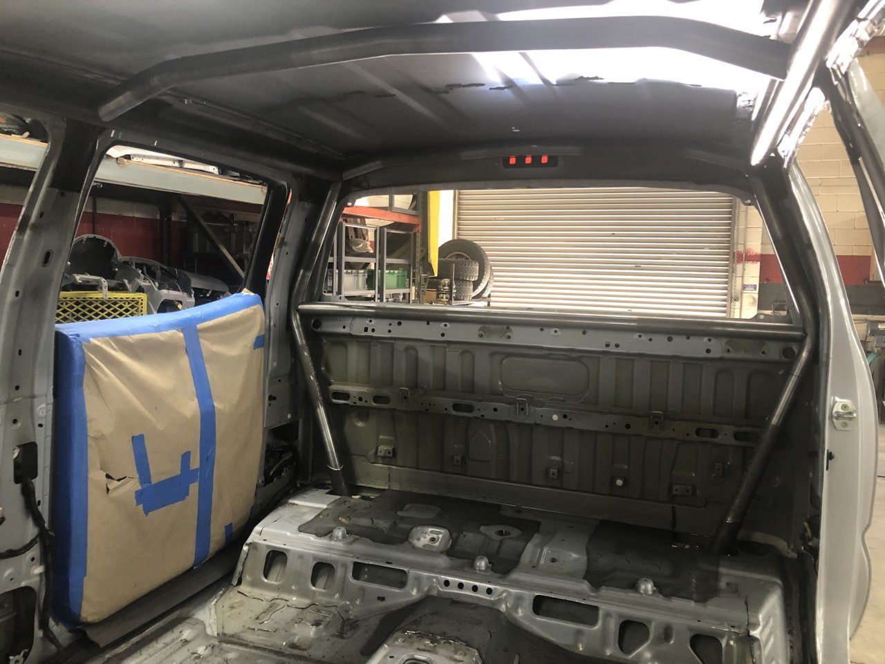

  6. Jul 28, 2020 at 7:57 AM
    #1886

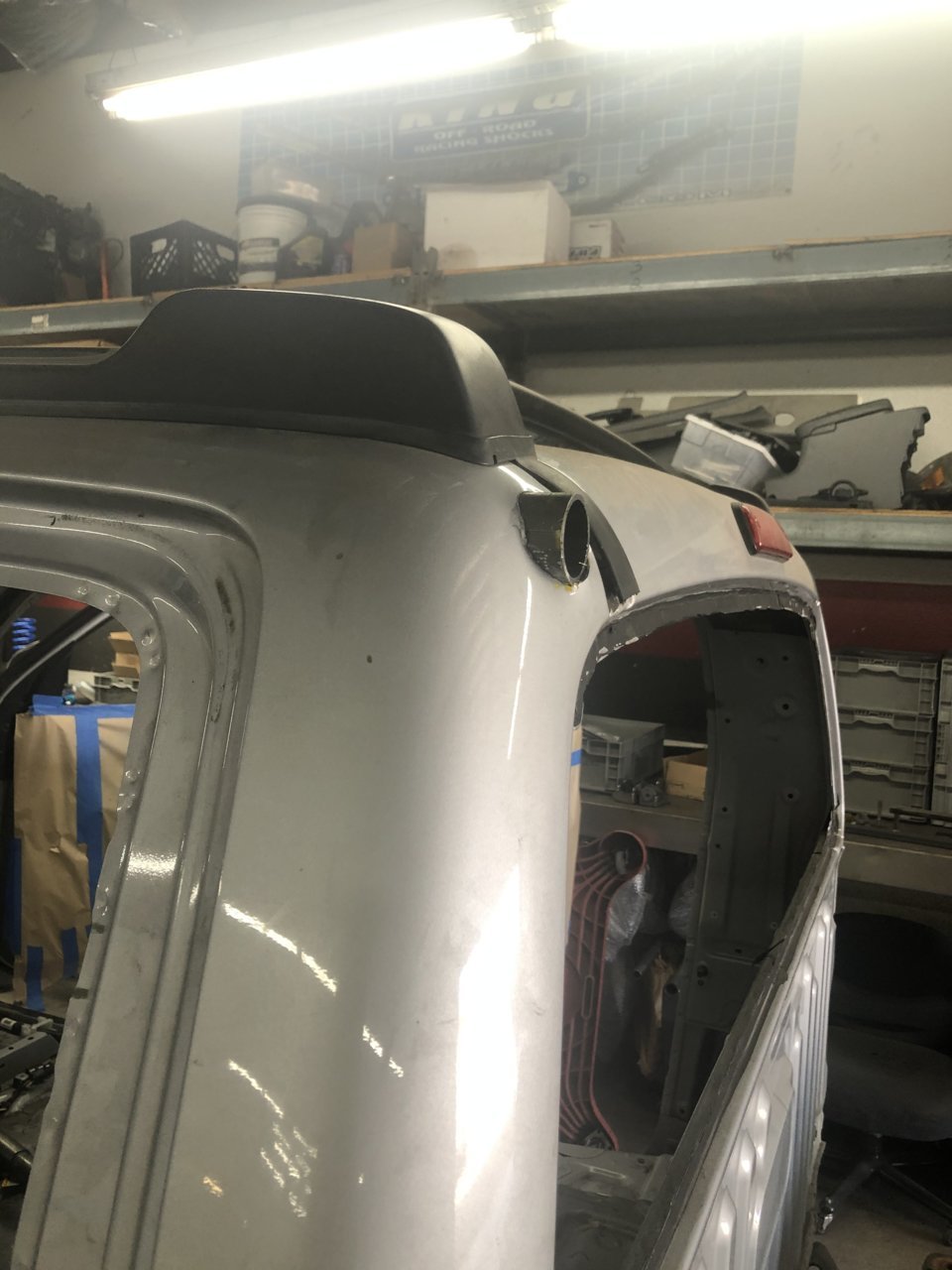

    She’s a tight one!

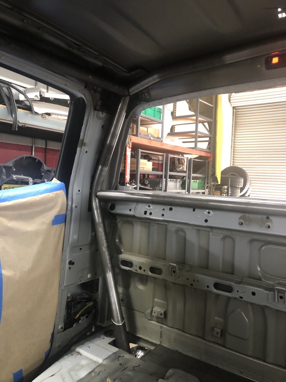

    It’s coming along

  10. Jul 29, 2020 at 4:44 PM
    #1890
    racebug68
    racebug68 Well-Known Member
    Apr 8, 2013
    #101660
    1,232
    Travis
    Chandler, AZ
    05 DCLB 4x4 TRD SPORT SILVER
    I can't leave anything well enough alone

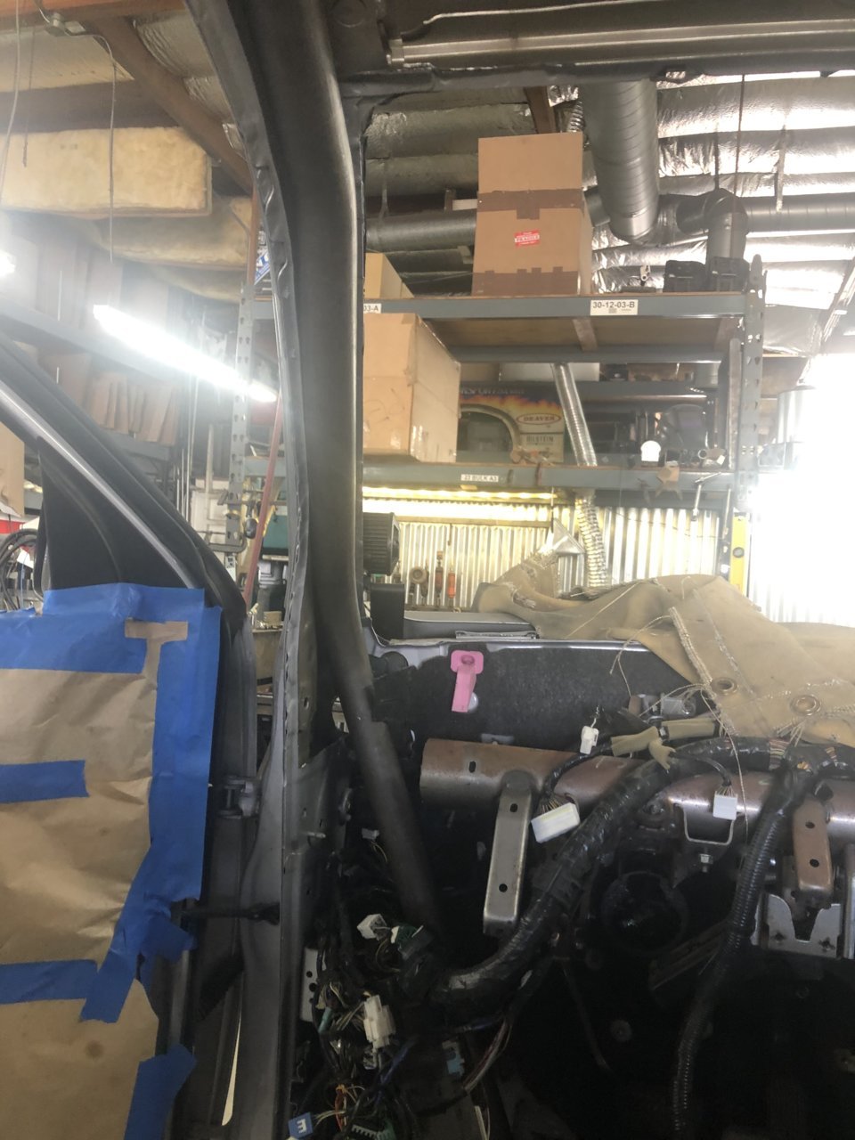

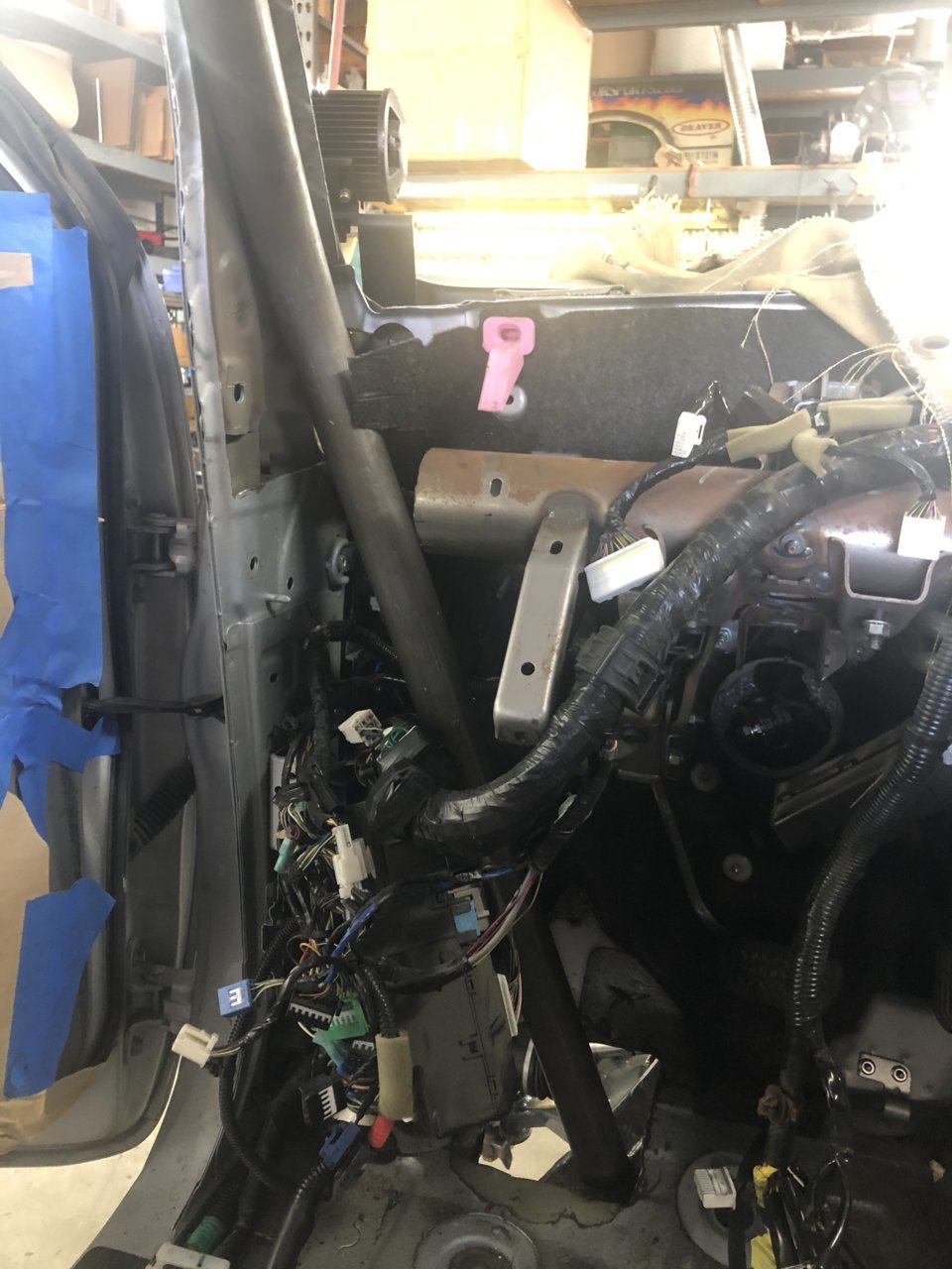

    Will you be solid mounting the cab, or have you already? Knowing how thrashed my cab bushings were when I replaced, and knowing how much the cab flexes with respect to the frame (or other way around), and how tight that cage is, I am thinking there is a high likelihood of movement between the bars and the body. Maybe they will self clearance, maybe the result will be no big deal. but I'd imagine there would be lots of squeaking if there is movement?
    I can hardly believe my eyes on how tight it is, nice work. I don't think anyone has done a cage like this in a tacoma that I know of, so once again you are likely in uncharted territory. crazy.
  11. Jul 29, 2020 at 4:47 PM
    #1891
    snowsk8air2
    snowsk8air2 how hard can it be?
    Sep 16, 2011
    #63607
    10,471
    Flagstaff, AZ
    Supercharged TX Pro
    2011 S/C and basic mods
    He’ll weld the cab to the cage in several spots. Not sure if it’ll be worth swapping the rubber mounts out for solid ones or not after that. I left my poly bushings in when I welded the cab to the cage and haven’t had any additional cab cracking from flex since. At that I only had the usual one spot in the rear corners of the back doors
  12. Jul 29, 2020 at 4:53 PM
    #1892
    racebug68
    Apr 8, 2013
    #101660
    1,232
    Travis
    Chandler, AZ
    Poly would be way better than stock, but even still, all the forces at some places you've welded sheet metal to the cab is not the same as supporting the cab where it was intended. Oh well, I guess it may be a non issue.
  13. Jul 29, 2020 at 5:13 PM
    #1893
    81Trekker
    81Trekker [OP] Well-Known Member
    Aug 25, 2019
    #303299
    3,750
    La Jolla SD
    81 Trekker and 2015 CCSB Tacoma
    Too many to remember
    No point to solid mount with how detailed this cage is. Every single tube hugs the cab and the cab will be tig welded to the cage with silicon bronze filler rod. Once it’s done you could cut all the body mounts off the frame and it wouldn’t matter. Yes I could have taken the time to make solid cab mounts but it wouldn’t do anything other than add more money to the already $40k+ bill for this truck
  14. Jul 29, 2020 at 5:47 PM
    #1894
    racebug68
    Apr 8, 2013
    #101660
    1,232
    Travis
    Chandler, AZ
    awesome. thx for sharing

    awesome fit up, nice and tight!
  17. Jul 29, 2020 at 11:51 PM

  19. Jul 30, 2020 at 7:42 AM
    #1899
    kasnerd
    kasnerd candied bacon
    Jan 2, 2014
    #119695
    2,498
    SoCal Yokel
    '14 SC LT Mall Runner
    Mods? Yes, oh yes..
    Fantastic fab and oh so clever. Epic OCD-level for doing it right, gives ya the warm fuzzies. Wish I had the coin to go all in like this. What an amazing truck. Its a more modern version of the Trekker.
