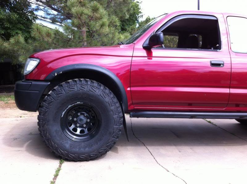

    If I do, they are on the camera at home. When I go back for Christmas I will see if I can upload them.
    I forgot what its called, but i used some of the clear rubber like stuff in a tube, then bondo, then bedliner. I messed up the first side by trying some spray on rubber stuff that never dried, I couldnt get it all off so the bedliner is starting to peel off a bit on that side; the other side is fine. It hasnt started leaking yet so I guess its working :eek:

    Parker so if I'm understanding you correctly you didn't tub and weld but you were able to fit 35s on your truck??? These pictures are going to be awesome!

    Correct. I beat everything back with a sledgehammer. The 1'' body lift helped, I'm not sure if I would have been able to do it without it.
