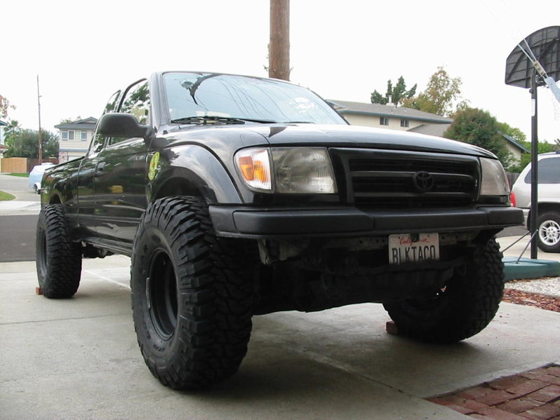

    35's will fit stock :D

    How's the rubbing on that?

    If you don't drive it it will not rub.

    non sense!
    he can move...just...
    not left or right..haha
