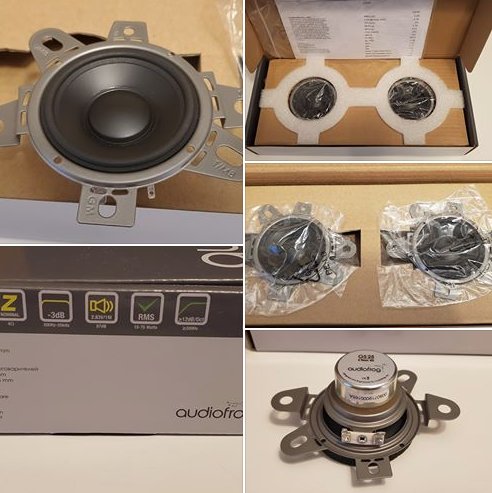

    Yeah, I went ahead and bought them. If I don't like them, I'll sell them. I'm basically going to use them as a large tweeter.

    Found some tweeter adapters with a 2" opening. I'll get those on Thursday as well. I'll need to widen them just a little.

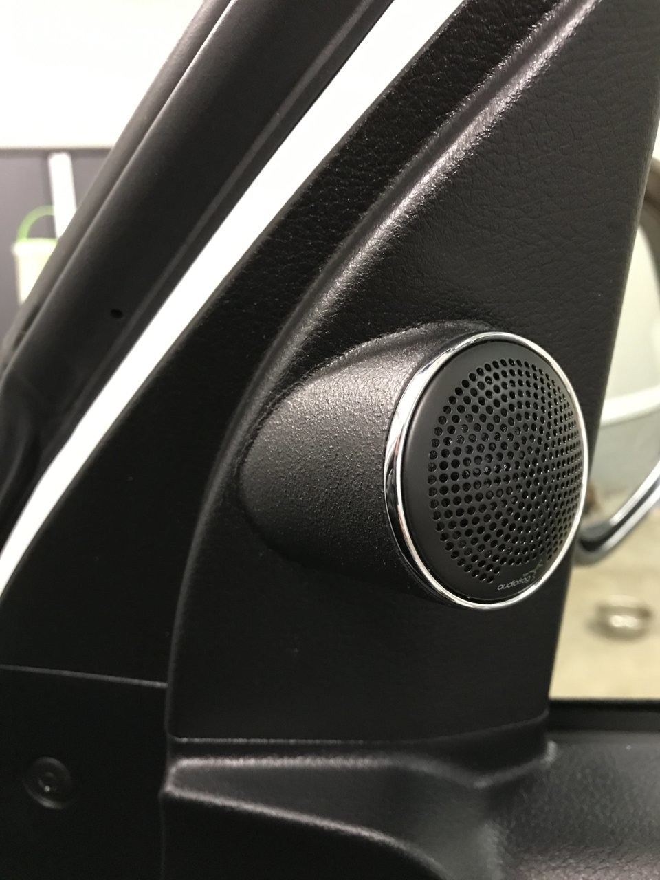

    Audio Frog GB10 and GB25.

    Did you make those pods? Very nice. I'd be in for a set lol
    Also, I must be overthinking the whole adapter thing, yours are perfect and simple looking

    Yes. Wasn't that bad to make it. PVC pipe turned down on a lathe to match the OD/ID of the GB10. Pointed them towards the opposite rear seat belt thing and glued them in.
    I used 18 gauge steel, started with a thin aluminum sheet as a template. Covered in bed liner and that's it.
