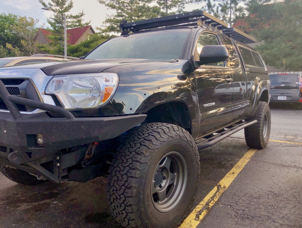

    While wheeling in Moab a week and a half ago I found more rubbing on my flare and fender, which were already trimmed.... so I pulled the flares in a friends driveway, trimmed a little of the fender and wheeled away. So now I’m contemplating a proper 2” fender and flare trim (with my 295/75r16 BFG A/T KO2s on -25mm 16x8 SCS F5s). I am coming around to the no flare idea... What little tabs or plugs or whatever do you have in the flare clip holes? And what did you do about missing fender liners?

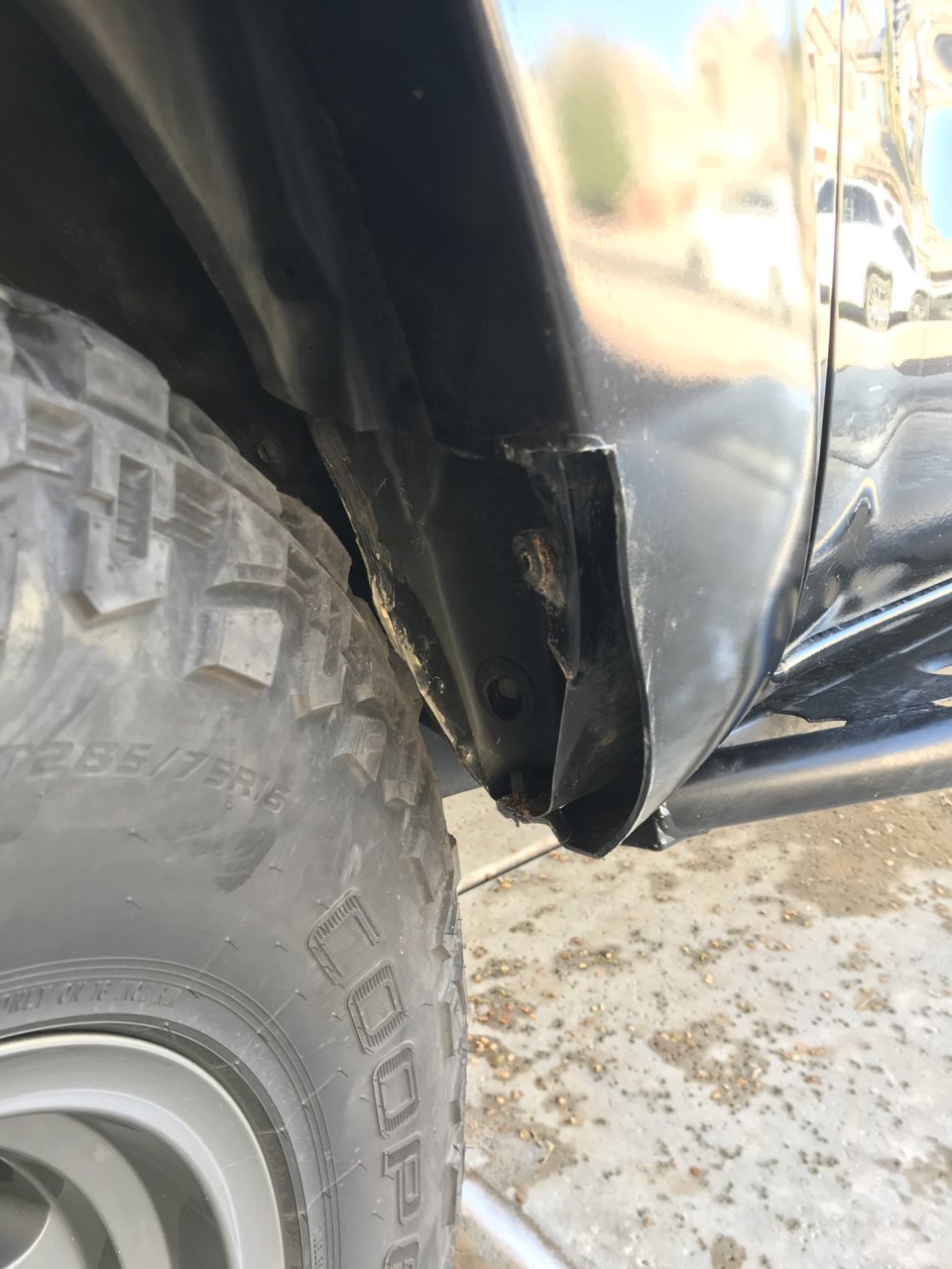

    Just for example. This was the outer fender, inner fender liner, and pinch weld trimming I had to do just to clear 285/75/16’s.

    Likely it’s wheel offset. Just the right offset and maybe there’s minimal rubbing. Or maybe they just drive like little old ladies in town? You see people in TW with 285/75r16 etc that say they have no rubbing. Total bullshit. Likely they don’t wheel or even drive with gusto in town. I trimmed a little and thought great no rubbing with my 295/75r16. Even tried to stuff them. But found rubbing coming into a driveway a little hot at full lock. If you plant to use your truck like a truck, you will have to trim in 285s and up. Just the way it is

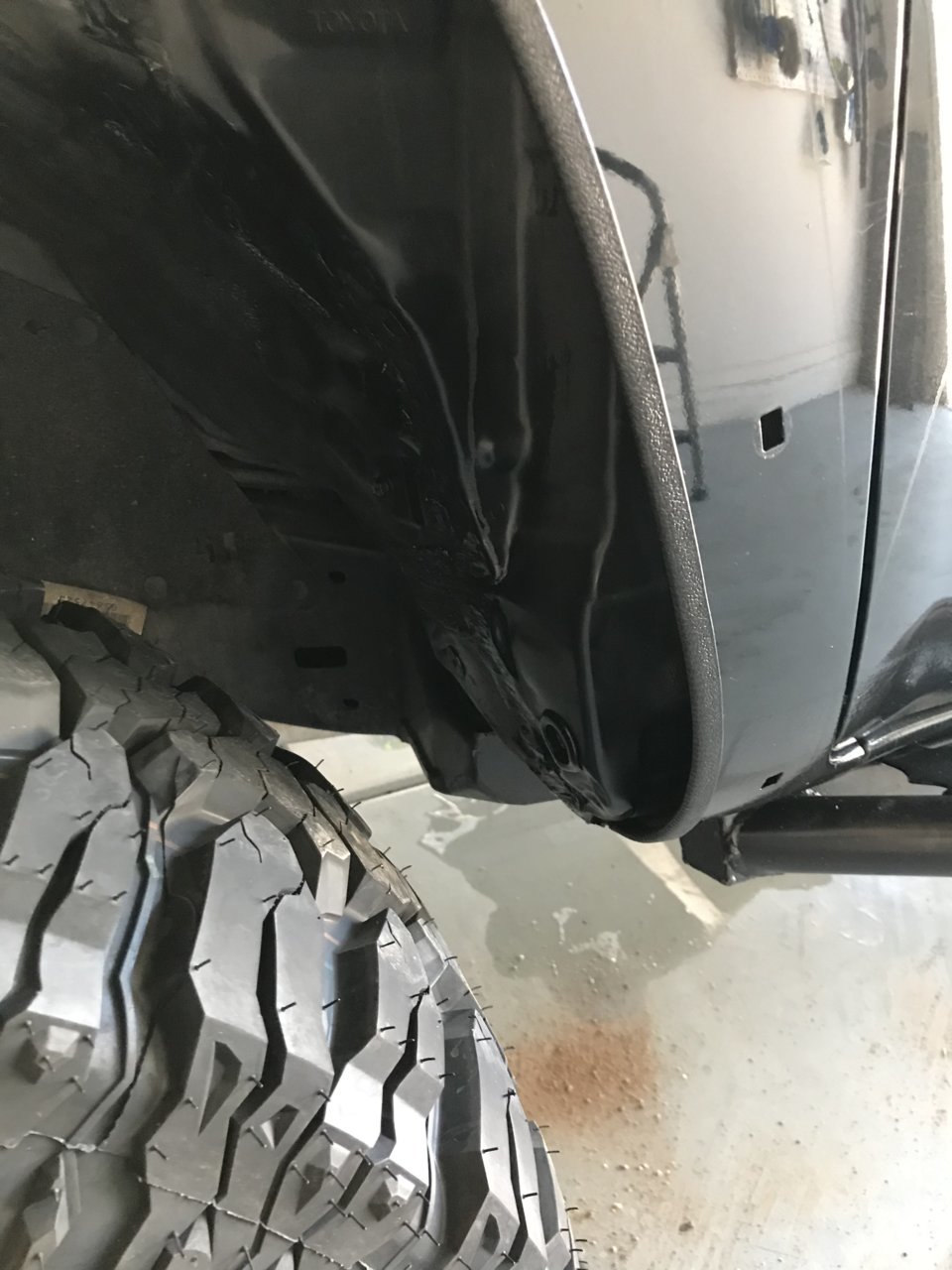

    It will definitely be more for 295s. Full and aggressive hammering of the pinch weld. Aggressive CMC and pretty healthy fender and flare trimming.
    You can see where I found rubbing on already trimmed fenders.
    After all that I found that the fenders were good. I just ditched the flares. But some of the absolute faintest rubbing on the agro CMC and a little rubbing on the smashed pinch weld.
