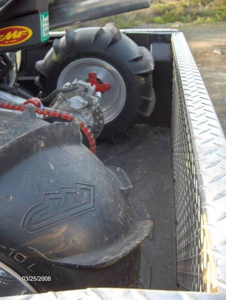

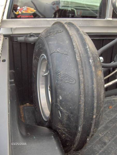

    probably none(tailgate up)..... unless its a little 90 or somthin. down you should be able to put whatever one you want in the back, just tie it in good. My honda 450 fits with about 1 1/2 inches behind the back tires in my access cab std bed. perfect for me cuz the front tires wedge into the front of the bed and it doesnt budge. i'll add a pic next week when i go to the dunes for spring break. right now the quad is still in pieces in my garage and im waiting on DASA to send my head back after porting.......supposedly they shipped it yesterday, we'll see.

    good call bart. the fenders in the double cab short bed go all the way to the front of the bed, so unlike in mine the tires can't roll up and over and wedge themselves in. this is exactly the case with mine- i have some +2" a-arms on the front and it has to roll up and over, but most stockers will fit between the fenders, just a little tight. also, most ATV manufacturers measure the with from the back tires, because the front is a little bit narrower on stock quads so if you measure fender width(on the taco), a quad thats an inch wider in the specs should still probably fit between them.

    That might work depending on how wide they go, my 450 is 48.5" front, and when i roll mine in, one tire always wants to slip off and leave the other one on. when the suspension droops from lifting it up on to it, it gets a little narrower which is why they do this. basically, i'd sum it all up and say that if it's an occasional quad hauler, then the shorty is fine, if you expect to haul it to your ride spot thats 2 hours away every other weekend, then you might want to just go with the long bed. no worries that way.:cool:

    kinda an old thread, but thought i'd still post a pic of how my 450 fits in my Taco for a little extra info:[​IMG]
