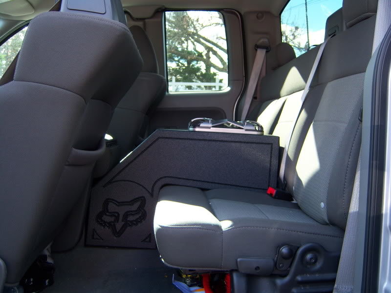

    Here are a few examples of behind the armrest setups that would let you keep the rear seat functional and let you use one of your 12" Kicker subs. A setup like these will probably require you to build the box yourself or have a stereo shop make one for you.
    This one from a 2001-2004 double cab
    This one isn't your model of truck, but gives an idea of the L-shape setup.
    The only two behind the rear seat options I found (I searched a ton over the years) for 1st gen double cabs are the car audio factory box that I mentioned before
    http://caraudiofactory.com/2001-toyota-tacoma-prerunner-p-386.html?osCsid=70itfpkpsocn0ef74g2tn0ku85
    and the supercrewsound dual 8" box
    http://www.supercrewsound.com/04tacomadbldual.html
