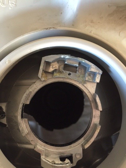

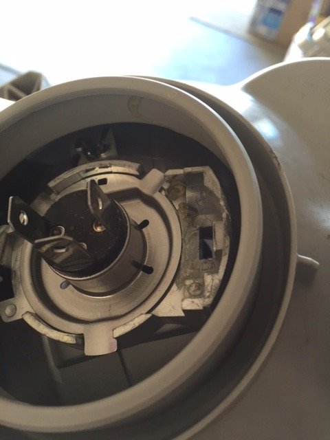

    Bought some used headlights and seller didn't disclose the the back was partially broken and and clip missing.
    how its supposed to look
    how mine looked
    the fix - hopefully it lasts. might ad some jb weld to the screw.

    You're screwed. That material is fibrous and a extremely hard to bond to with the heat cycling of the housing.

    Hey @unlewser, how is that clip fix holding up. I just broke mine and this fix seems like the perfect solution. Thanks

    @lococacho
    Sorry I missed this post, but it’s held up to this day. So almost 2 years and some bumpy terrain. No issues.

    lasted another year and continues

    I noticed the retaining clip was missing on my passenger side when I changed bulbs, so ordered a new one. Broke off that damn clip myself trying to get the retainer back in there. What a PITA and POS lol... Thanks for posting this fix and the pictures were helpful. I'll have to do the same thing. Although the bulb holds pretty well/level without it.

    Update for anyone from the future: was a PITA drilling out the hole for the screw. Had to remove washer fluid and the air intake to to get the drill at the right angle. And yes that material is super fibrous and could break easy. Be gentle. Drilled my pilot hole and went 2 sizes up to for my screw. My suggestion? Use the smallest screw you can find. If you f this up it's either deal with it or buy a new headlight. Finally got my screw in there and realized my fuckin retaining clip I just bought was gone lmao!! Pretty dang sure I left it between the bulb and dust boot. No idea where it went.. So then had to vaccum out all the crap that fell into the headlight. Didn't get it all out so just blew some compressed air in there. Then just tucked the bulb in front of the screw. It almost didn't fit into place because the screw was bigger. But it's holding there now, tighter than without the retaining clip, but looser than if it was in there.
    Put the boot back on, plugged er in, replaced intake and washer container, checked the cut off and light output on a wall/quick drive, and there ya go. Oh and don't forget all the curse words when all the bullshit happens xD

    OP here, that screw is still going strong. I never even went back and added JB weld.

    another 2 years and still going strong.
