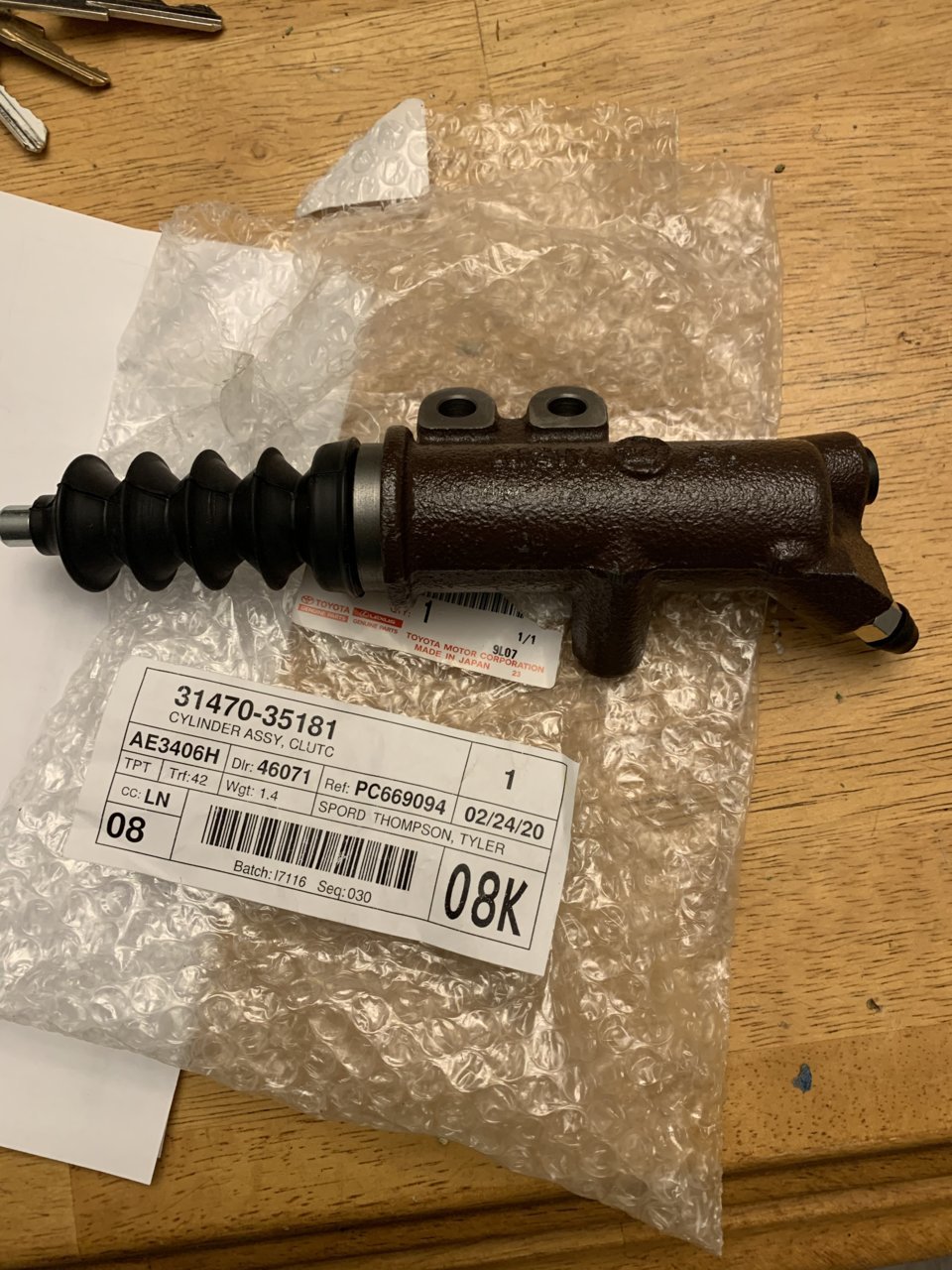

    So it won’t let me post any videos don’t know what I need to do to get it attached, but here is a picture of the new updated slave looks exact same as old but it’s painted brown and part number ending in 81 instead of 80 new one definitely had more tension. After i installed new updated slave the clutch fork was pushed more towards clutch without pedal depressed, and bearing I guess seemed to have more preload although bearing still wobbled more then I would like and made very very little noise which is less than is was before the slave. Hope this lasts a while seems good so far. I post videos when I figure out how to.

    It was an expensive fail. Waste of time, it’s now chirping as I release the clutch pedal. I got a tougher spring like the one from the ford master cylinder because I couldn’t find that one. No difference. I’m stumped. Just gonnna roll with the chirp for now. Keep in mind bearing it’s just two months old if even
