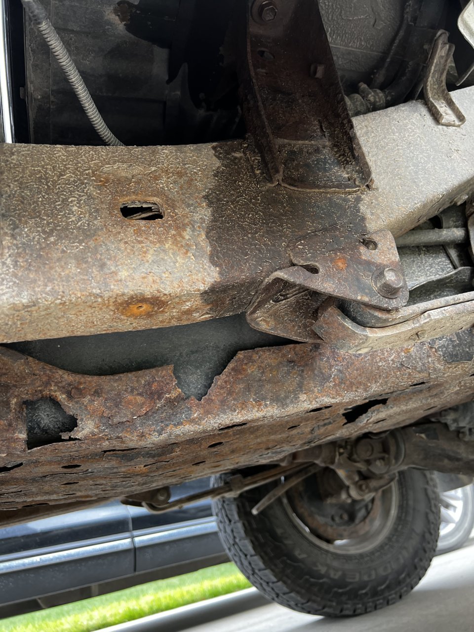

    I think I'm in over my head. 2003 with 189,650 with all service at dealer and we're the second owner. I knew it was rusty and we planned on refinishing the frame thinking there were no major issues. Found a hole inside the frame next to the gas tank. Do I continue or sell it for someone else to tackle? I have a new muffler and gas skid plate along with two cases of POR15 ready for what we "planned" on doing this week but that stupid hole just pumped the brakes on it! Thoughts? Just did $2,500 in timing belt, 4WD service, rear bearing, ebrake, water pump... thinking we'd go the long haul. Should I sell or try and fix? Oh, and we can't get the bed bolts out SMH.

    I'll get pics loaded but it is between the gas tank and frame, so tight fit. Still trying to get bed bolts out to get a better view. Impact wrench, air and cordless, soaked with WD40, heat, cold, I've never had a bolt not come loose after the things we put them through. They aren't reversed threaded are they? LOL.

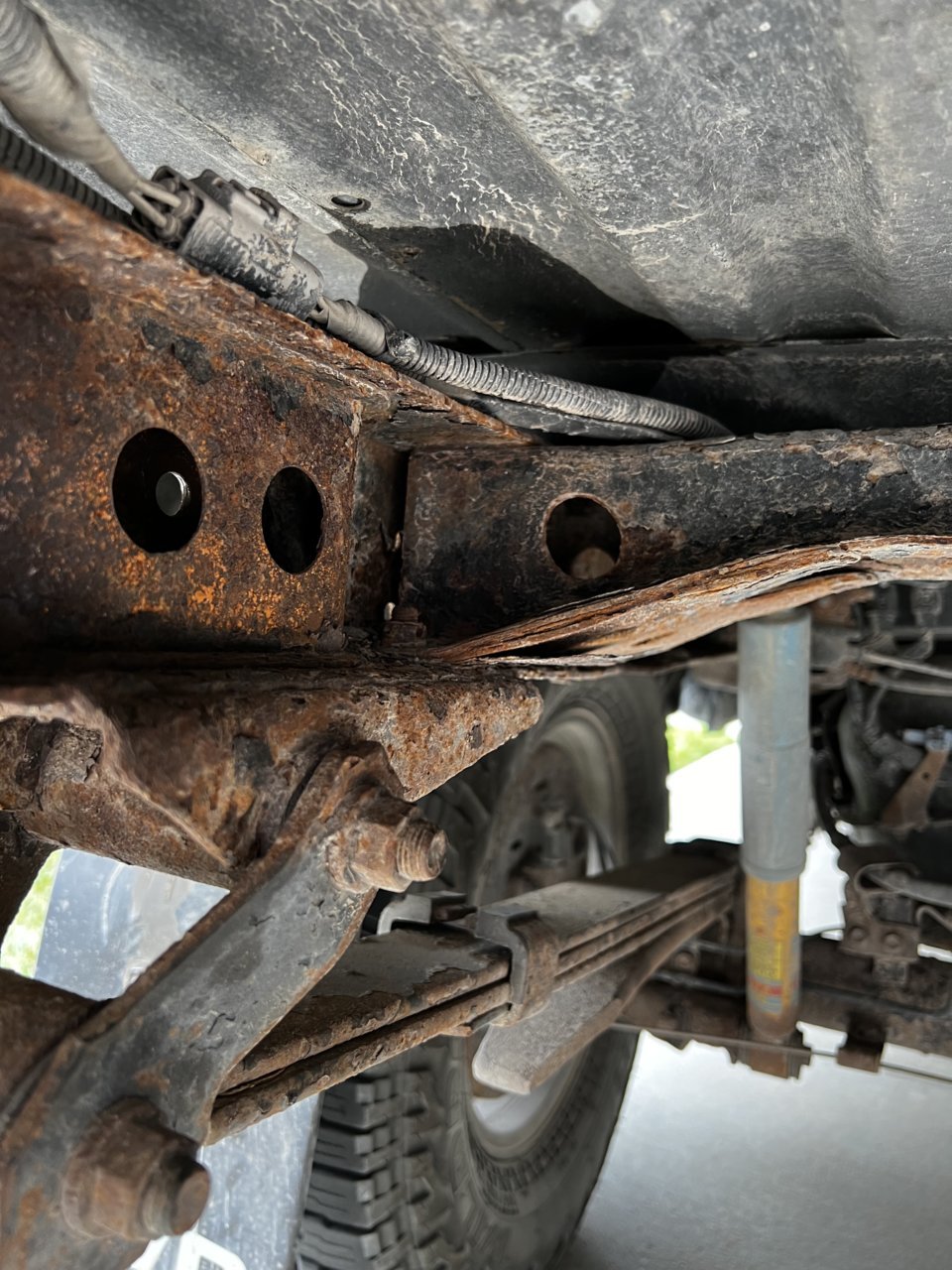

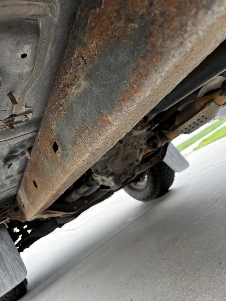

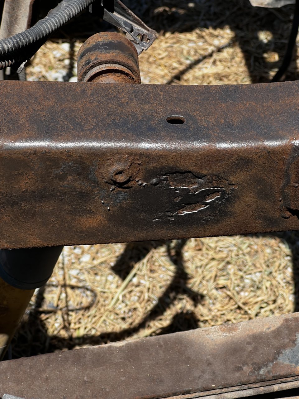

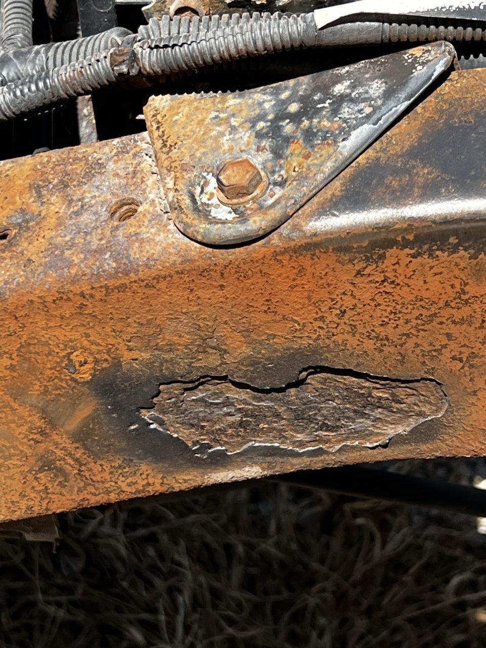

    Driver's side rear shackle

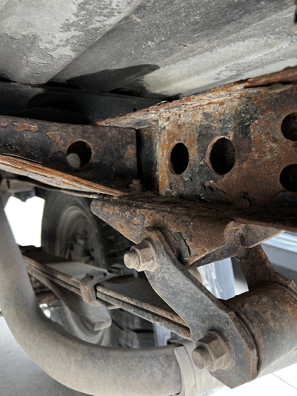

    Pass side rear shackle

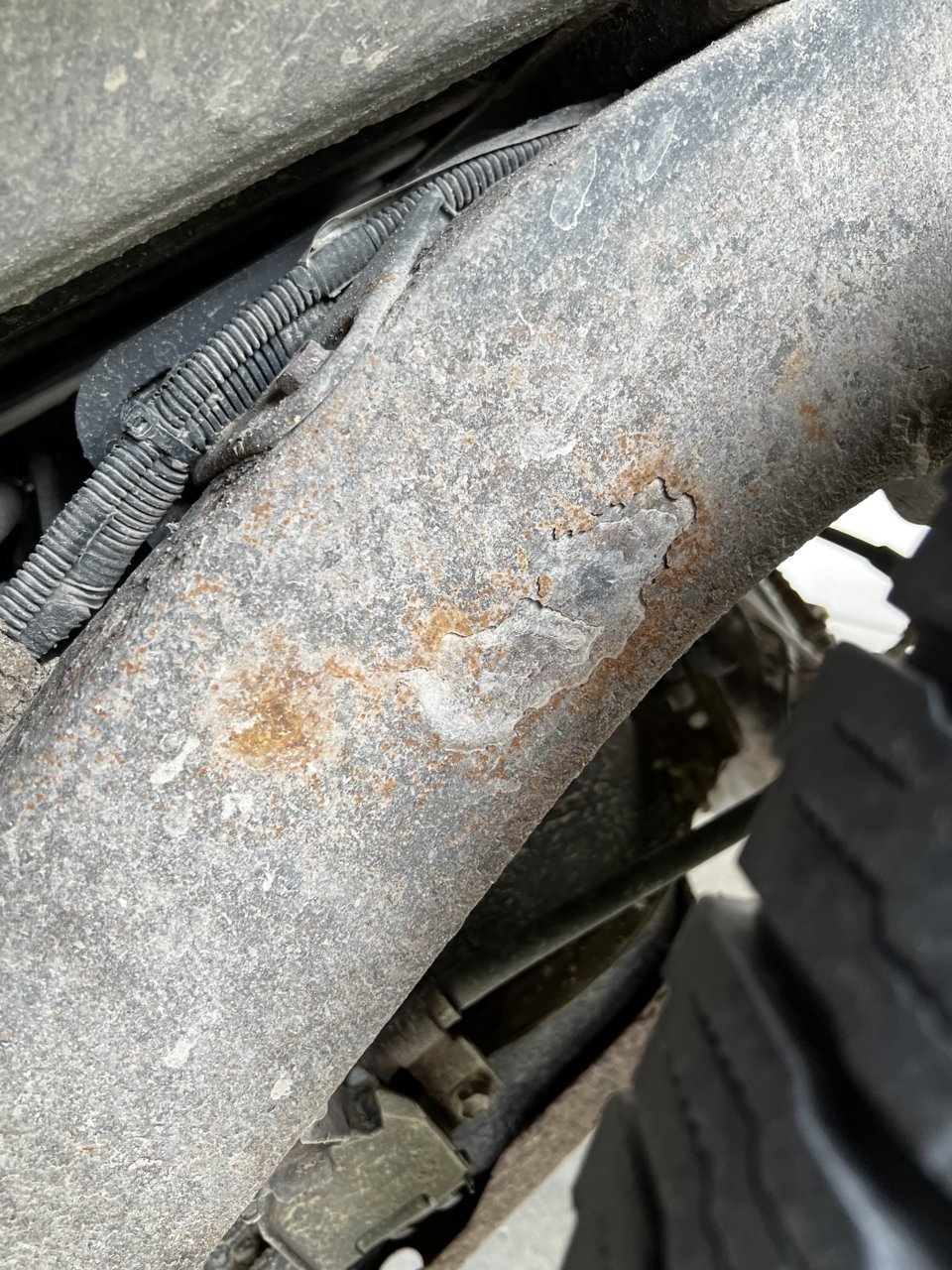

    Driver's wheel arch - seems thin

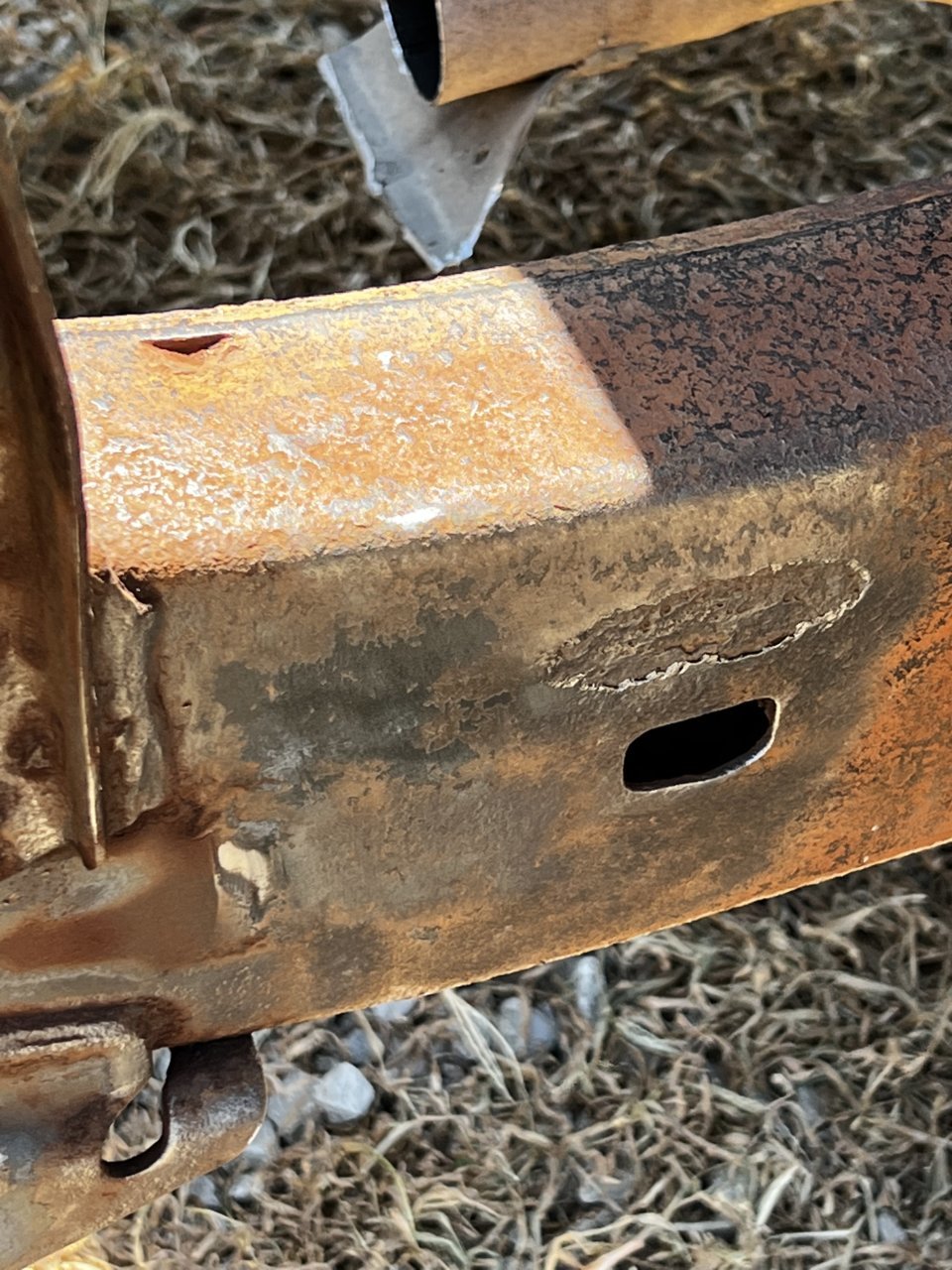

    Driver's side outside frame looking forward

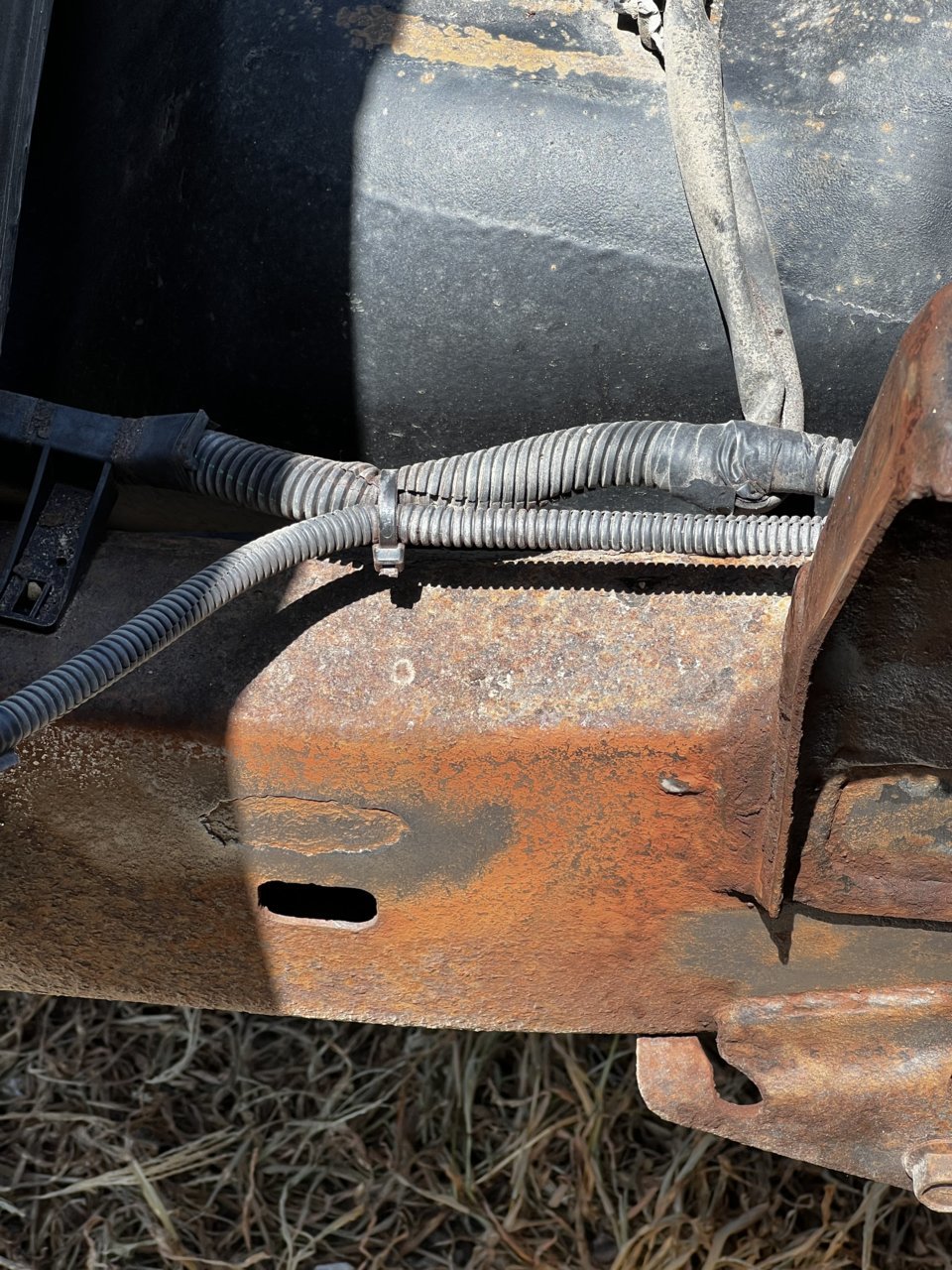

    Outside of where the hole is (on the inside between the gas tank). Yes, I have a gas tank skid plate replacement.
    Best I could get of the hole. That is where my fingers pushed through.

    Get after that now!! From the pictures you should be able to save things.
    Go do the hammer test of the whole frame see what your really dealing with.
    It comes down to you or a friend being able to do the work or spending a possible $3000.00 or more depending just how bad things are to have it done.
    Sell it as is with new tires I paid $400.00 for one I drove home.
    Good luck!
    Burn the bolts off and be done!

    If it was me I'd pull the box off,sand blast what can be done . Then get the frame pieces (safety cap I believe) and start welding. Truck will be down for a while but you should end up with a solid truck. Good luck

    Not anymore. Way past the time frame Toyota was replacing or buying back trucks with rusted out frames. Safety Caps and a good welder will fix it right up. After it's repaired, Paint the frame and spray some Eastwood Internal Frame coating inside the boxed portions.

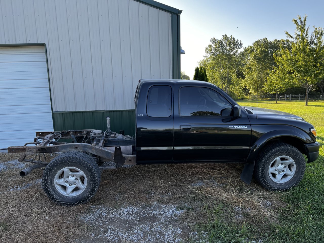

    Pulled the bed, cut out old muffler (3.4 sounds pretty dang good straight-piped lol but we are replacing), and the gas tank skip plate literally fell off after removing front two bolts. We'll drop the tank this weekend, cleaned up most of the frame and found no other holes, just delaminations. Ordered all three rear sections, for both sides, sets of Safe T Caps that'll be here tomorrow. Right now delaminations in four spots, which all four areas will get a cap. Was going to replace rear springs for the sake of "new" but they're stupid expensive now so we'll clean them up like everything else. POR 15 clean, prep, and paint by next week, hopefully. There is a lot of welding to do first... I'll post pics.
